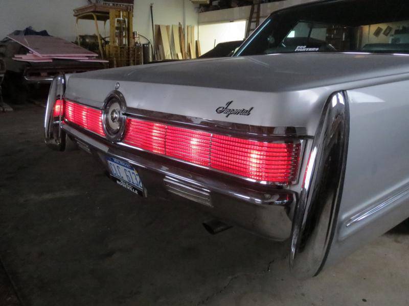

Shemarr sm107 is 68 with marker lamps, mopar sells a red one to replace the white one much tougher they are hard to come by but can be found for 200 bucks, I have installed a sheer mar for 115 bucks or so, but the plastic it's,s made of distorts due to the heat from the contacts, dur to the whole lighting running through the switch it needs to be made of adorable resin or the heat from new bulbs will distort it and you will be replacing it again. I have though of running led replacement bulbs and using an electronic flasher, about 80 bucks out the door , to replace the system. LEDs will require less amperage thus less strain on switch, in theory, the electronic flasher will compensate for the lack of amperage and increase voltage.
Plus they will be brighter lamps
A close friend of mine is a flucking surgeon when it comes to these things and can rebuild the '68 units after they fail. He rebuilt my '67 before we had any '68 cores but it didn't last. We now have a '68 ready as a spare and the goods to rebuild another '68 on hand. What is the part number for this one that is supposed to work for our Imp tilt/tele's?
I know they could be brighter but I can't imagine looking to make them brighter, what a beautiful set!
