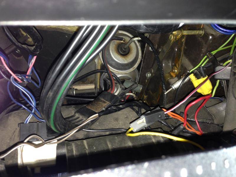

Finally had time to look around up there, and found a plastic connector with a metal terminal end sticking out (sans wire). It’s the red wire with white stripe in the attached photo. This is taken through the radio hole in the dash.
I think this is the radio power feeder, as it’s on the same fuse as the signals (per the owner’s manual). The terminal had signs of arcing on the end.
So...I think this one is solved!
