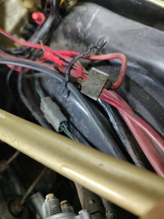

Here is picture of red wire from battery and where headlights are patched in, does not look like a fusible link to me. I did not find any thing else that looked like a fuse link.
I don't have a '69 Chrysler FSM and I know there were significant changes in '70, so I don't want to use that to check the wiring diagram.
That splice isn't stock, but I think you know that. It does make me wonder what else is going on.
