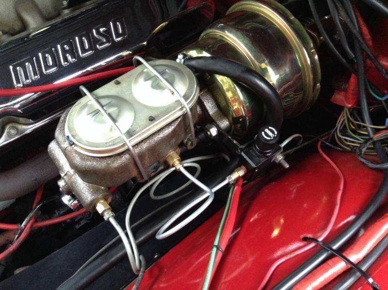

Turned out pretty good..
OK, dumb brake line question time. Why are the lines coming out of the MC curled? What purpose does it serve?

All I wanted to know was which bender he used. I've used many and I have never been 100% satisfied with my work.

Stan wasn't trying to get you upset brother. Was just poking fun. I have done it that way once and just couldn't get it right. Imperial makes some really nice long handled benders that work great but they certainly are not the cheapest. If you are doing 3/16 brake line I bought a set of brake line plyers from the snap on guy I believe they were blue point that work probably the best out of anything I have used for brake lines. Its a little tougher doing stainless.
I have a co-worker here that uses nothing but stainless.
He claims he only has to do a single flare & not the normal double flare that steel lines require..
That is true to most cases but you have to be very careful as it will spit on you easier than steel will.
I am currently doing this work myself on the 300, I like the "bending" tool you are using. I have the hand bender and it takes a bit of practice. Personally, I would never go with a single flare. The double is easy enough with the right tool. A friend of mine uses the nickel-copper lines which are easier to bend, but I feel better using steel. It's the new fittings that never seem to work right, so I've been cleaning up and re-using the old ones.
I have a question. Are you using a PV for the rear brakes? Nice job on the bends!! I use food cans! That's how I did mine.

your bends are very smooth too:eusa_clap:

Where did you get the PV for the front brakes? I'm still running the factory one in my 68 and I think that isn't allowing full pressure to my discs. I converted all 4. Brakes work but not very powerful.
