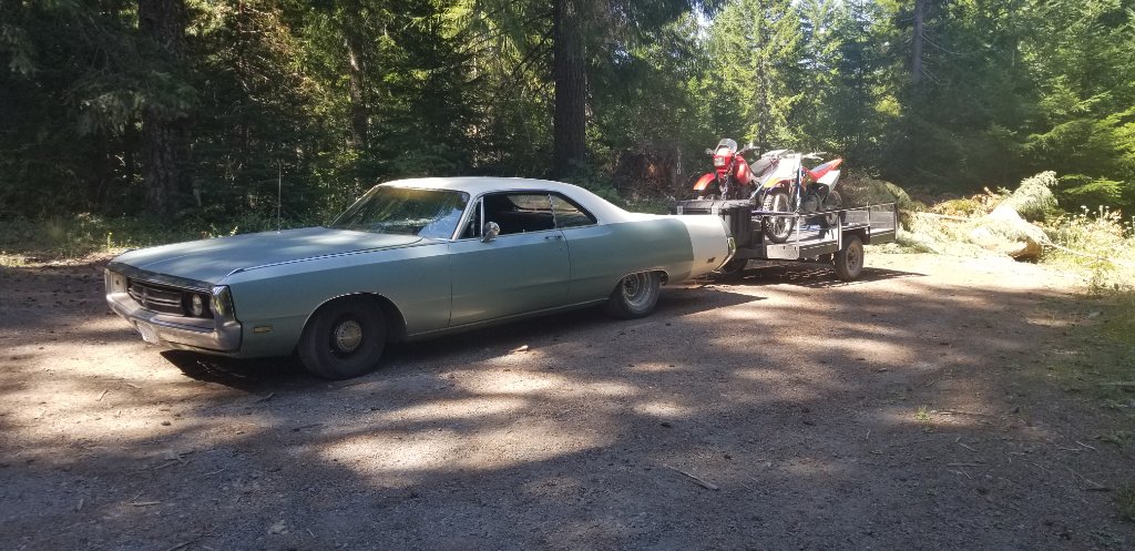

I used to haul my drag car on a trailer with my C-bodies. Started with my '70 SFGT and then went to a '73 NYB. 3500 lb car with a 1500 lb trailer. Used the weight distributing hitch and no sway control. Never had a problem and I used it about every weekend.
That said...
Having said this, remember the age of our cars and be honest about the integrity of the frame, body and mechanical systems.
My C-bodies weren't 50+ years old at the time. Even nice cars have issues from age.
