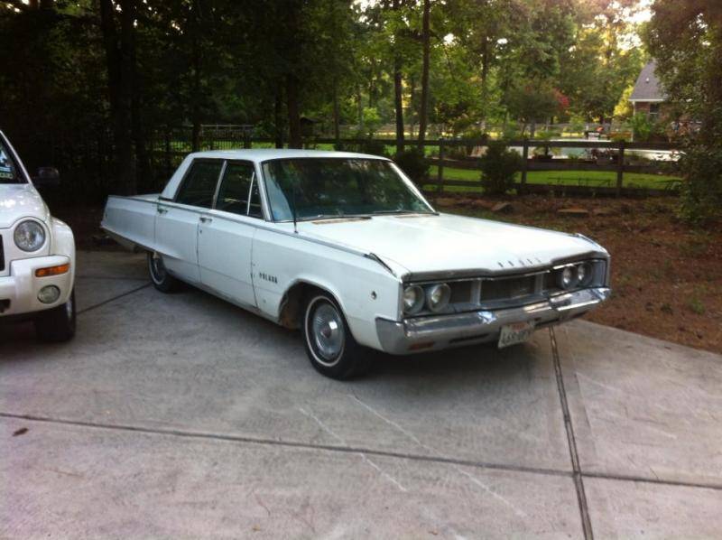

welcome to the site from the Motor City! Lets see some pics of the Polara.
Here's a quick pic. Can anybody tell me where the proper place is for putting jack stands under this thing?
:sSig_thanks:
the frame rails and the rear axle tubes should be fine depending on what you are doing

Front : On the frame in the area inboard at the rear of the front fender (by pentastar emblem). At the rear: the rearend housing just inboard of the springs .Should be good and solid at these points.
