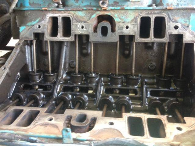

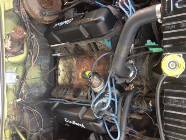

So I got the Old intake and carb off my 383 . do I need to replace that nasty Insulation that was under the intake?
Just ordered the new valleypan.
:yaayy:
I didn't put one in when I installed the eddie manifold.
You can make your own very easily, and on the cheap. Few pieces of aluminum foil, and some basic home fiberglass wall insulation. I've built a few over the years this way and never had a problem.
Edelbrock makes a heat shield carb spacer (eddie 9266) to prevent percolation of the carb for extreme underhood heat problems. The installation directions also references removing the 2732 eddie plate (that I was talking about when installing an eddie carb to an eddie manifold in a previous thread). Adds minimal height but still should have adequate hood clearance.
