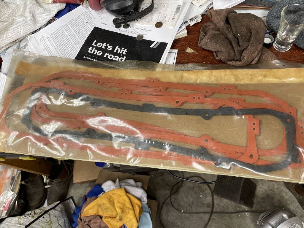

I was going through my parts inventory for valve cover gaskets, found plenty. I have this package of red rubber gaskets. I have had them many years and I think there is a reason I haven't used them. Are these valve cover gaskets any good? Any of you old guys remember? I can't?

Moroso blue failed on start up. Might be good with aluminum heads and valve covers.
Factory red silicone slipping out of place on install, didn't use. Might try again. Try without FormAgasket.
