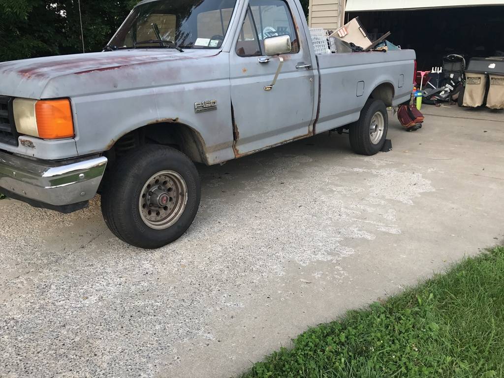

Of course... You could just do a Rustoleum paint job in the driveway like we did with my son's truck. This was a scuff, mask and shoot type job, but it was pretty presentable. We used a Harbor Freight spray gun and thinned the paint with acetone. If I did it over, I'd use mineral spirits. This one was done in an afternoon, but if you took some time, you could do a real nice job for not much money.
In fact, there was a whole bunch of guys doing rustoleum paint with a roller... wet sanding between coats... and coming out with really nice paint jobs.
