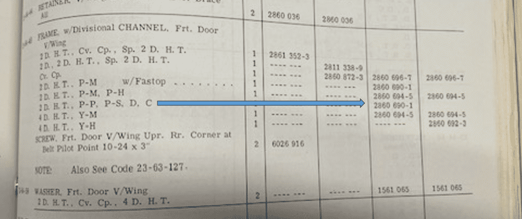

Hi,
I am looking for replacement vent windows for my 1968 Chrysler 2 Door fast top. By parts book – it looks like the part should be 2860696 - 7
The part number on the castings 2860705 LH (Drivers) 2860704 RH (Pass), I can’t seem to find this number in parts catalog.
I realize a casting number – is not an assembly part number

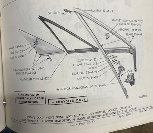

When looking for a used part – is there a logical way to insure correct part?
Is the vent window assembly interchangeable between, 2drs 4drs, and convertibles?
Thanks for your insight.
Kevin
The vent windows are fastop only as they are shorter than those used on sedans, hardtops and convertibles.
