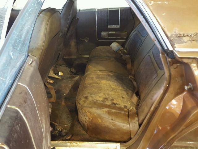

I suspect most would have thought it a parts car prior to the flood. The thing that I am curious about, is I do not see evidence of a water line in the interior... there should be a clear water line and mud on the floor mat if the seats were flood damage.
If the seats got to soak up an above ground septic tank mix... they would be trash. But they look more like a lot of sitting dirt that got damp. I would bet the Copart folks slap the flood/biohazard label on stuff just to CYA after the Katrina cars publicity.
BTW I still have a few Katrina cars at work... we got a couple truck loads, most of which had to scraped. A few were parted to repair the survivors, but too much variety to part much. The ones kept were not as bad as you might think. 2 I know of were in Key West and the salt water was enough to hydrolock the engine, but the vehicle would fool you even if on a lift. The worst one I had to replace the steering rack a couple of years ago... it had corroded the aluminum housing. The bolts still wrenched free without serious drama.
The stinky ones were not considered for use.
Note the runner type floor mat condition, and the dirty door panels without a line.
