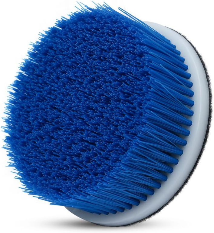

One thing I found to help clean it up was a rotary brush like this one in my orbital polisher, but it can be done by hand too. Just clean until you think it's good, then do it once or twice more.

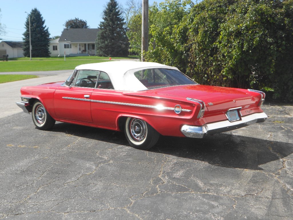

When I purchased my 1962 Chrysler 300 Sport Convertible there was some spots like you describe that no matter what I tried, I could not get them clean to my satisfaction. I read that using a good quality "White" liquid shoe polish would work. I purchased I think 6-8 bottles of Kiwi brand. Shake good and mix two at a time together. Make sure the roof is clean and dry. Don't apply in the sun and it needs to be at least 70 degrees. Apply with a wide foam brush in even strokes all in the same direction. Let dry a day and reapply in the opposite direction. The two will blend nicely. It has been eight years and my roof still looks great. The product does not come off.
