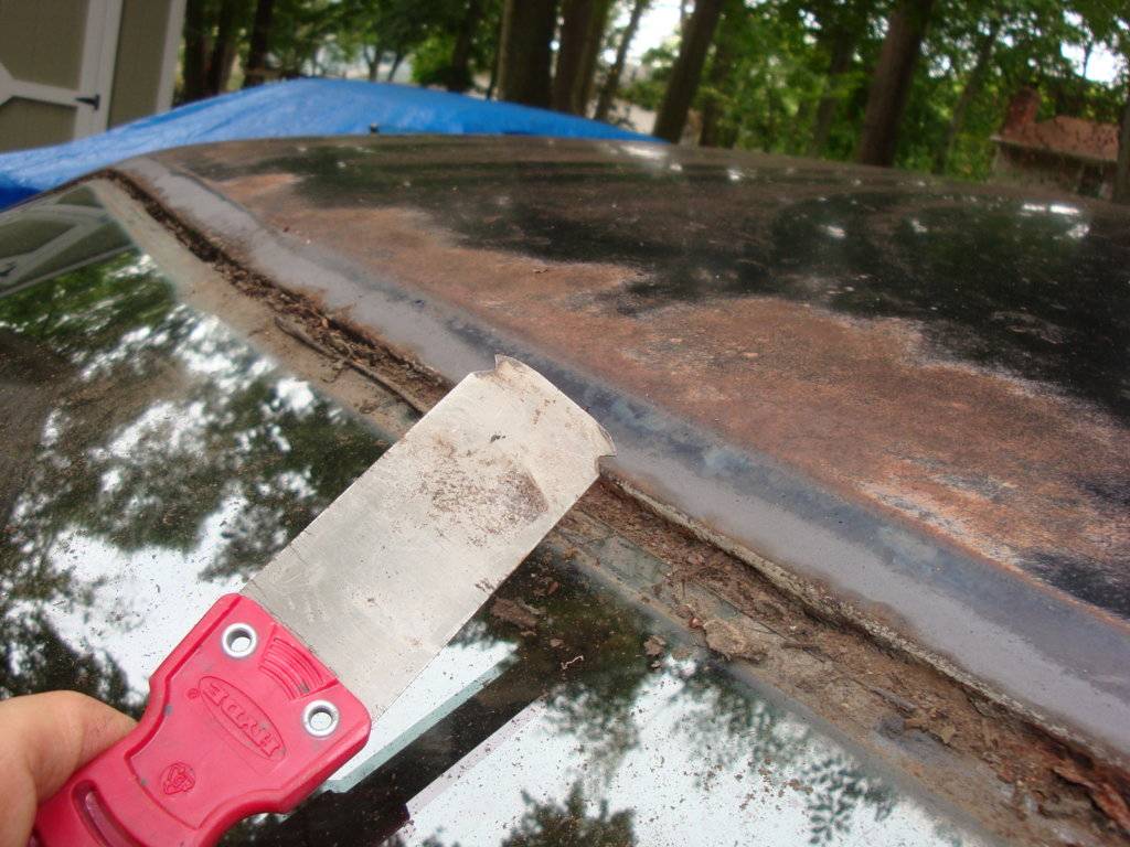

You could make your own. I did this one with an old scraper and a metal file.
Thanks for all the input. Have you been successful at removing the trim without bending it?

I used the can opener method, but ended up putting some dents in places :/ with the pointy end when I was prying around, so be careful.
