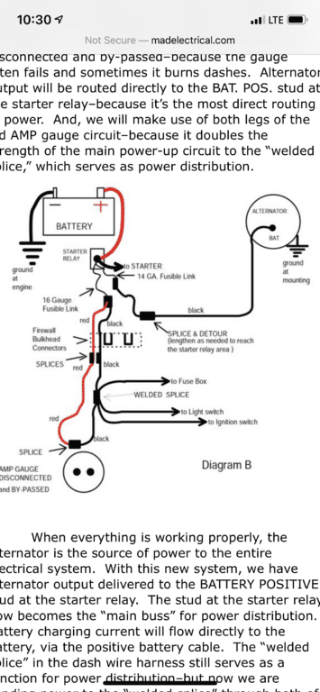

Hello I’m coming into this conversation late. I had a question along the same lines. I by passed my ammeter and followed the diagram I posted below. I also switched out the single wire Vreg to a 2 wire Vreg and a 100amp powermaster alternator. Everything seems to run fine except when I have the headlights on, all lights seem to be pulsating quickly. They only do it when accelerating. I’m not sure what I messed up, or did I get a bad Vreg out of the box?
