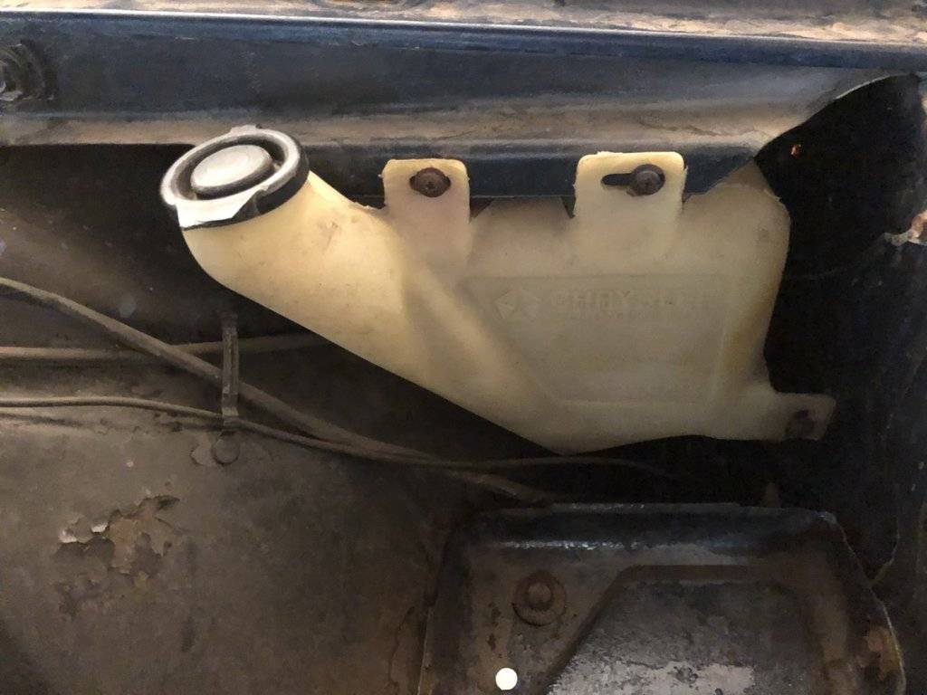

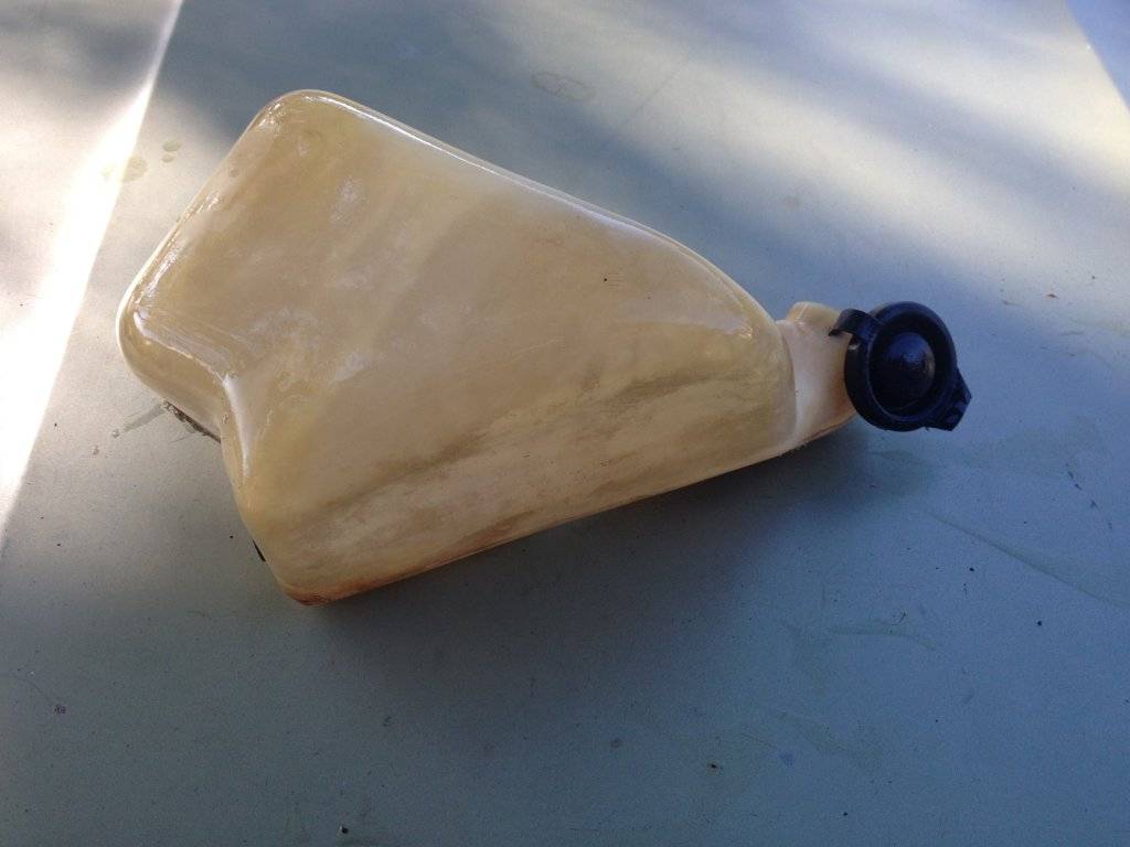

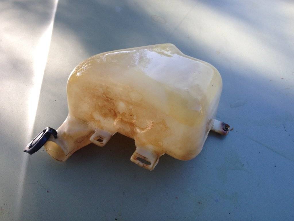

Are either reproduced? Mine is an obviously incorrect one that the PO wire-tied to the fender brace
Is the pump supposed to be attached to the bottom like that, otherwise where does it go?

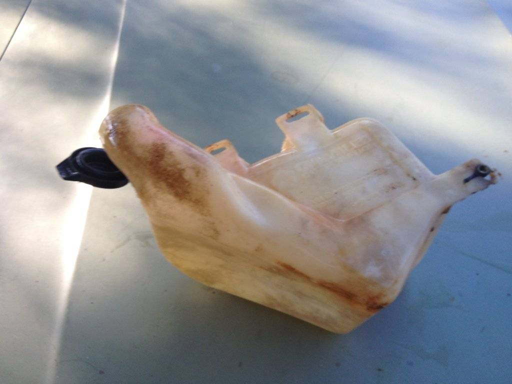

This is what a 69 bottle should look like. It goes behind the battery in the fender. It is not reproduced and is 1969 only.

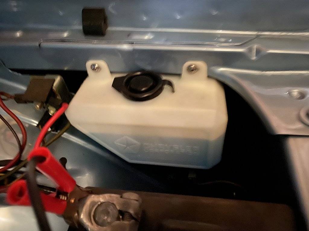

So it is correct the way the pump is attached to the bottom of the tank? At first I thought mine was Jerry rigged and it was supposed to be on the firewall next to the wiper motor
I can take my existing pump and attach it to the repro 67-68 bottle?

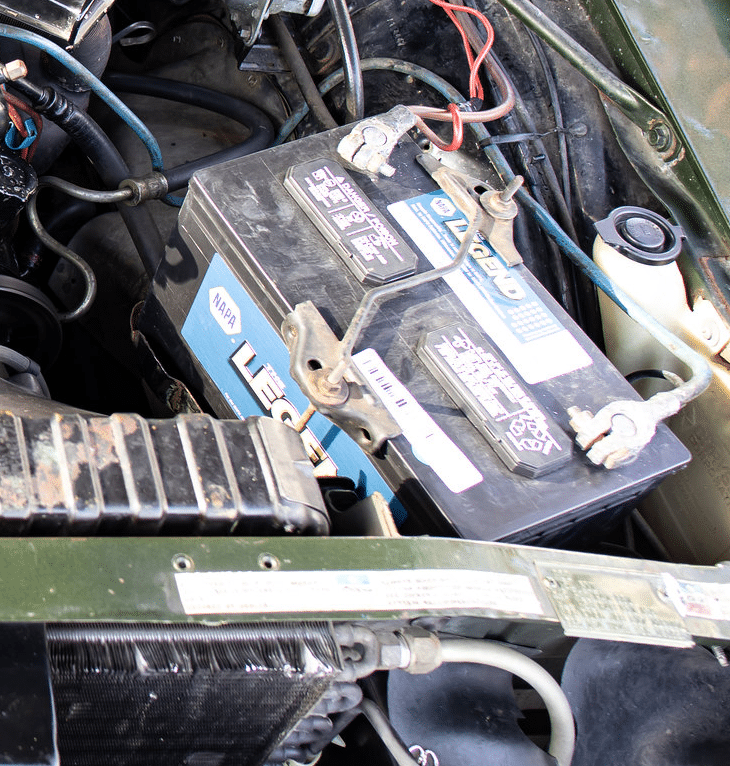

Yes on both. Photo attached of my ‘68 Fury’s washer reservoir.
No, the pump is attached underneath the reservoir. That is the starter relay next to the reservoir.

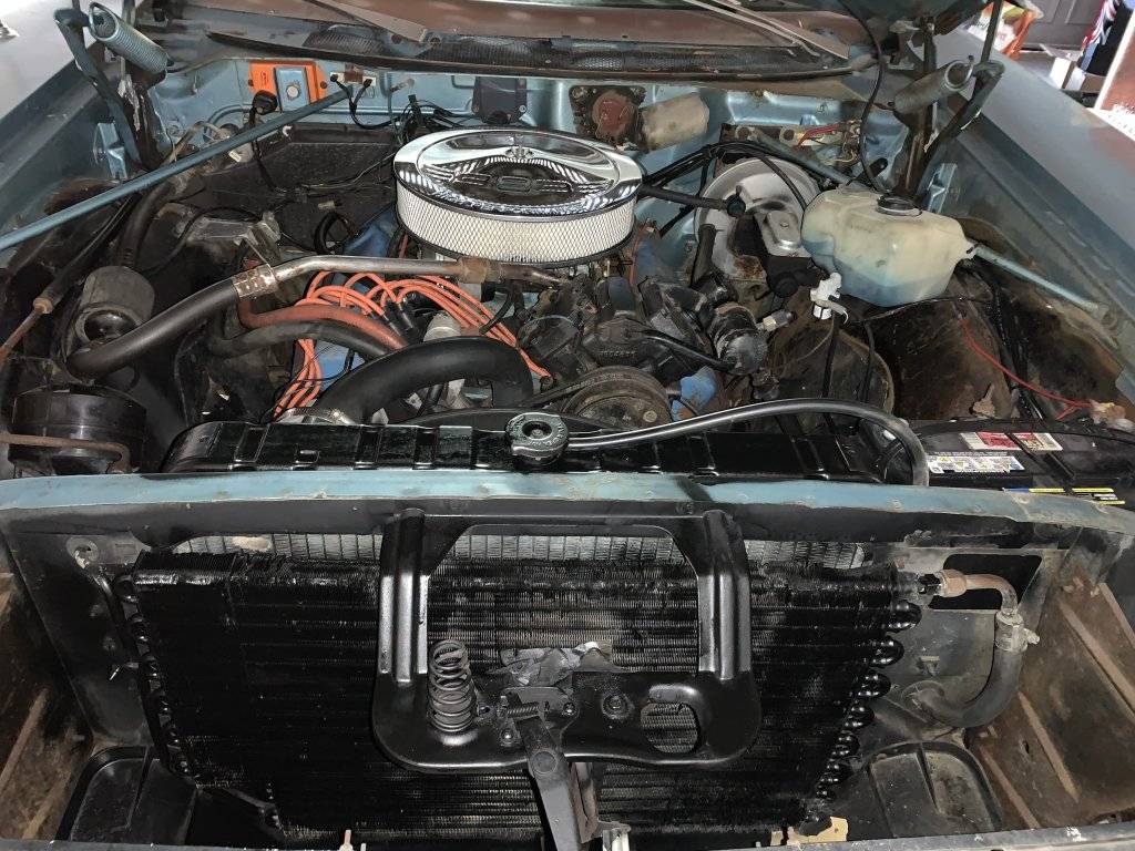

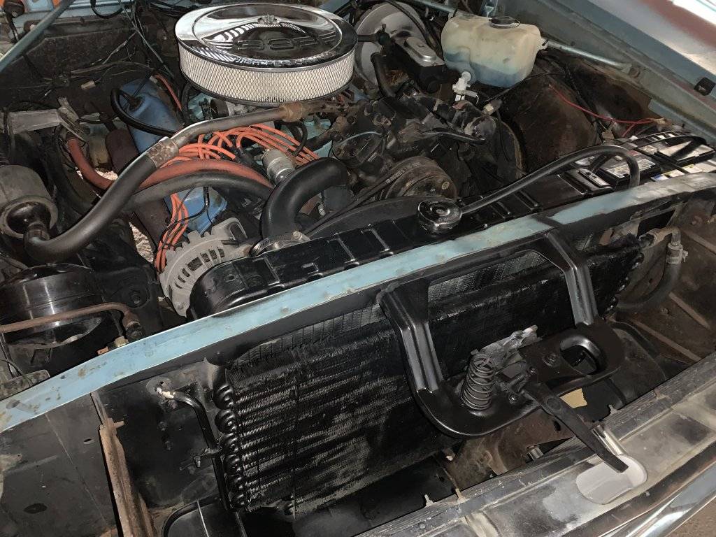

I wonder if the pump I have would work on that bottle, I'm not sure what my car has in it now. Anyone know, judging by the pic?
