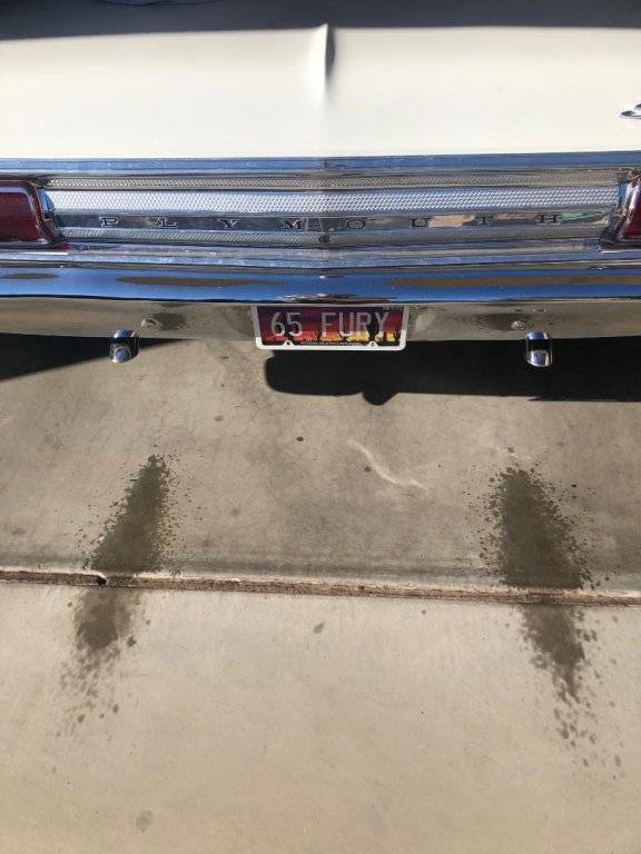

Attached is a picture I took this morning after starting and running for 2-3 minutes and it died out on two occasions. Has to be a "bad gas" issue and a fill from a bad tank at the gas station within the last three weeks. Running overpriced premium. Concluding it has to be a tank of bad gas given it is water, temperatures outside are 79-80 degrees and most importantly; both tailpipes. Has a new AFB carburetor and new fuel pump! Thanks for comment.

Thanks. See picture and comment below. Has to be water in the gas. No other explanation of further pondering and conditions.
that's not your problem. did you check your gas filter it might tell you what's going on. after it stalls pull a plug to see if it is dry or wet.
Well, what do you know. That looks exactly like what my car does, every day.
