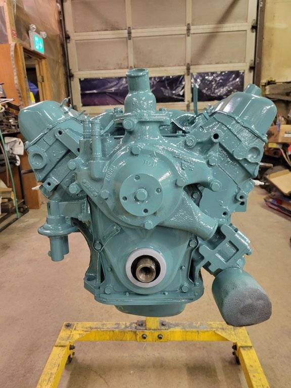

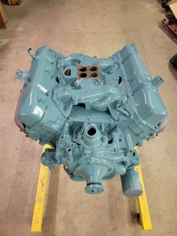

It is a 68 and temp sending unit on the left. This is also an a/c car so I dont know how much differance this wiil make either.
Here's a 66 vs 67 up
I've got a couple of them sitting in the barn I'll never use . Both are LH , but I can get some numbers off of them if interested
Ordered a used, cleaned, prepped one off ebay. Needs painting to preference. Fair price, plus shipping. Has same casting number as mine. Still need t/stat housing next. Thanks for y'alls help!!
