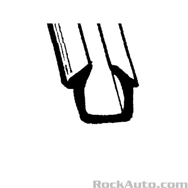

I have bought alot of weatherstripping and seals from Rock Auto in the universal section under body. You just need to know the profile of what you need. They usualy sell it by the foot and it is very reasonable also.
Body & Lamp Assembly Weatherstrip Parts | RockAuto
To me, the observed issue with GM-spec weatherstrips is that they had a seemingly thick skin, but little underneath. Plus how the weatherstrip and glass interfaced could be different.
Using the online catalogs to get the correct style and measurement in roll goods might work, if you can bond the center section to the end pieces successfully. Those "joints" in the OEM weatherstrips usually are more of a block of rubber, for reinforcement, than what is in the intermediate areas.
