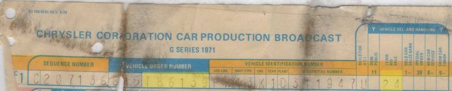

Interesting.....a T-VON. I have and know very little about these letter von's. Learning. @69CoronetRT can you help inform me about the T.
Cool car @BE_Fury . Looks to be in really good shape!
Often found with Y24 Leasing.
So a build sheet is required to figure out if this is a Y24 leased car?
No. I think T code cars are usually/typically/mostly lease cars but I want to reserve some wiggle room in case another use pops up. ;)
It's pretty safe to say a T VON = a lease car unless that car's BS shows otherwise.

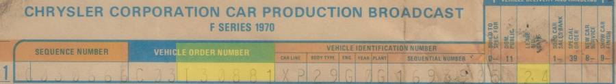

Here's one from '71
Again, anther reason to save broadcast sheets, window stickers, tags et al from cars when they are parted out. More info is always better.

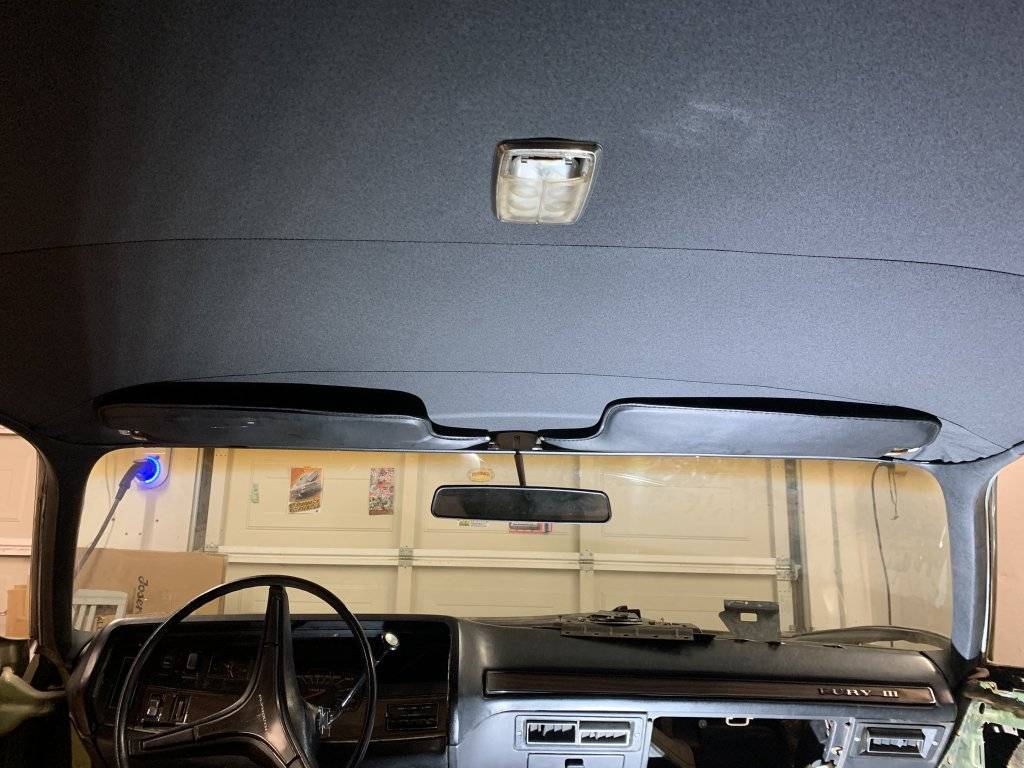

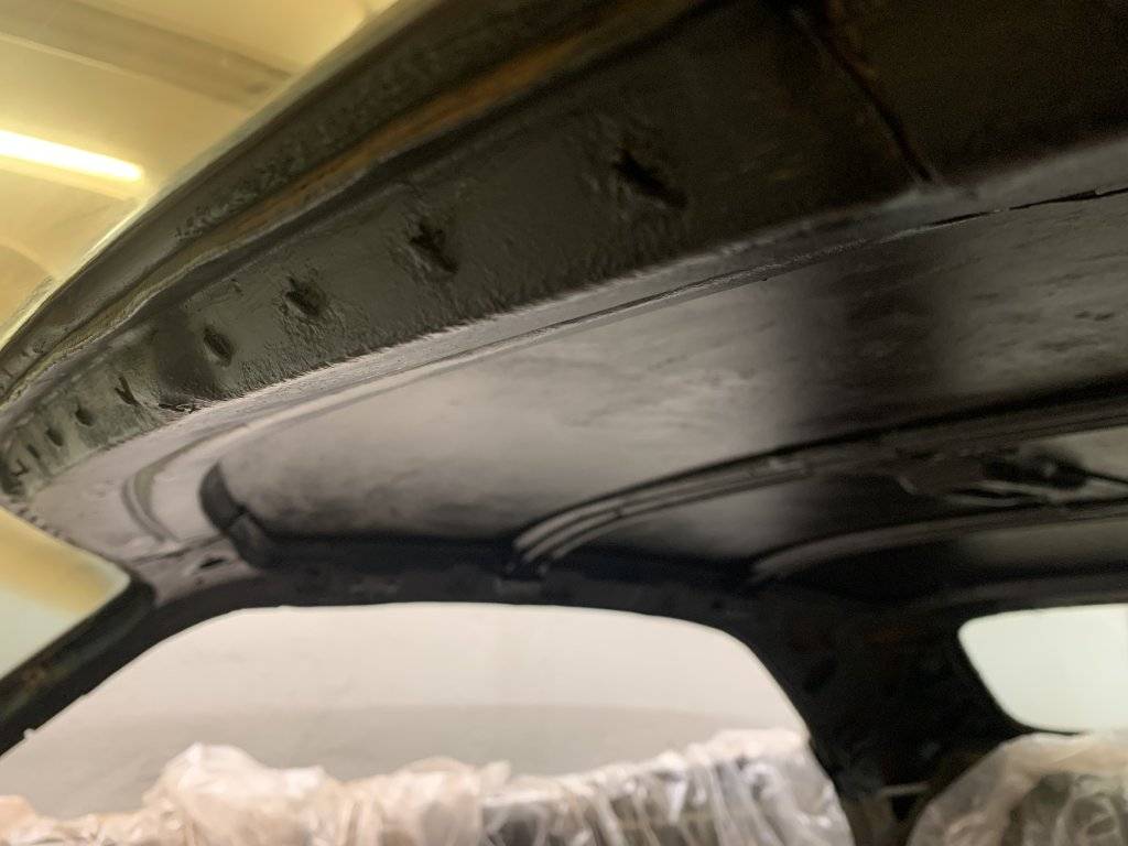

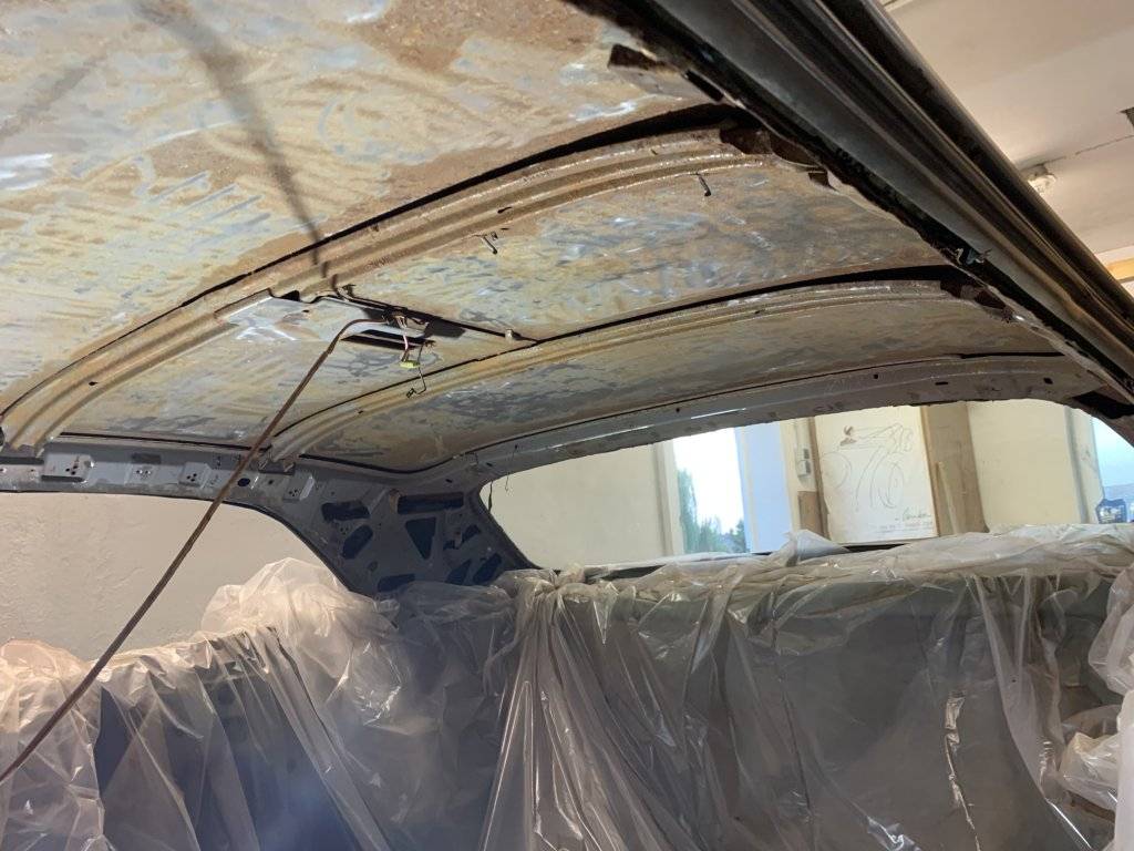

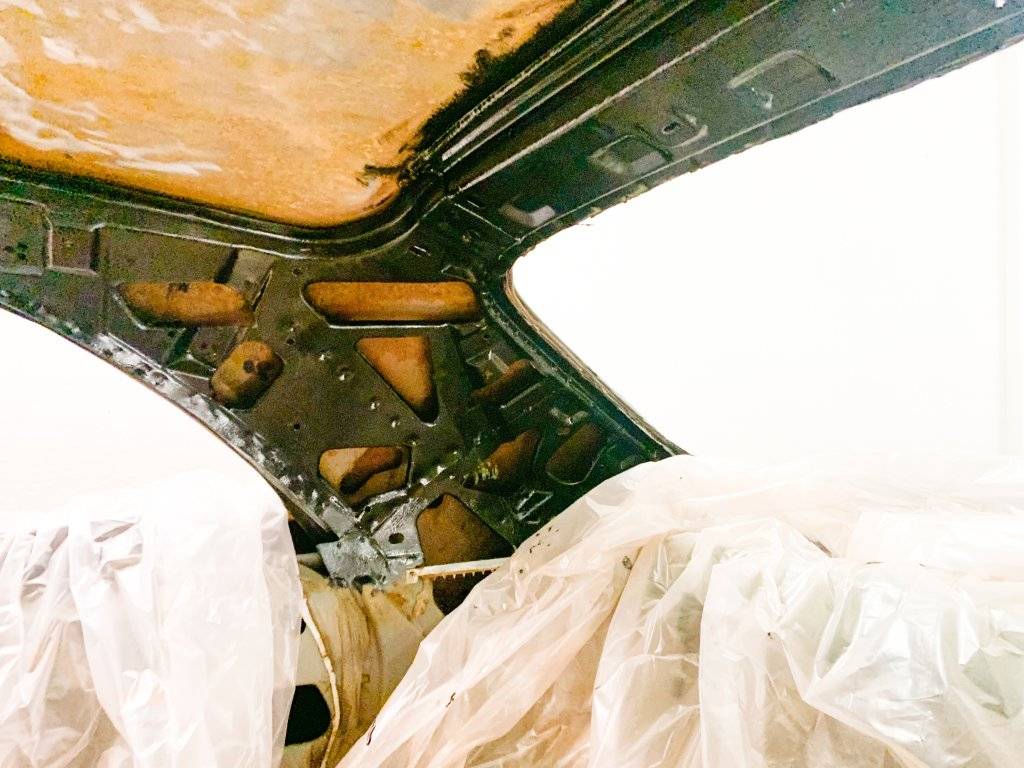

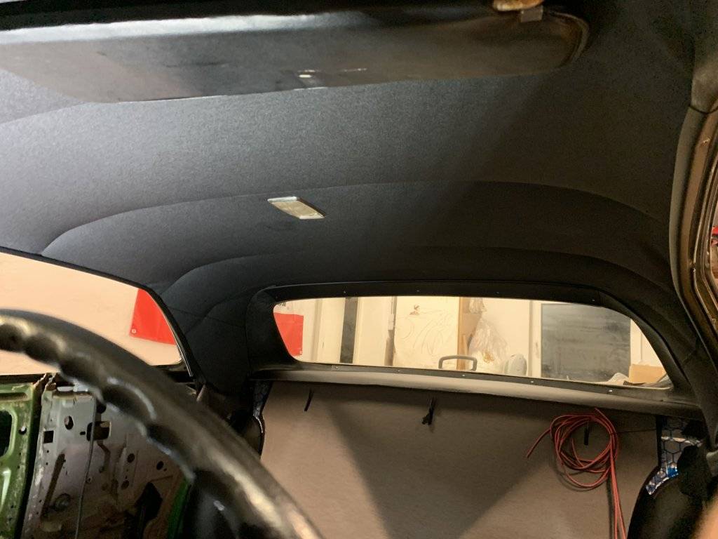

I continued to work on the car. the headliner is out and the roof is painted.
i found mice and feces under the headliner.

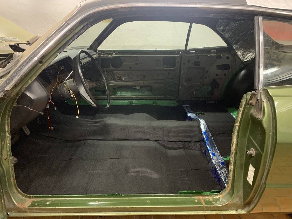

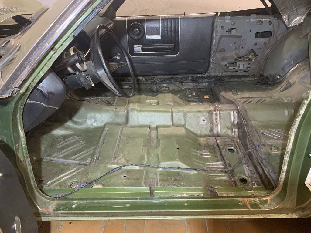

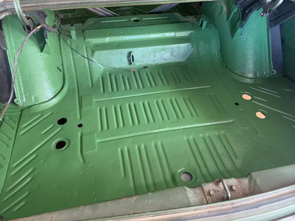

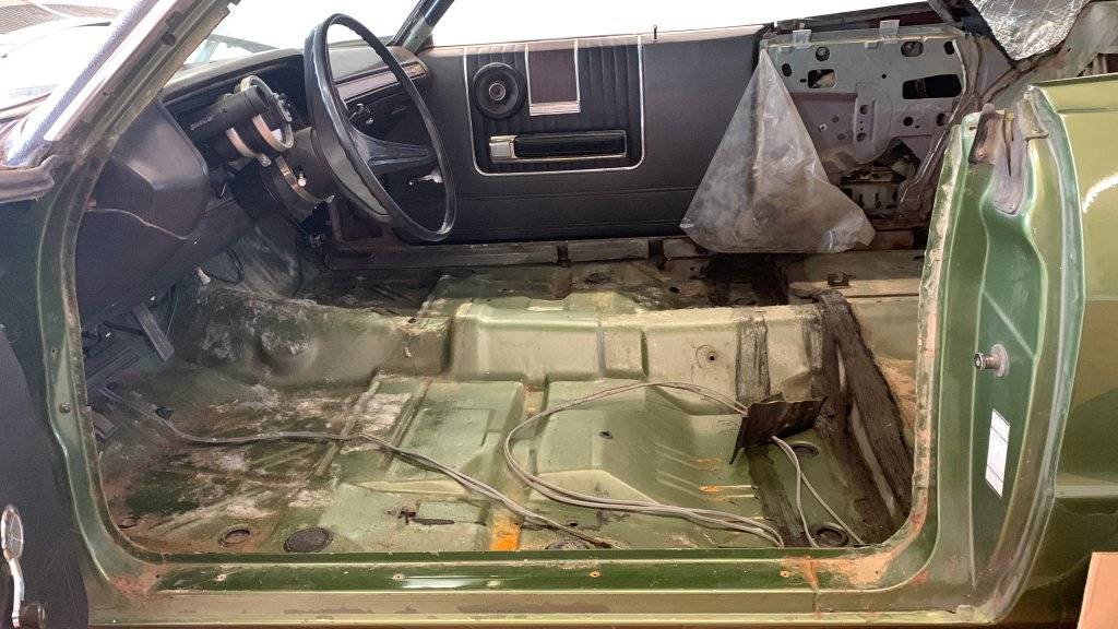

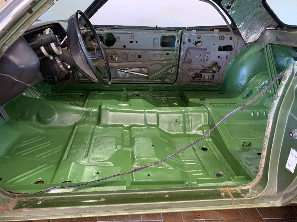

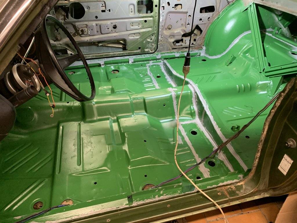

i was curious what the floor looks like. there was slight rust. So everything sanded down, degreased and painted
Great update, @BE_Fury

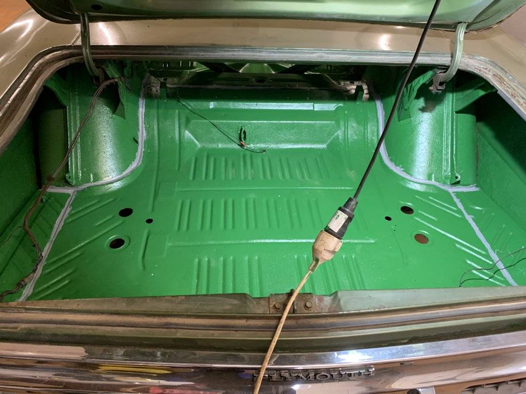

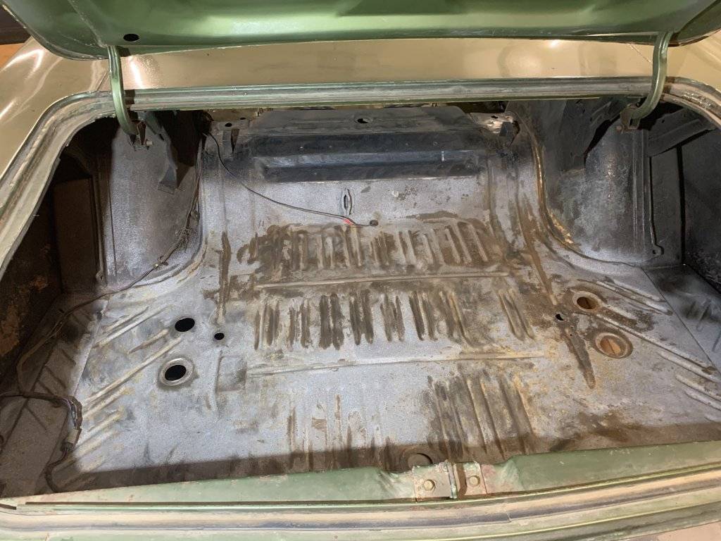

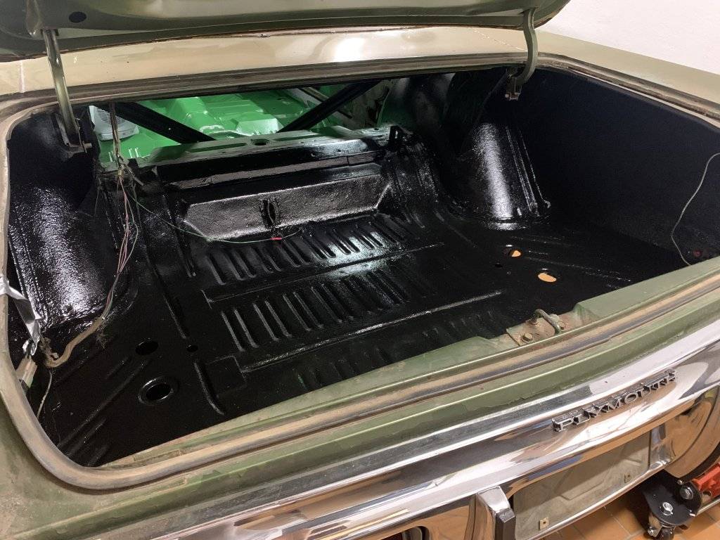

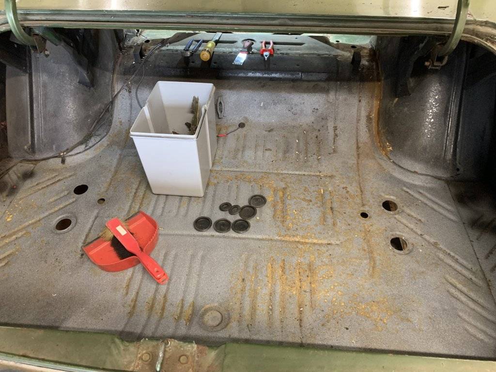

For the trunk, are you planning on adding a layer of the original splatter paint?
I would like to move between "modern + good" and "original". so far i have not received an address for the color in germany. my focus at the moment is more on the interior. when i'm done with the interior i'll continue with the trunk

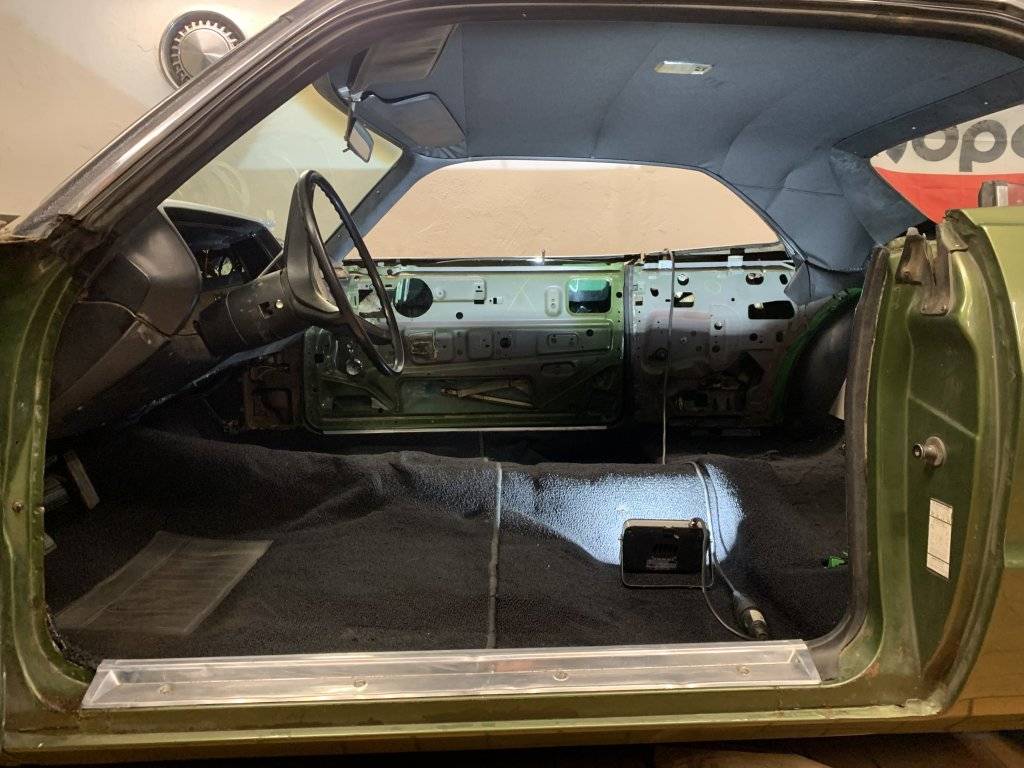

the carpet is back in. now i have to wait for the delivery from sms autofabric so i can replace the seats, the headliner and the door panels
I’ve become the delivery of SMS and a second from a eBay seller. Both headliner are the wrong. The Sailpanels are not fixed on the headliner. So, I’ve to wait for a third headliner. I hope, it would be the correct headliner for my car.
The second Headliner didn't fit either. Now i sewed a Piece to the first Headliner. It’s not perfect, but okay for now.

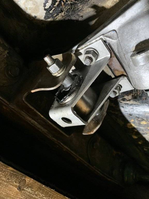

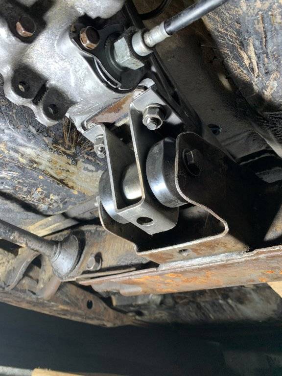

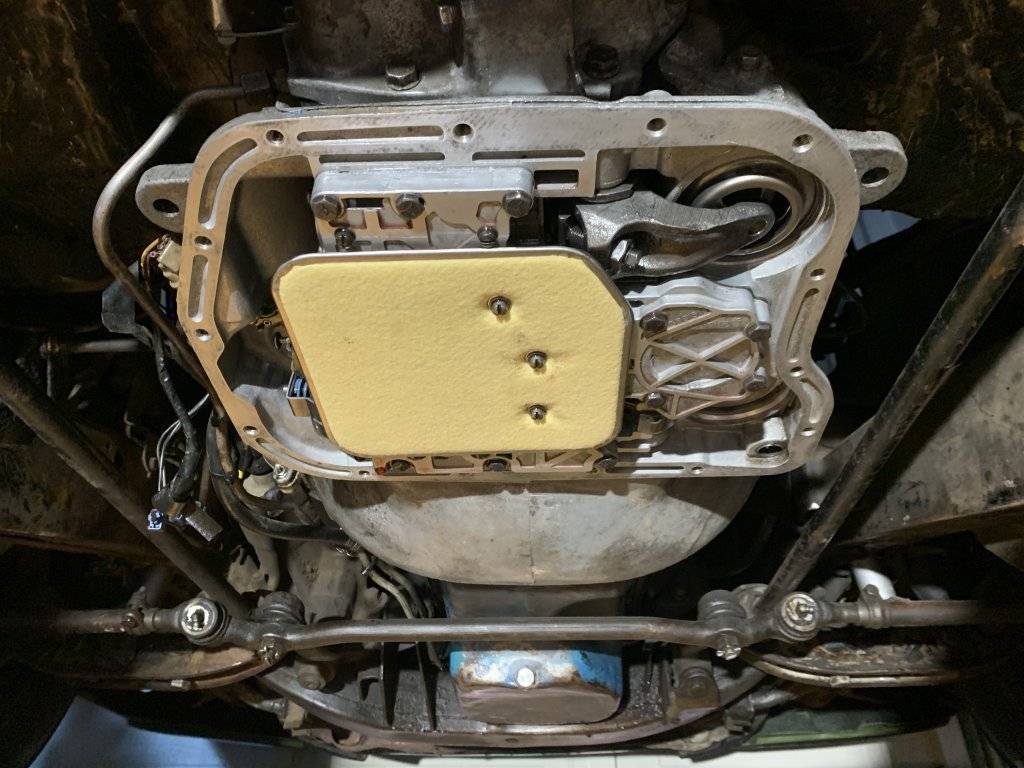

the transmission mount was unfortunately broken. I replaced the bracket with a ready-made kit, which is said to be more stable than the original.

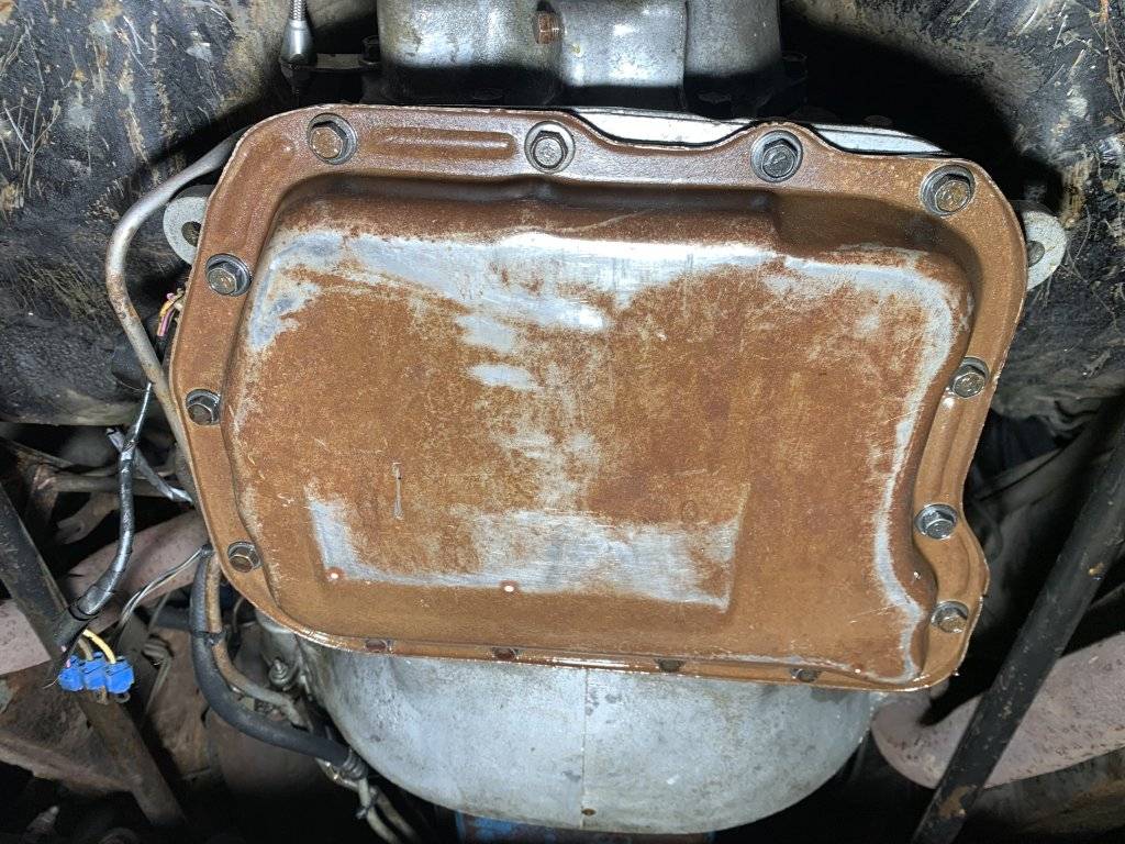

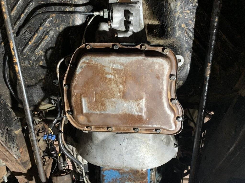

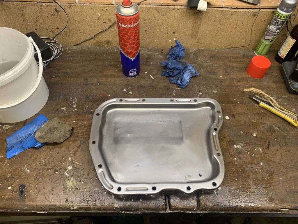

the transmission pan was leaking. I replaced the seal with a cork seal. I glued the seal in place with the appropriate silicone. that should last a few years
Nice to see the progress! FWI, I have used a Prothane transmission mount (see here) on all my restorations. Zero issue thus far.
