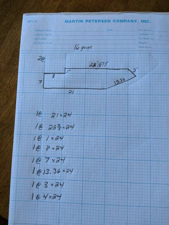

I am making a fuel tank out of stainless as I plan on putting in a fuel pump for a holley sniper system(more to come on that, 383 stroked). If I can not get my hands on enough ss, I plan on using 16 gauge carbon steel which I have unlimited access to. I am a welder by trade so I am not worried about leaks, but curious about rust. My existing original fuel tank is out of the car and looks absolutely perfect on the inside, no rust at all but I keep reading about sealers in fab forums. My thought is that the original did not have it so my new one will not either. What do you guys think? Anyone else done this before? I have a idea on a baffle design but any ideas would be wonderful. The tank is going to match oem except 1 inch deeper and have a flat step on the top in the front to mount the fuel pump.
Side view

I see no clear advantage to using stainless steel. Id certainly have a shop with a brake, bend up as much of that tank as possible. If your TIG welding and have butt welds, that presents another problem as you have to back purge.
Myself id think about aluminum instead.

There is an epoxy liner called Caswells that works very well. I have had it in my motorcycle tank for over 10 years. If your building a tank you need to have a plan for testing. My motorcylce tank has over 12 ft of weld joint. At no more than an inch at a time that's 150 tie ins. With a sheetmetal tank you cant pressurize them to to an effective amount without creating a bomb.
My tank would hold 2-3 lbs for weeks. I ended up doing a submersion test. Which is also very difficult. They want to float. I had a few leaks that would take 30 minutes to form a bubble the size of a pin head. I thought my eyes were off.
I was a pipe welder for years. Proficient in all manual processes on many materials. But it is just not comparable to one passing and hammering and sanding sheetmetal.
If I was to do a car tank I would probably do aluminum of a substantial gauge and outside corner joints.
