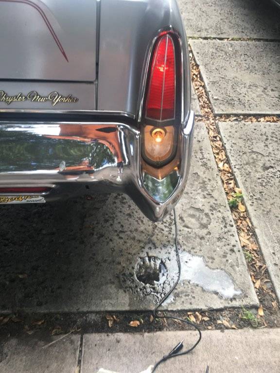

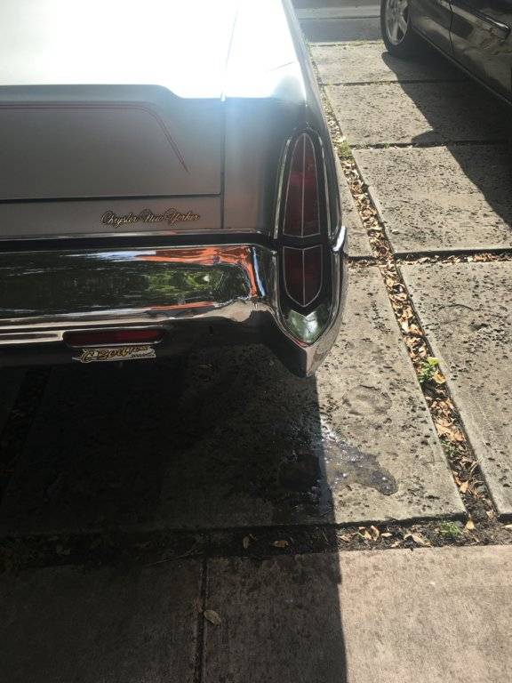

Rear lower passenger tail light was out... and the turn signal was always turning off the radio... same circuit.
as I loosened the screws....
I heard water.... then I saw water... a lot of water
Bulb was a bit worse for the swimming and actually had water in it. But the socket was fine! Go figure.
All better now.

The turn signal and radio is on the same circuit? I wonder from a design standpoint why someone would make that choice at Chrysler
The could be on the same basic "feed" circuit, which would branch out to the OTHER feed circuits for a multitude of functions. Have to check the schematics to make sure, though.
When I saw the bulb I figured for sure the socket was gone.
Me too... but it was packed full of grease... I think the previous owner may have done as I don’t think the factory did it.
Will check the back of the plug tomorrow and reopen the fixture to check for water after having it rain all the way back from a road trip I took.
