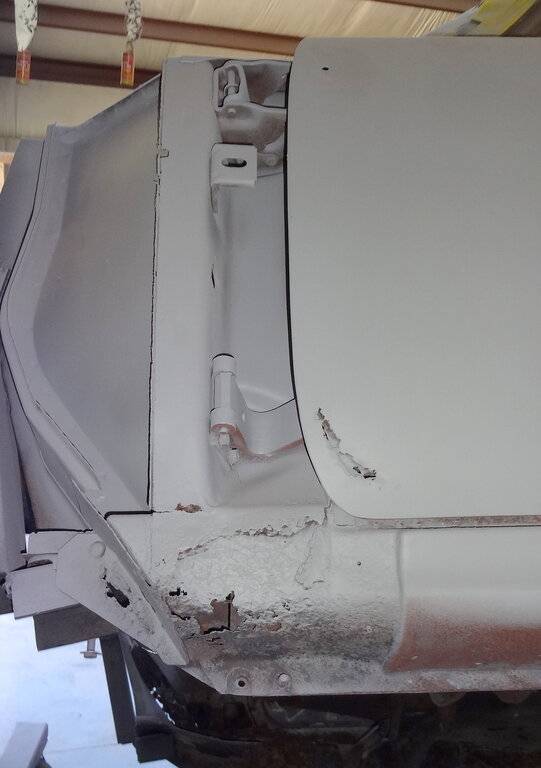

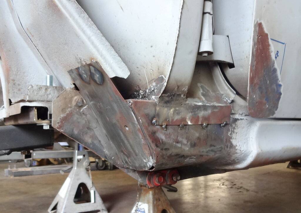

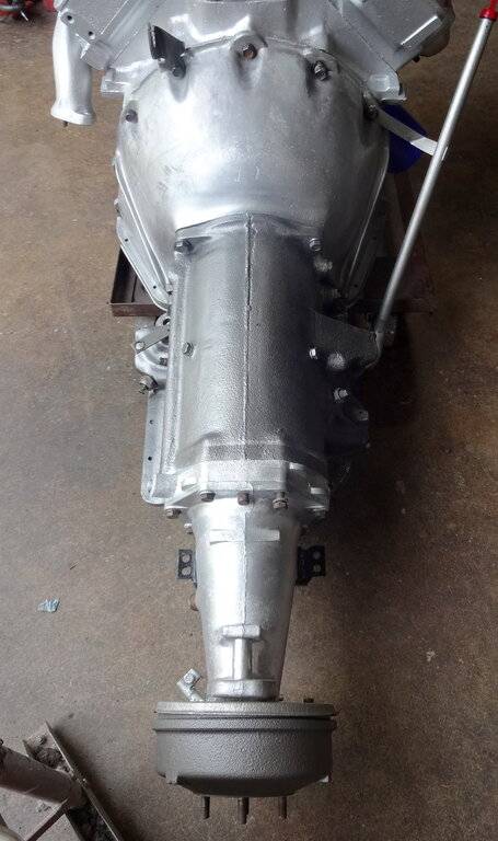

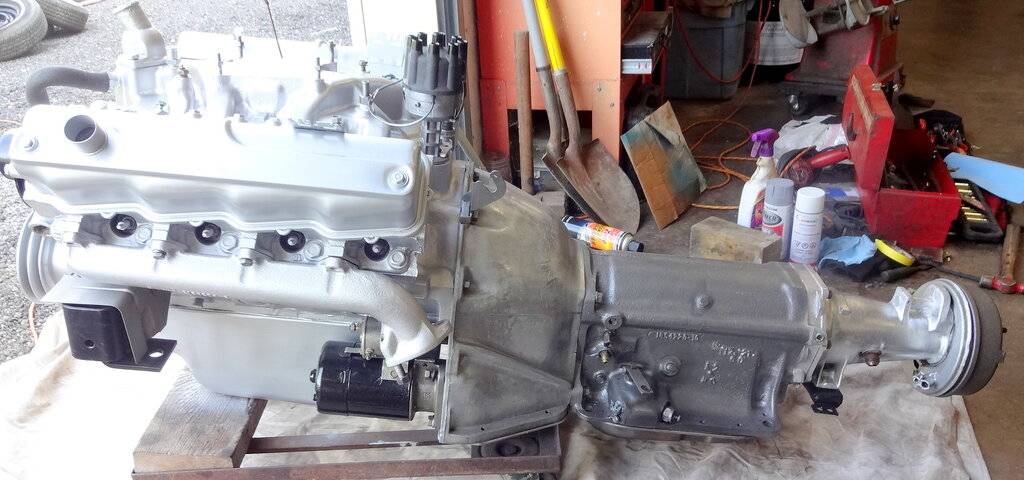

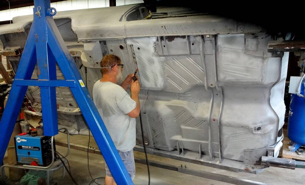

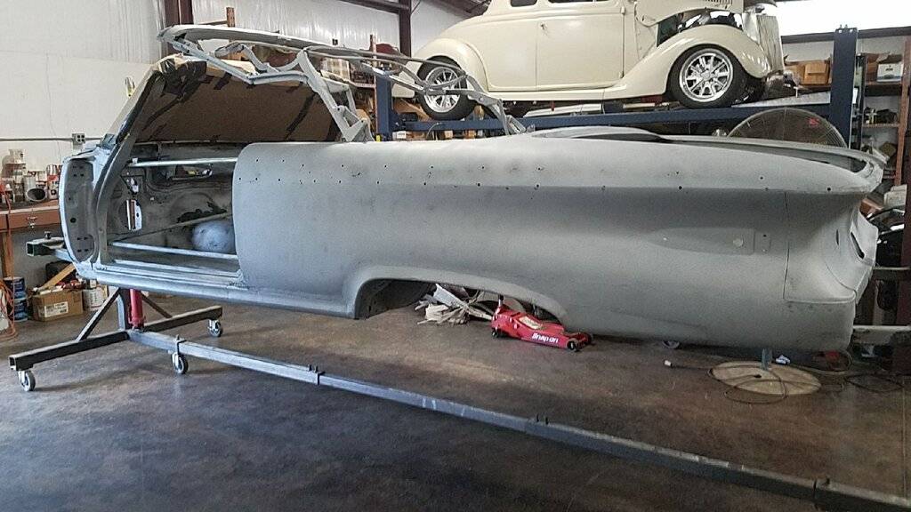

More progress on Virgil this past week. The stub frame and engine are ready to mate together. Body work is going a little slower. Once we get it up on the rotisserie and blasted things will pick up. Finish welding and grinding on the underbody, (floor and trunk pans), and final coatings, and the stub frame and body can be reunited, (for the final time).
Using the mount plate and center bolt from a later small block I was able to change from the old cartridge style oil filter to a spin on oil filter. Oil changes with the cartridge were a nightmare.

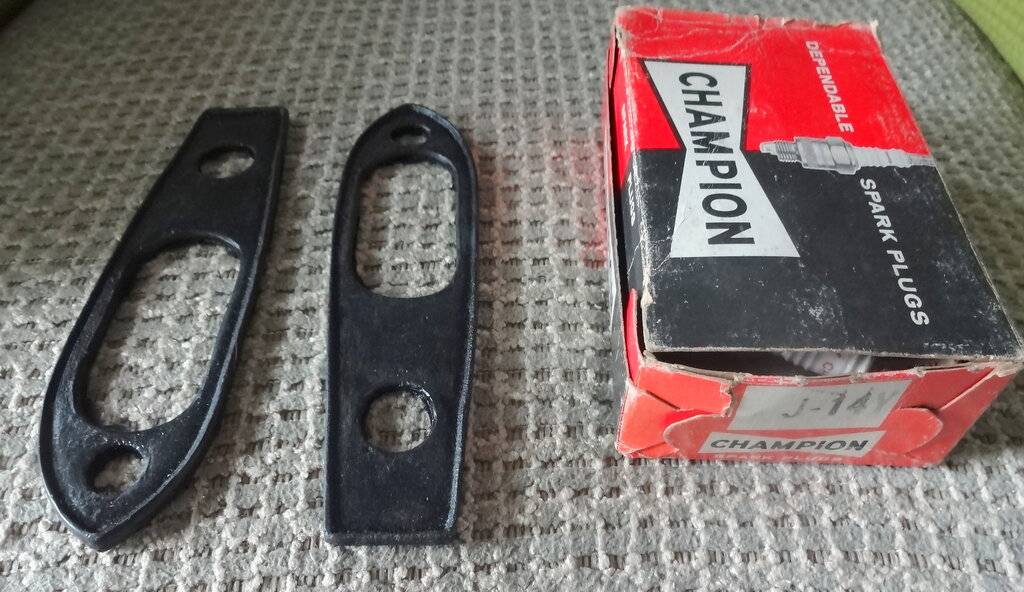

By some minor miracle I located a fellow who reproduced the base gasket's for my NOS dual rear antennas. It dosen't seem like there would be much of a demand for them. LOL.
Also a set of NOS champion plugs.

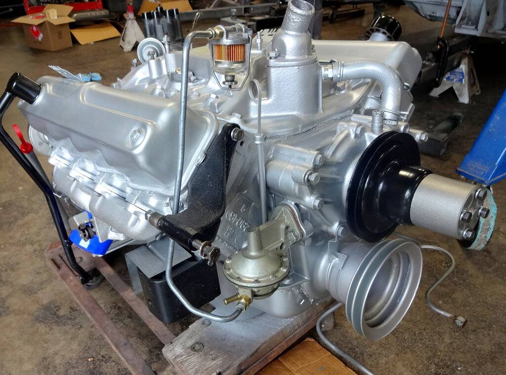

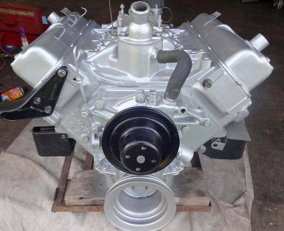

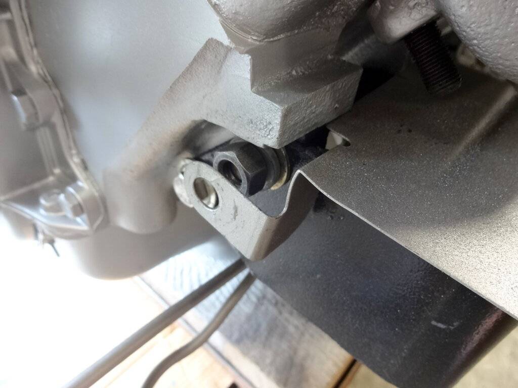

Any of y'all with a poly 318 that has the heat shields on the motor mounts, maybe you can help. On the left mount the heat shield has a tab on the forward end that aligns with the long mount bolt but has a space, (about 1 1/2"), I can't figure out what the purpose of the tab is......?
There is no information in the FSM or the factory parts book about it.
That doesn't look like a heat shield. Not from that angle anyway.

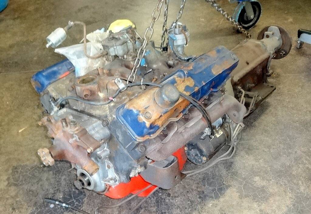

It is. It shields the rubber mount on the back side from manifold heat. There's one on both sides. It's one of those things that usually gets tossed if a mount gets changed, or the engine is R&R'ed. These came off the donor car. I took pictures but seem to have missed this detail.
Wil: That tab is lined up pretty close to the motor mount bolt. It appears there is something missing between the tab and the nut. Maybe there is supposed to be a longer bolt and a spacer in there somewhere. . . Is it on backwards?
image-jpeg.399535
Thanks Rip. Your right, I need a longer bolt and a spacer. Not sure what that's all about. It is installed correctly, the only way it can be installed.

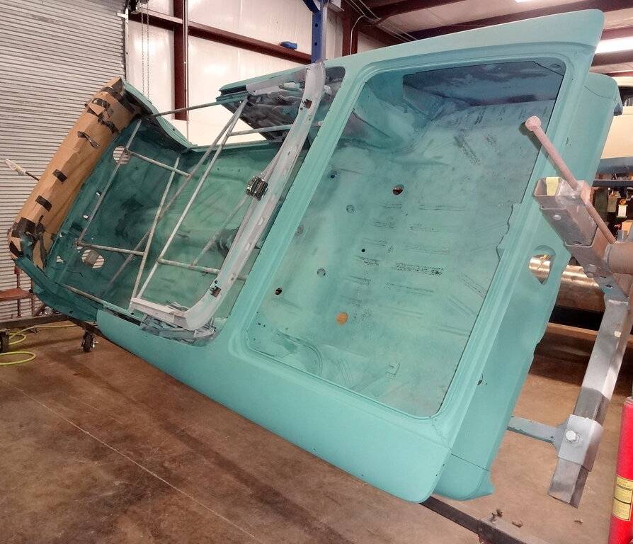

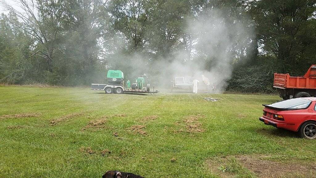

Having Virgil sandblasted gave me a great reason to get out of the way of hurricane Sally. We spent Monday, Tuesday and Wednesday prepping and acid etching all the bare metal. This was a big step forward and will signal the beginning of finish body and paint.

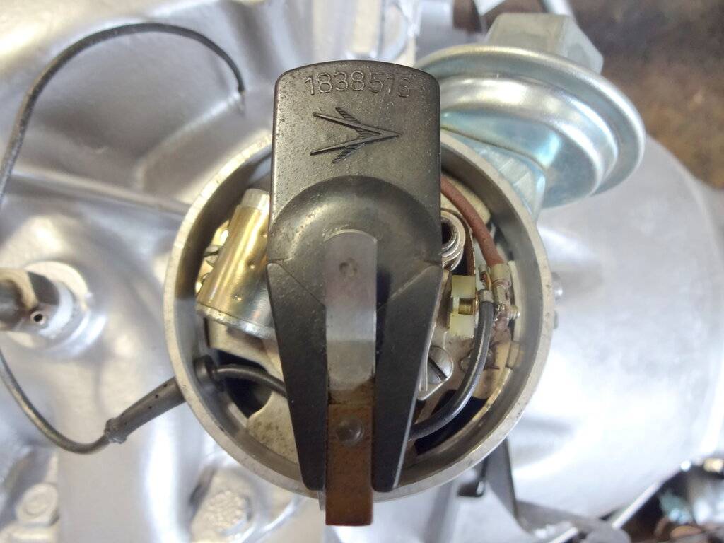

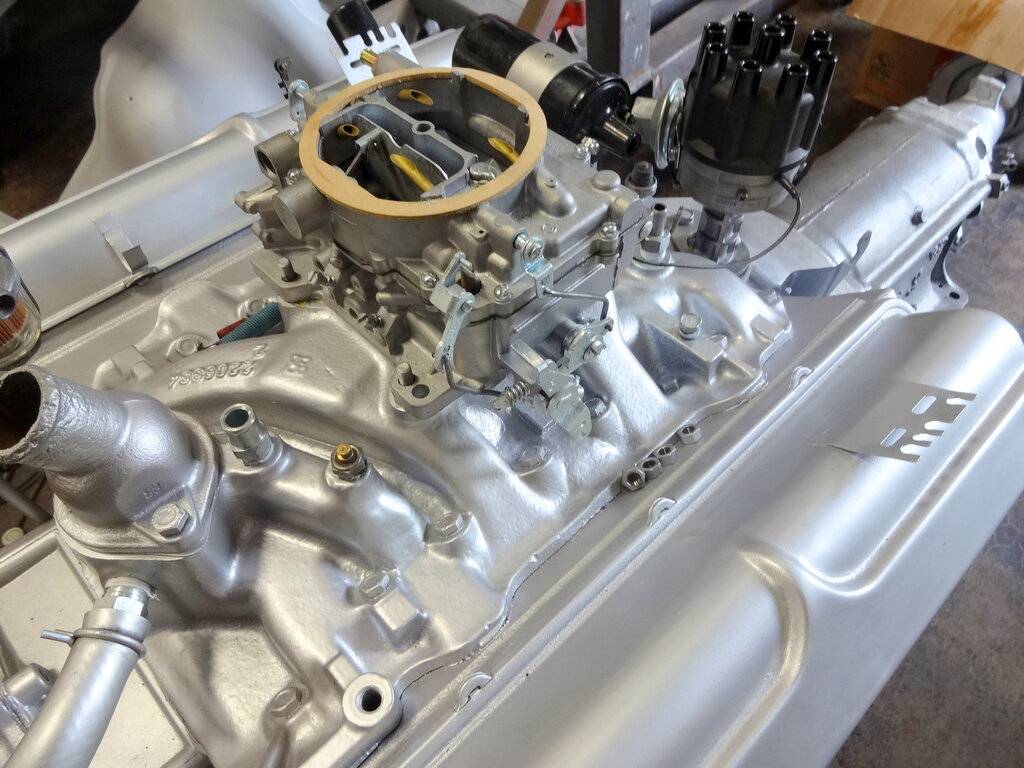

Carburetor, (restored at Woodruffs), in place for a photo opp. Found an original forward look rotor and dist cap.
I also located a NORS dist advance for a 61 318 4 bbl, (power pack). As rare as the correct carburetor.
