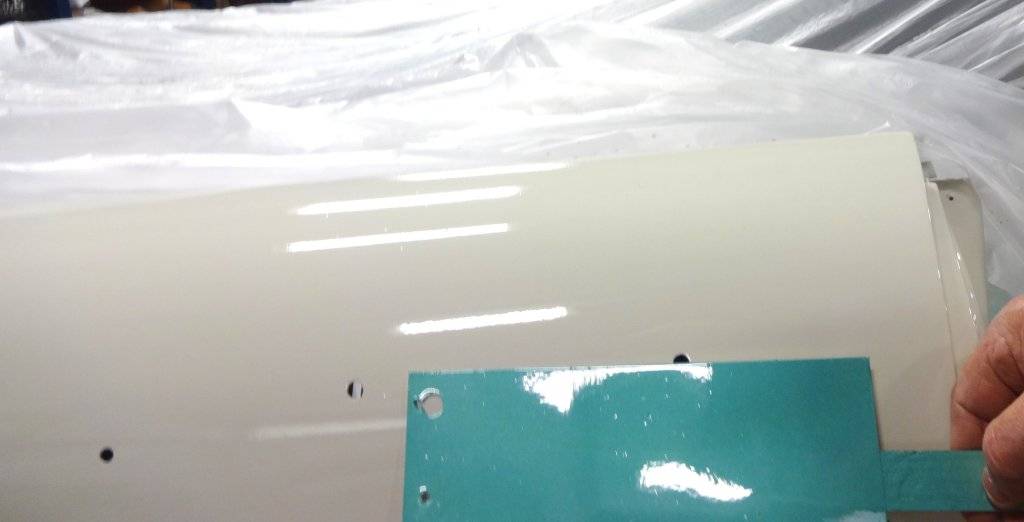

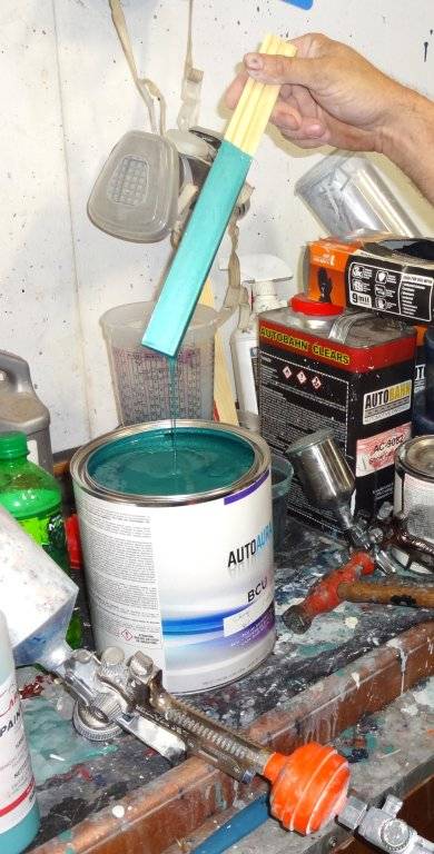

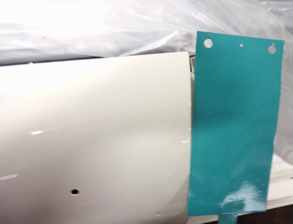

Heres a look at the Emerald green I have selected. Very close to the correct "G" code Emeral green on the 61 Plymouth color chart. 1 gal paint, 1 gal reducer, 1 gal show clear...... $460.00.
Will be delivered tonight and should be able to spray, (body), tomorrow

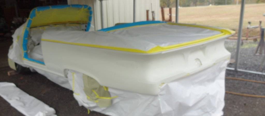

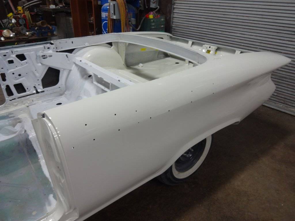

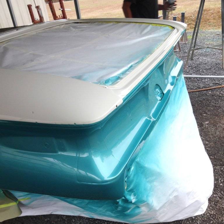

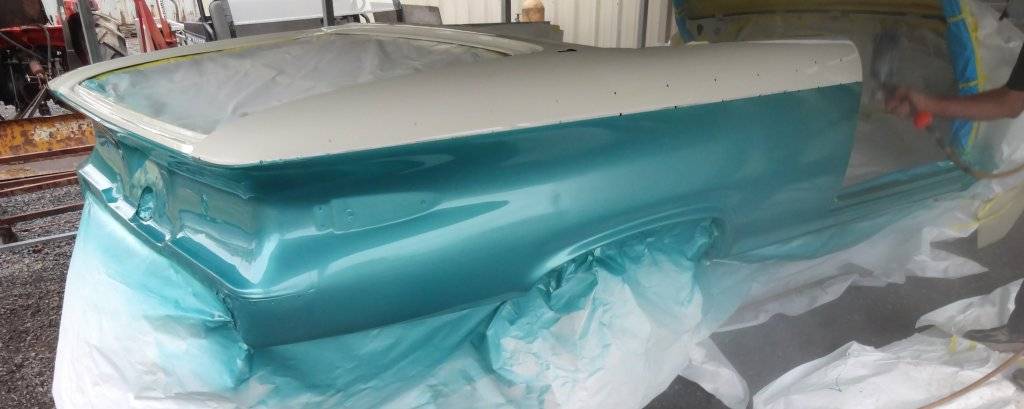

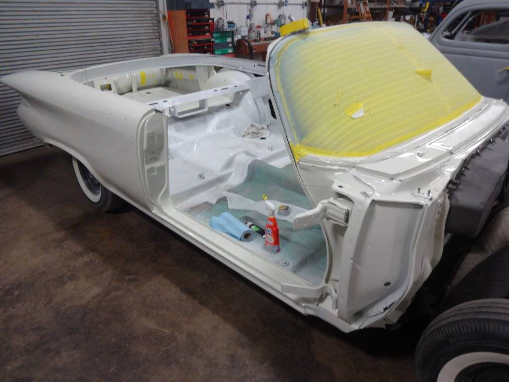

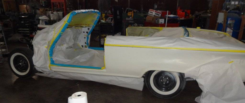

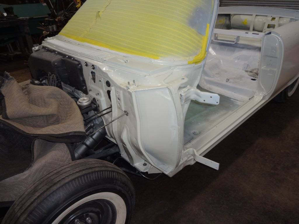

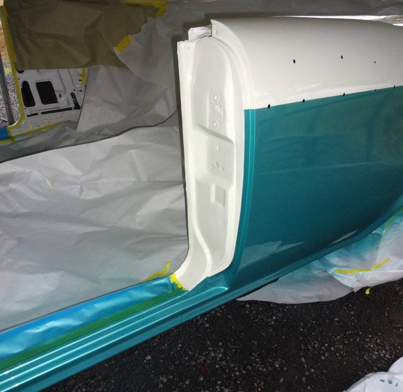

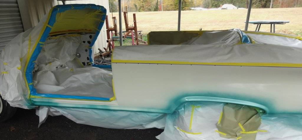

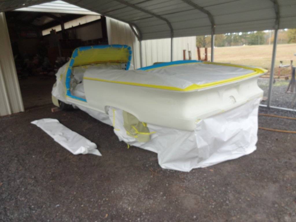

Body was painted Arctic white and then express clear coated, then a 600 wet sanding.

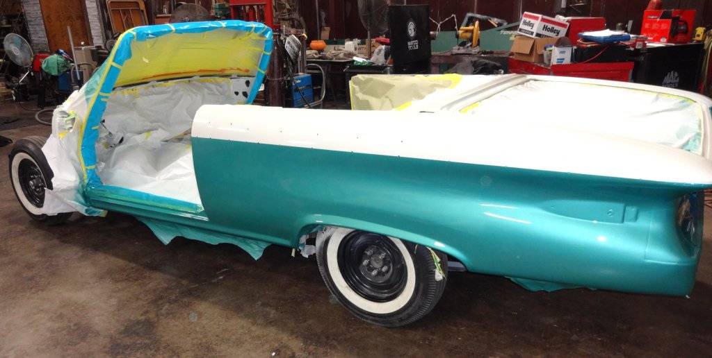

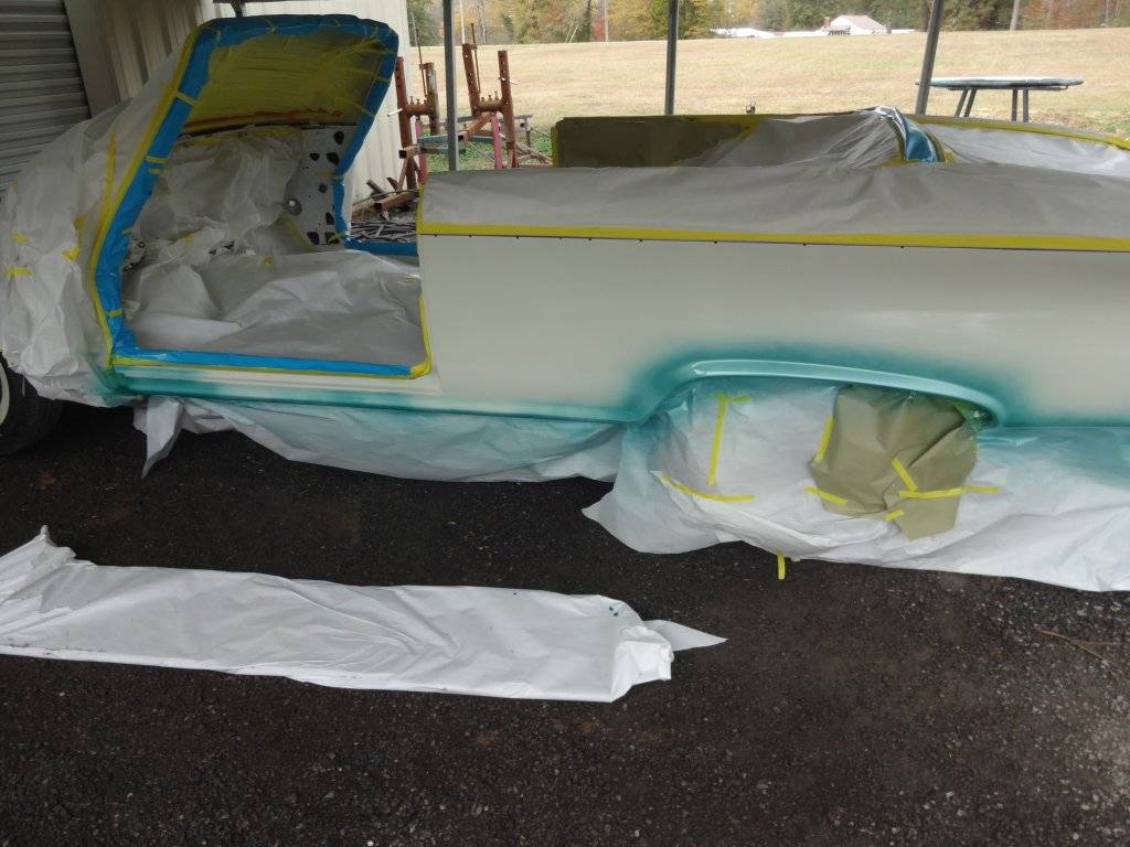

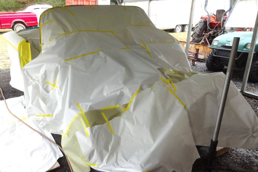

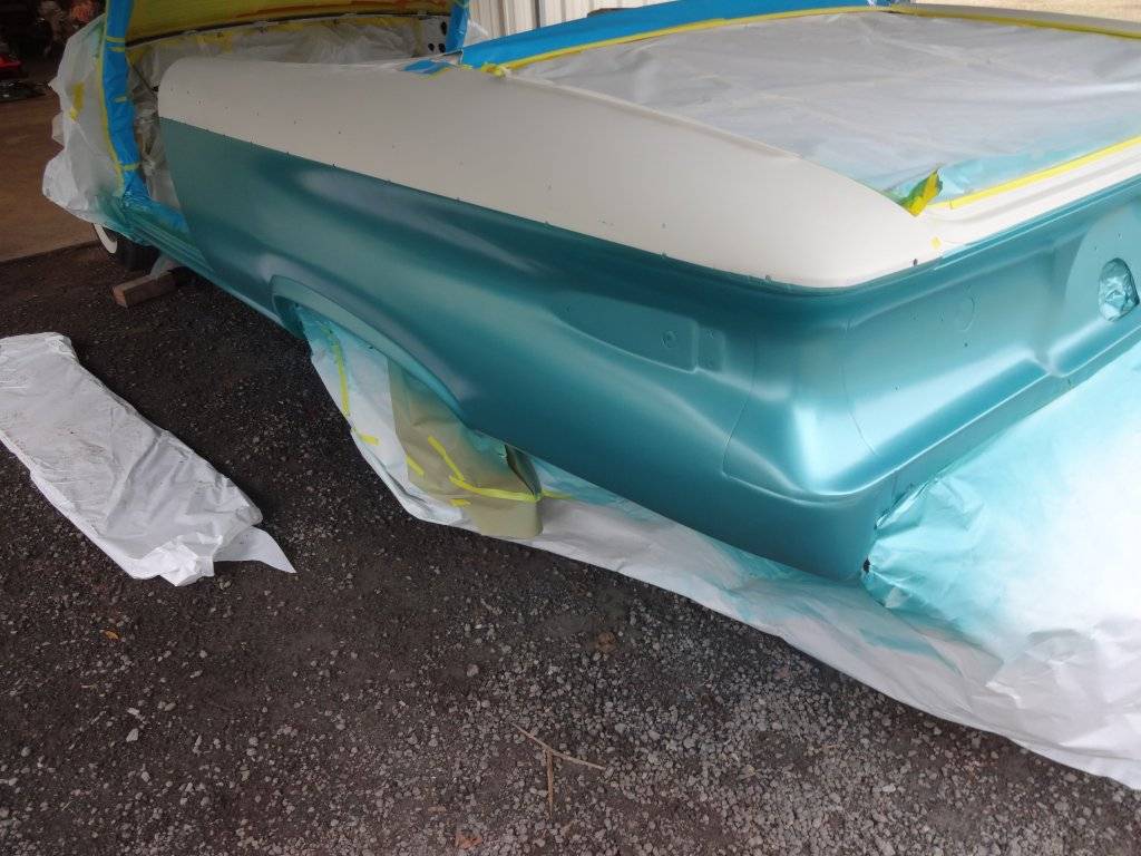

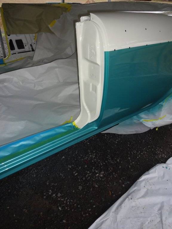

Next, the Emerald green and finally a heavy show clear. Body was double taped. first the Emerald was sprayed, then after removing the second level of tape & paper the rest was clear coated.
Three long days of prep to get to this point.
Considering it was a cloudy, damp, cool morning, and the car was painted outside, under a canopy, on a gravel pad and there was zero wind. It turned out to be perfect conditions and not one flaw appeared in the finish. :thumbsup:
Needs to dry and cure now. I'm taking a couple of days off.

Way-ta-go, Wil! Absolutely stunning! Now. . . Where is that fire-breathing Poly? :poke:

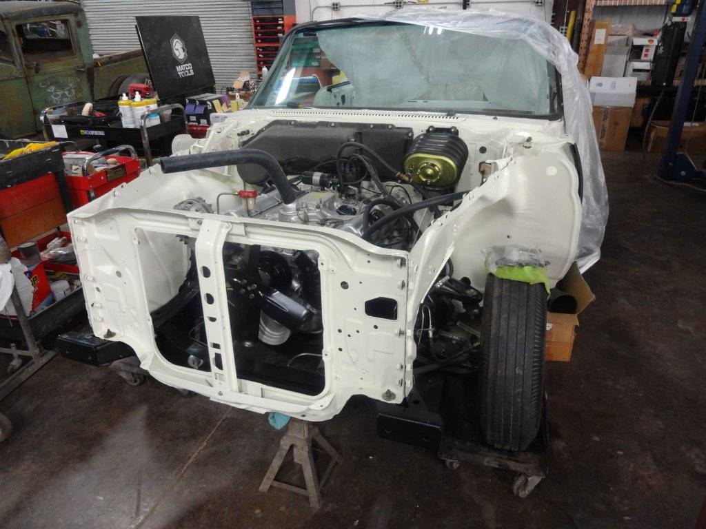

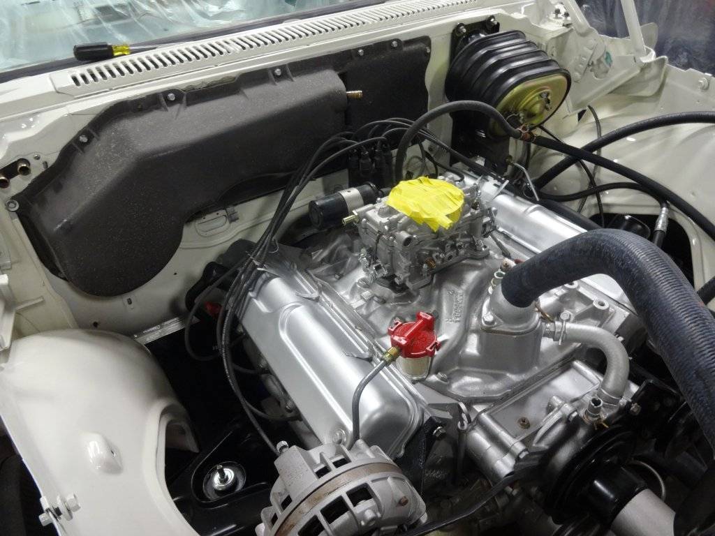

A little progress. brake booster and master cylinder installed. I got a good pedal just by pumping the brake pedal. final bleed should be easy
My AFB built at Woodruff's is in place.
All front inner sheet metal is painted and in place.
