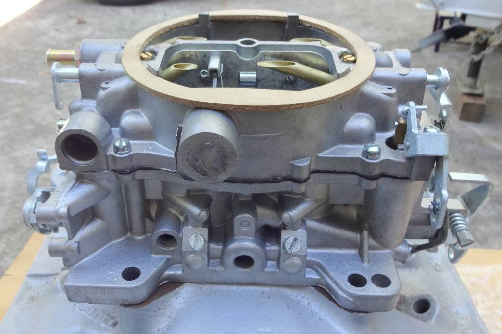

Yes Bob. It has been rebuilt and runs great. I'm adding a 4bbl.

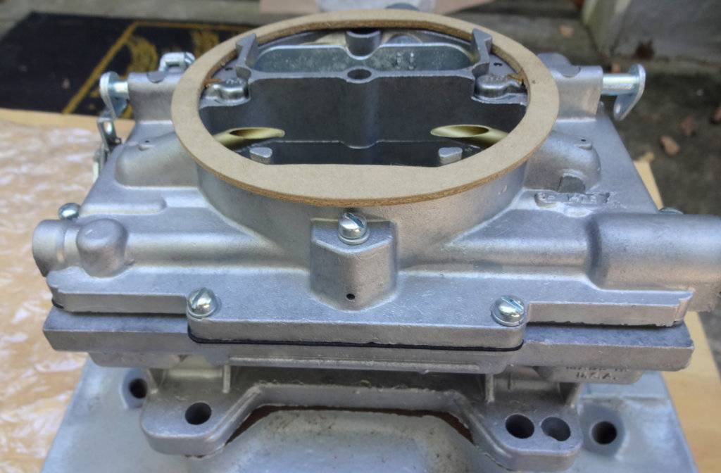

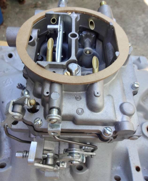

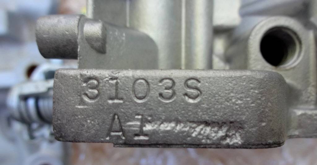

My carburetor came back today. I'm really happy with how it turned out, considering it was totally froze up. This carb is unique to a 1961 318 w/power pack only which was a pretty obscure option then. You think C body stuff is hard to find....?
It's a 3103S, 3103 is 61 318 power pack, "S" means a factory installed carb. The A1 is a date code, I have to determine that yet. Virgil was assembled in April 61.

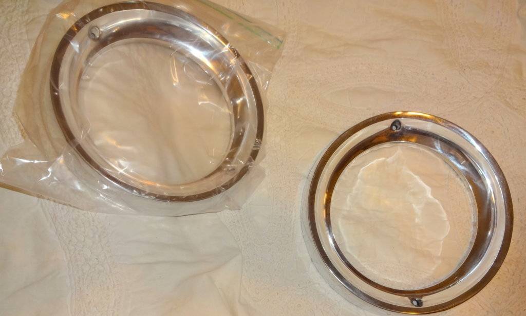

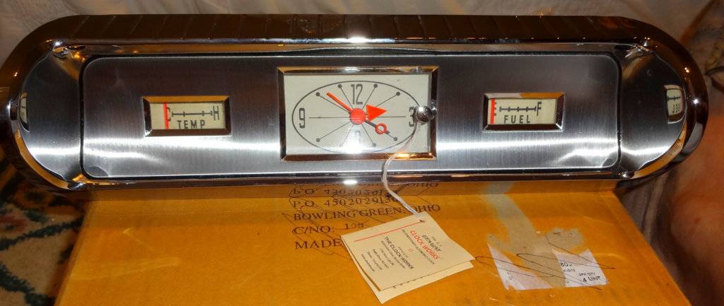

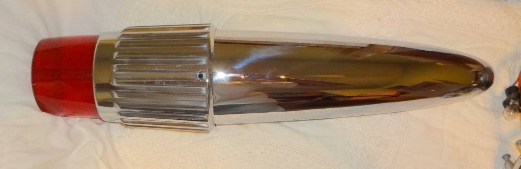

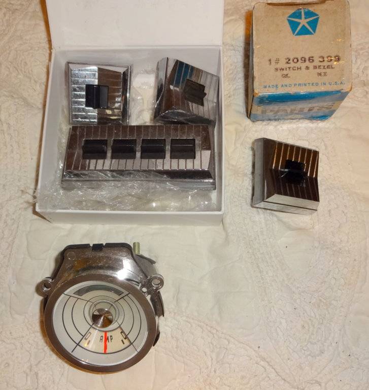

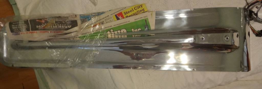

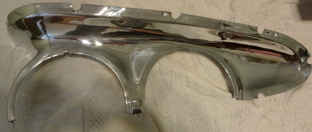

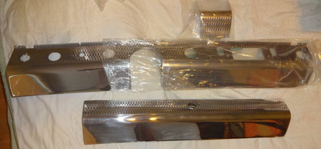

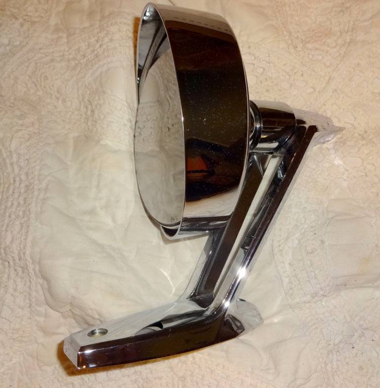

Some shiny motivation. I'm tired of posting pictures of dissembled, rusty, dirty stuff. This is some of the stuff I have been working on and collecting for the past 3 1/2 years. I have a bedroom dedicated to finished parts and this is just a taste of them.
Bumpers are rechromed and ready to install, steering wheel is re cast......... There will be some fun in the future.
LikeThe Critter's restoration thread, I am sitting back in amazement at the work going into the car while I hear a cash register in the background ringing constantly. :)
WHAT......? Can't hear you over the ringing noise..... LOL.
So far it's been spread out over a few years Stan. If i'm lucky, in the end I'll come out flush. Most of the labor, stripping, cleaning and mechanical I do myself.
