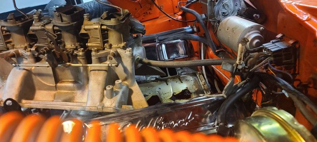

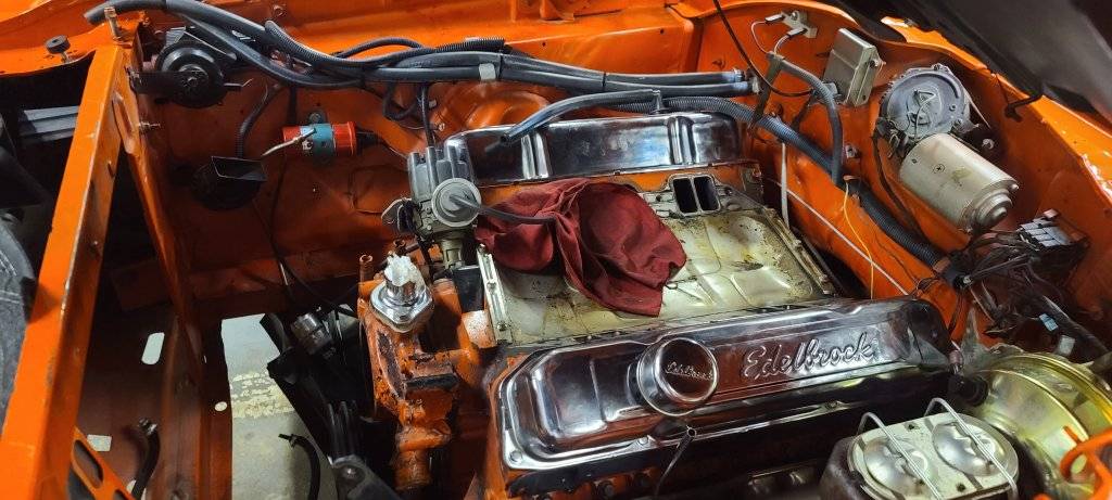

Thought it'd be a good change of pace to work on the B body today.
Going to pull the engine/trans, go through them, re-gasket some minor leaks that have developed over the last 12 years, clean up the engine bay and repaint the engine.
Little trick I use to protect my radiators from damage when removing/installing the fan...slip some cardboard down between the rad and the fan and then if the fan falls off, or is stubborn and doesn't want to let go and then sudden pops off, you won't crunch any fins on the rad. ;)

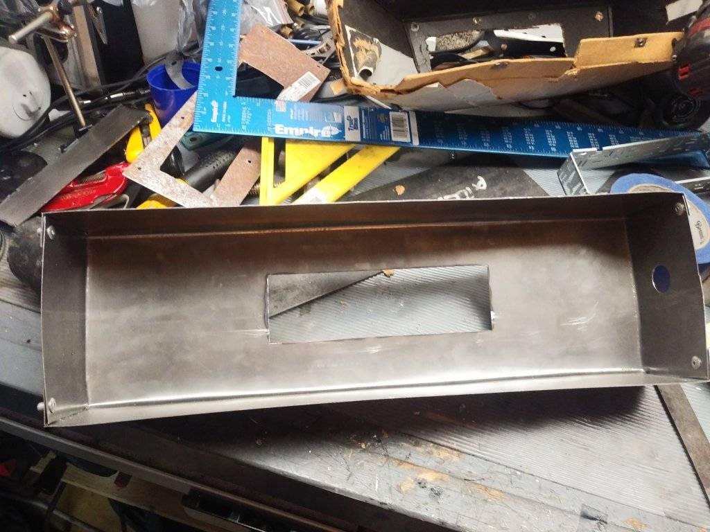

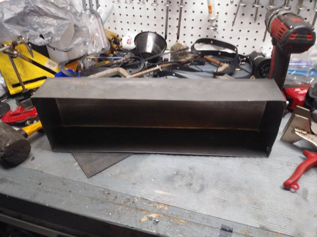

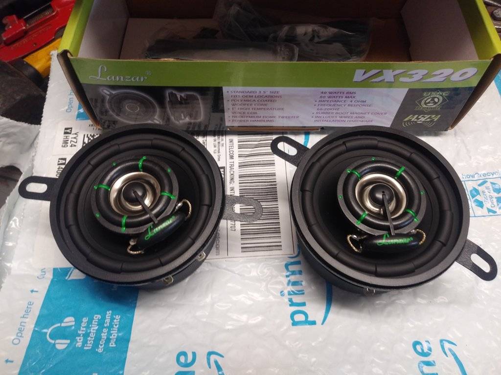

Added a budget hidden stereo system to my Polara. I couldn't justify spending $500 + for a Retrosound system, or the $800 + to have my original radio retrofitted with modern internals. After a few evenings crafting a speaker housing and a new glovebox insert, I have a system that works just as good, with less than $100 invested.

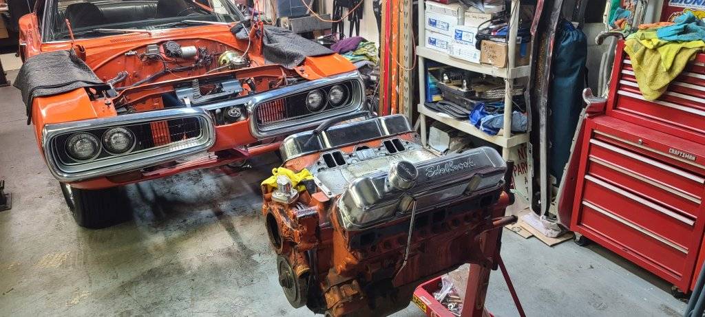

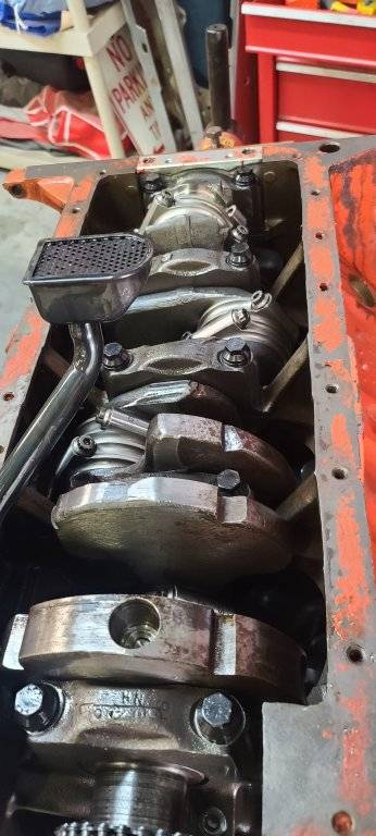

The 440 is out and the parts lists will get put together soon. Maybe some upgrades are in store.
After checking the rod bearings the torque on the ARP bolts was more than than the FSM spec of 45 ft lbs.
I need to check the what the torque spec is supposed to be when using the ARP bolts on the rods.

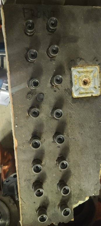

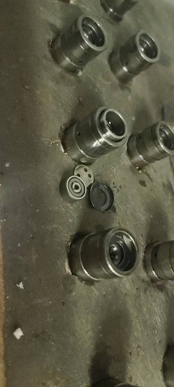

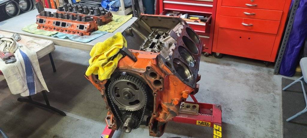

While tearing down the 440, found one lifter was wrecked in #3.

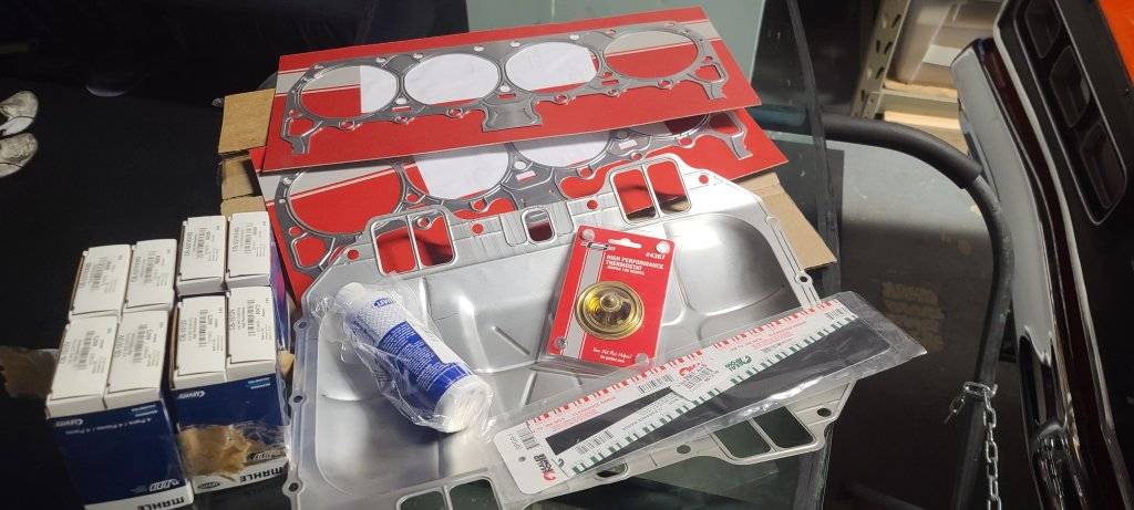

On a brighter note, some new parts arrived....

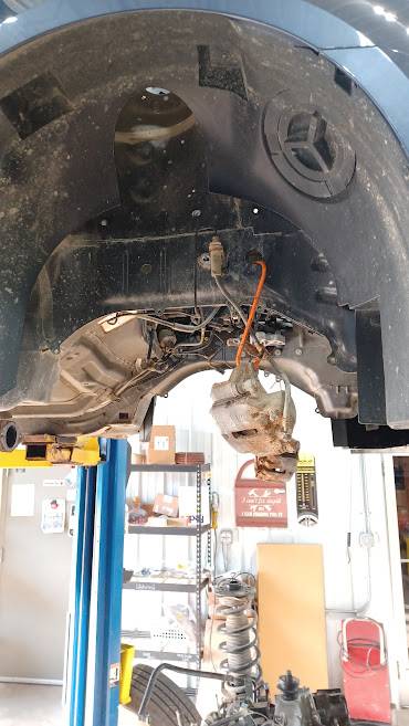

So I finished this this weekend, I picked it up earlier this year with a bad engine. 2.4 Equinox engines will have a issue with the PCV plugging eventually (high mileage) and during winter months the crankcase blow by that would normally be sucked up by the PCV, gets pushed into the airbox from the fresh air tube and will freeze. Then with no outlet crankcase pressure rises and 9 out of 10 times it will blow out the rear main seal. Large amounts of oil leakage causes bad things to happen, I got this one with a set up engine.
I don't have any pic's off the tear down or reassembly, but what I did was I pulled the engine and tore the head and all the parts I wanted off. I happened to by installing a 2.4 in a Terrain so I took the core short block and sent this one back as the core with the Terrain's junk head.
I tore the short block down, cleaned everything, new rings, bearings, rear main seal, sent the head to my machinist to get flattened, cleaned all carbon from the valves and ports ( horrible on direct injection engines) new valve seals, cam phasers, timing chain kit and balance shaft kit, gaskets, head bolts. Put it all back together and jammed it in Saturday. Got it started yesterday, changed the trans fluid and filled the coolant. I need to turn the brake rotors (rusty from sitting) and my Son and Daughter in Law will have a new to them ride at a good price. It's hers I guess
Here is the empty hole
Here is what I am putting in the hole

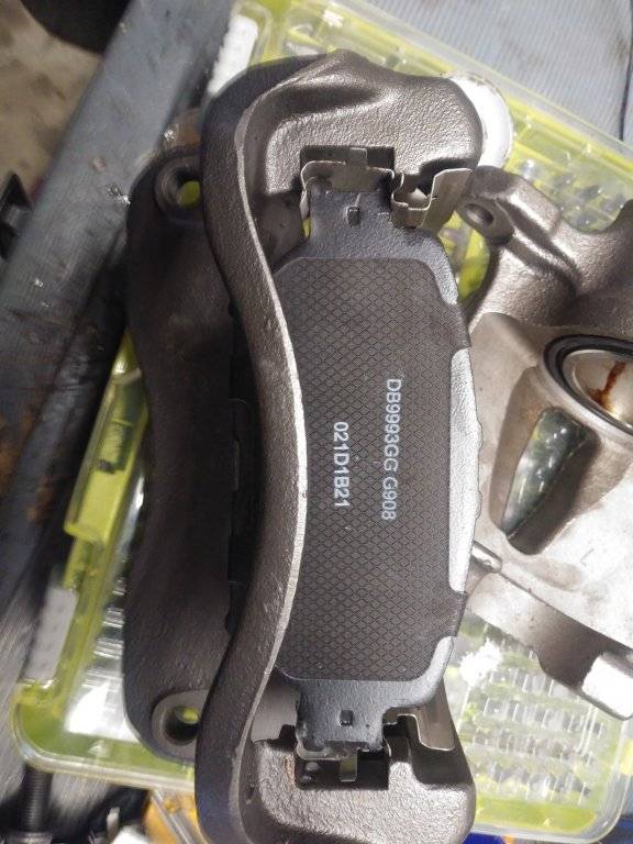

Working on a non-Mopar product today. I set upon completely overhauling all the brakes on my Camry, calipers, pads, and rotors, front to back. The rears were installed without any issues, however, I can't say the same for the front.
The first red flag: the reman front calipers said Cardone on the box. Normally, that's enough for me to ask for something else. However, nothing else was available until tomorrow, and I want / need this car back on the road. I decided to bite the bullet. Right off the bat , none of the hardware came with either caliper. We were able to piece together what I needed at the parts store, and off I went. Once I got home, and got to work installing this crap, the mistake I made was immediately apparent.
The caliper bracket on the passenger side won't even hold the pads.
Compared to the other side, I estimate there is at least half to three quarters of an inch difference. They might as well have just taken a dump in the box. So now I'm stuck waiting for replacements, the Dodge is stuck out in the rain, and my primary vehicle is out of commission. :mad::mad::mad:
Moral of the story: don't ever use Cardone parts. Ever. I mean it.
