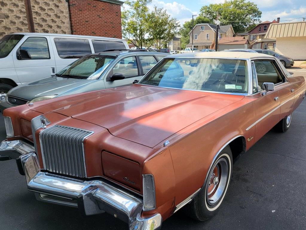

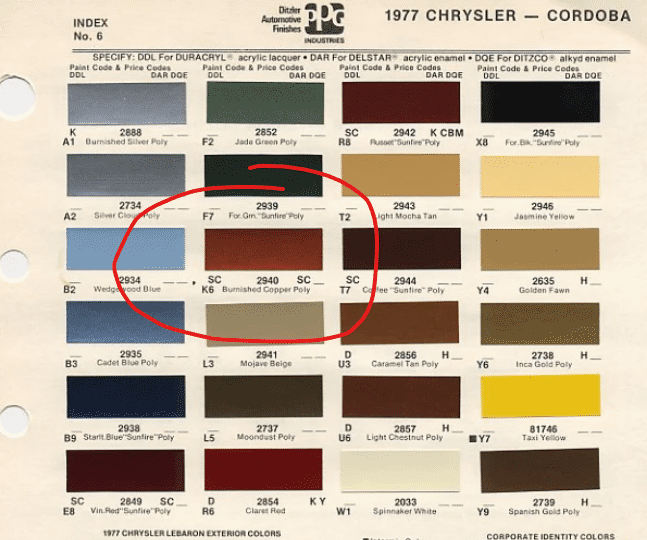

I can only find the paint chip sheet for the 77 Cordoba. Would the colors for the New Yorker be the same? If so, I guess mine is "Burnished Copper Poly" ?

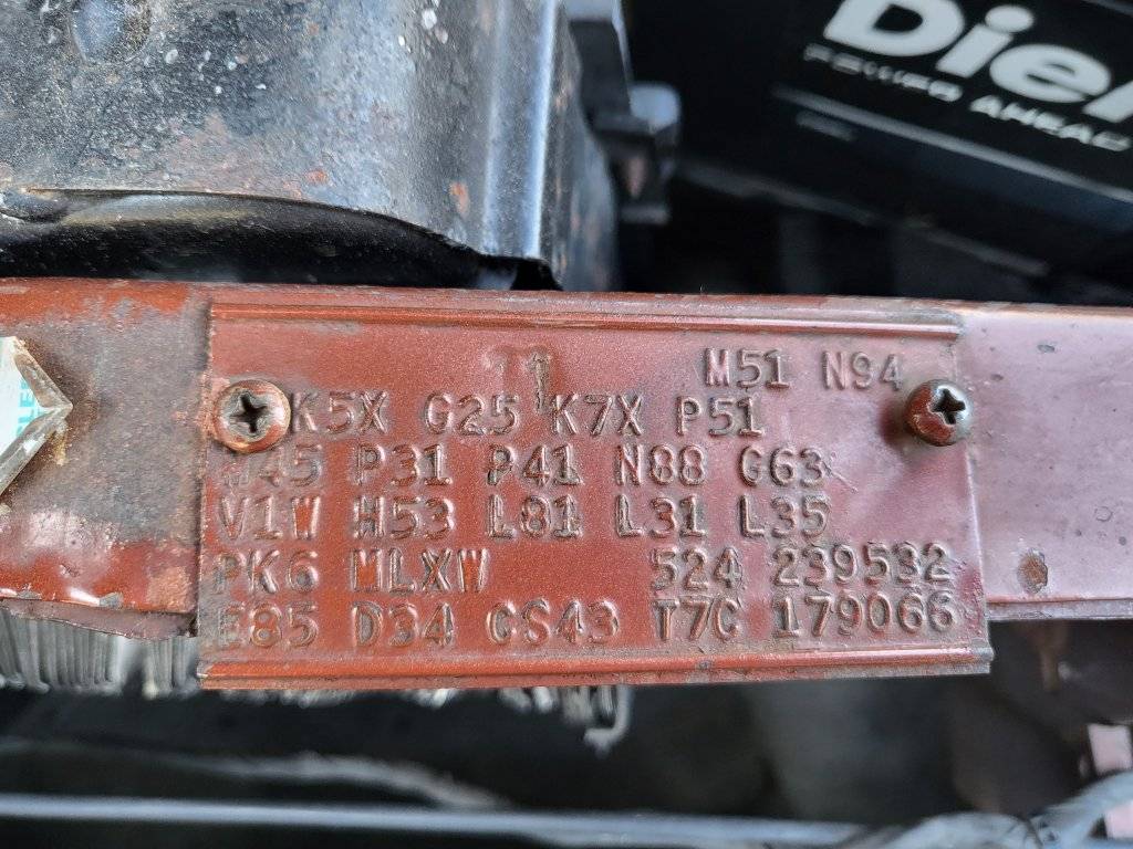

If the fender tag says K6, then that's the color.
Chrysler used the color codes across the line. If a Dodge or a Plymouth had K6 paint code, it would be the same color. It might be named different, but the same code and color.

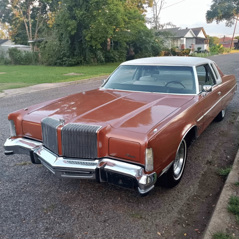

Wow, it's a 2-door twin. Looks like it's in very good shape but they sure are asking a lot for providing almost no information...
