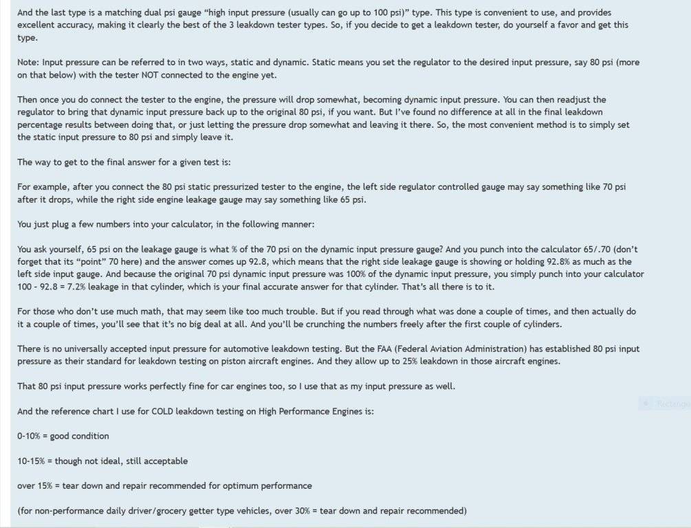

I’ve had experience w using differential compression testers on aircraft engines and it may be relevant (or not) to cars. One thing that affects readings is the size of the orifice between the high and low side. In aviation there are two orifice sizes, .040 for engines with less than a 5” bore and .060 for over 5”. It definitely affects readings. I understand that the tester for autos may have a smaller bore than these but I don’t know for certain. It’s important to have the correct tester for the job. Also its best performed the check on a warm engine and it was more concerning if the leakage was past a valve then if by the rings.
Differential compression used to be the holy grail of cylinder health in aviation but that has become less so recently. Maybe it because Continental motors did an engine test in which they filed ring gaps so large that the different compression read 0/80 and the engine still made rated horsepower! Differential compression is still used as a diagnostic procedure, but it’s definitely not the strict go, no go that it use to be for rejecting a cylinder as not serviceable.
