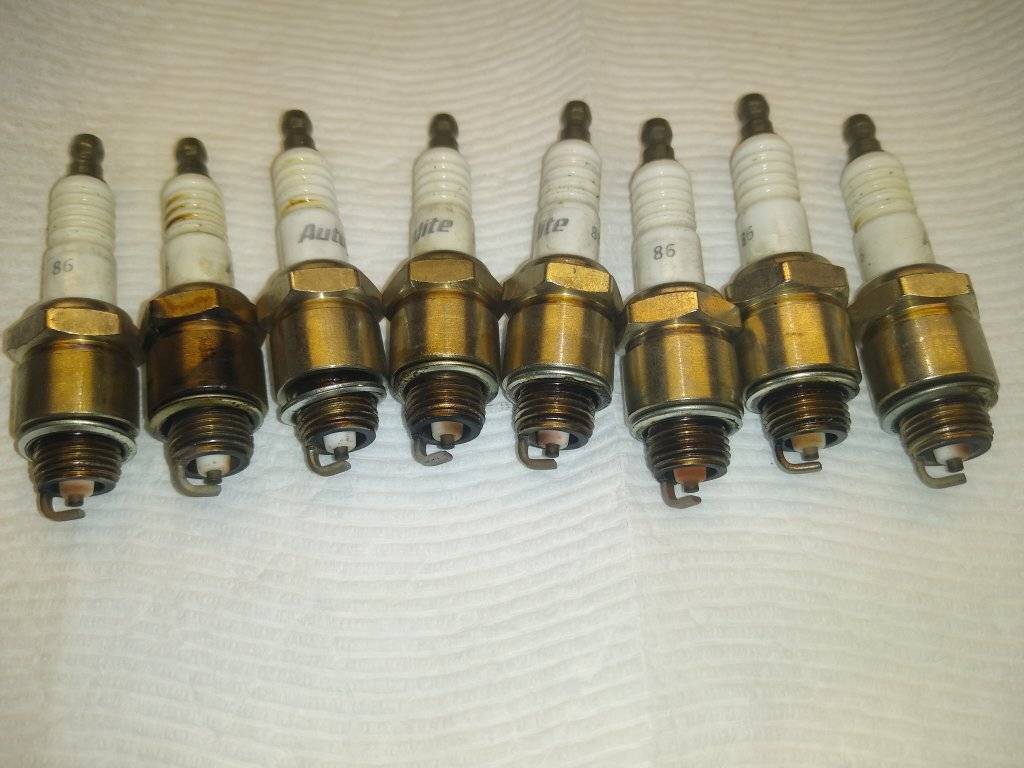

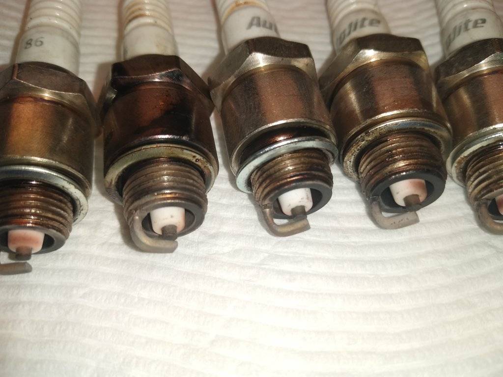

Thanks for that information. The plugs MIGHT be a little lean, but not terribly so. Put them back in and look at them in another 3K miles or so for the best gauge of things.
