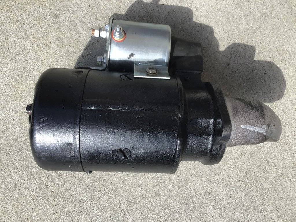

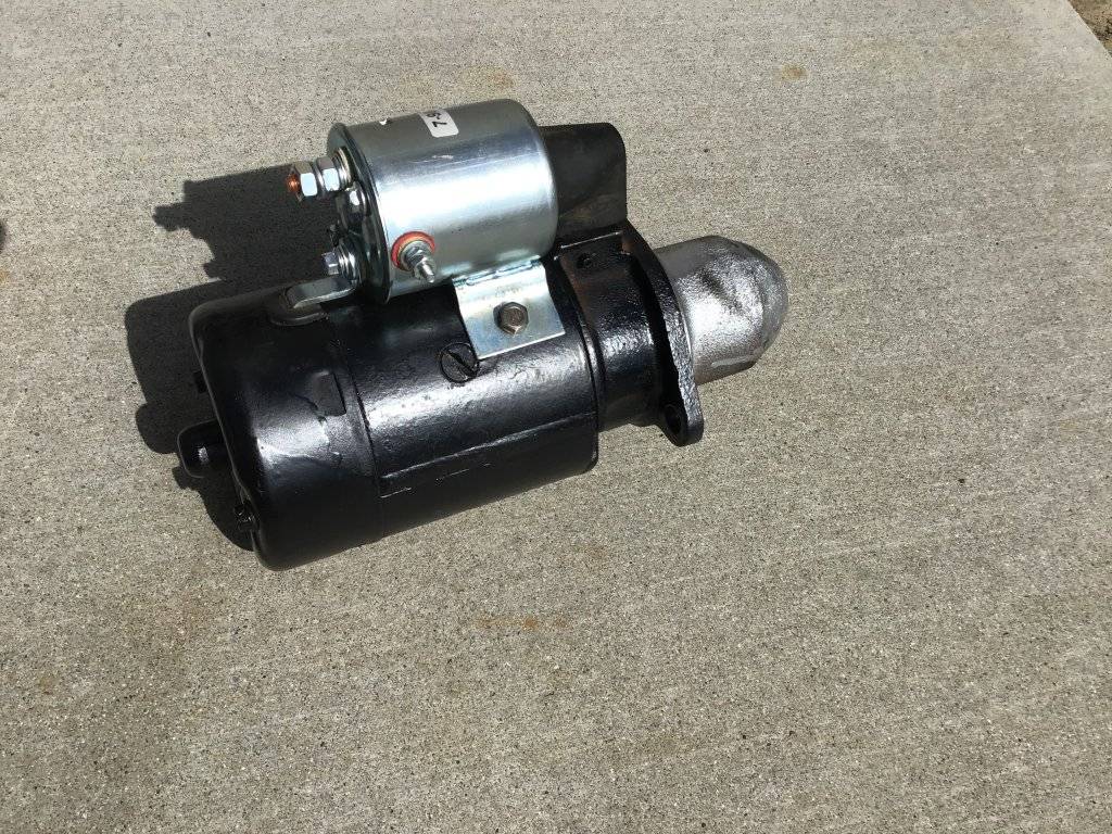

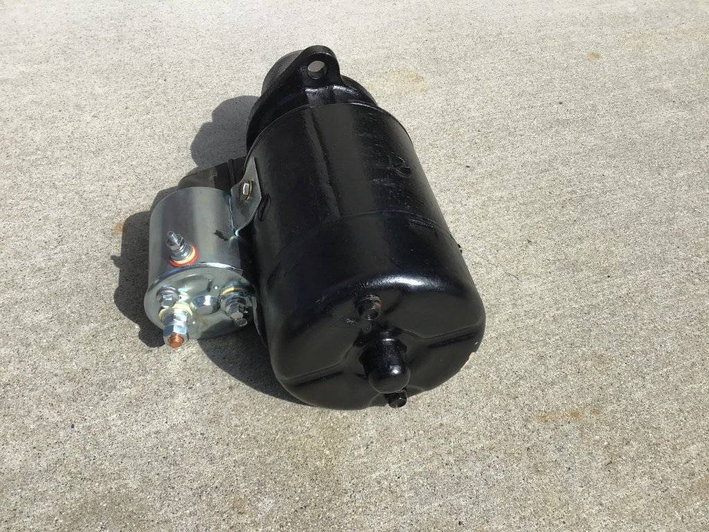

Never seen a 59-61 starter have you? That’s what it is. Below is a photo of my spare I had rebuild by a local rebuilder. Ready to go for when one stops working, you don’t get to be lazy and go the the corner store to buy one from china.
you see when I type things it’s because I have been there, I’m not guessing.

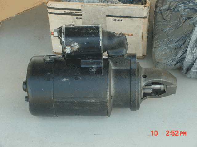

Hard to tell the stamped number on the pad. But I can see a P 41 then below and left side of pad might be 1030? Can’t see any other markings
That looks like the starter used in some stick hemi cars in the sixties. Also used in some early slant 6 stick cars.
If that were mine, I'd have that starter rebuilt. Yea, not as efficient as those girly starters they sell now, but the sound of that gear reduction starter is unmistakable and IMHO, would make the boat sound like it did when starting back when it was new.

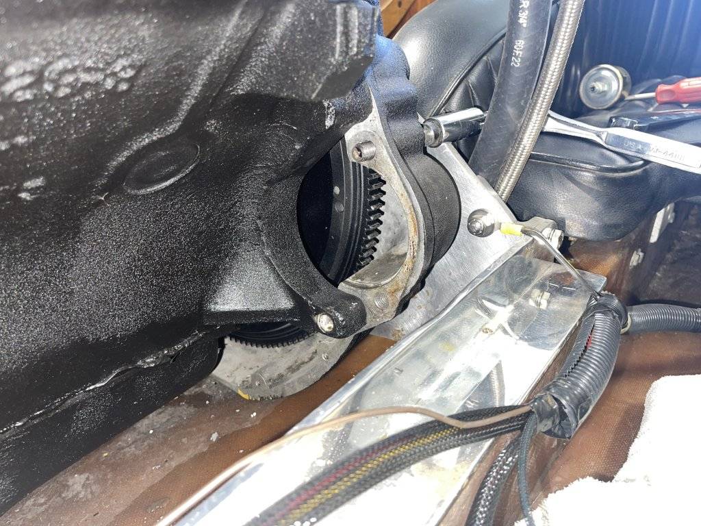

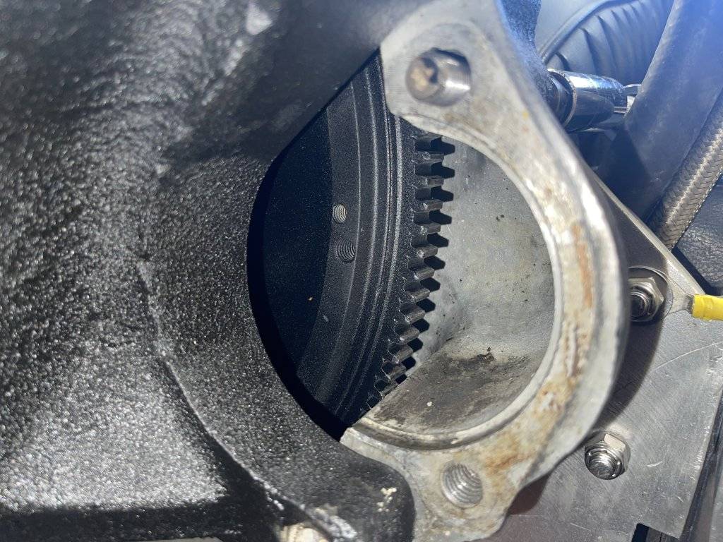

You might be on to something with the stick comment. Looking as best I can through to hole in the bellhousing, the flywheel appears to be a thick one instead of a thin flex plate that you would bolt a converter to. It is Steel as well.

Hi. Because the engine and starter are prior to 1962, please disregard my comments on starter compatibility.
1962 was the introduction of the Chrysler gear reduction starter which basically stayed the same through 1987.
Your starter was probably produced by Autolite.

Also, I know boats don't generally have transmissions. How does the starter set up behind your engine?

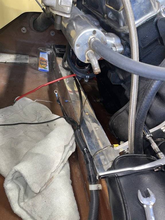

The starter mounts just as it would in a car. Here’s some other pictures. I took last night.
I really Appreciate everyone’s input. Thank You all. James
