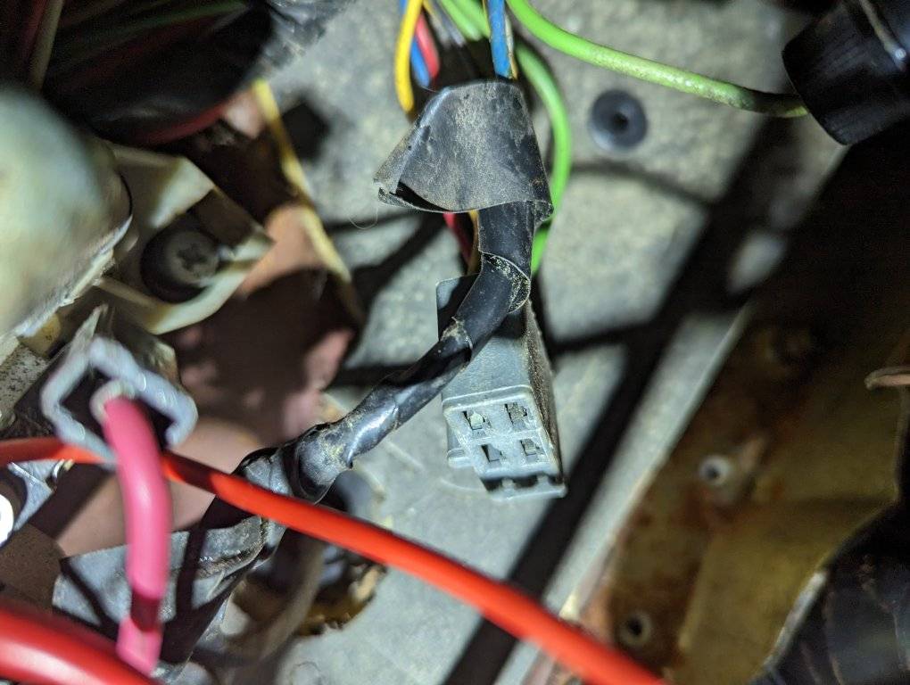

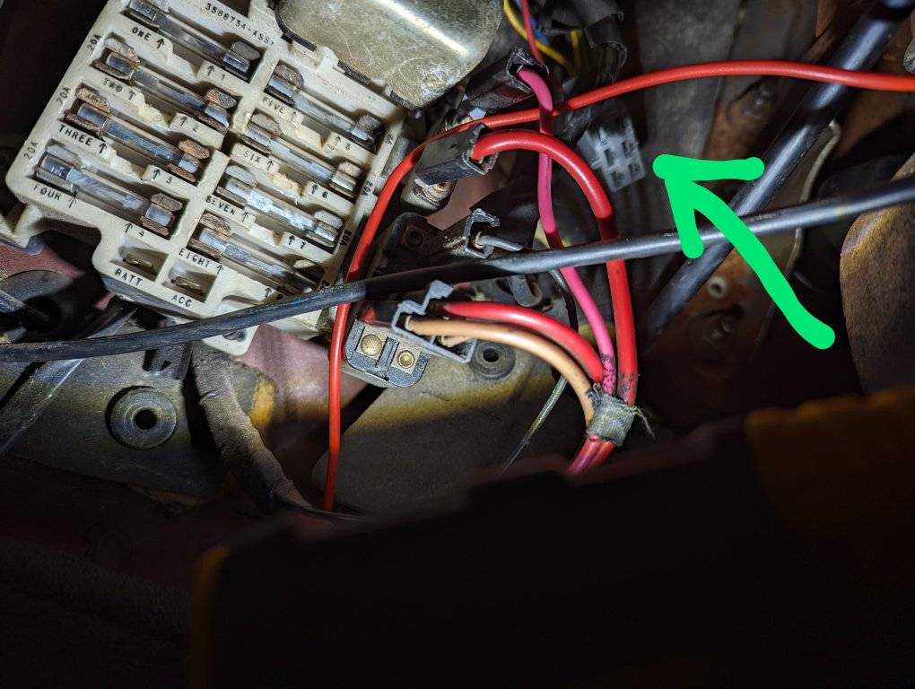

Hello, 1973 Imperial. I have this empty socket/plug under my dash, above the fuse panel. The grey with six slots.
Would anyone know what goes here?

Back to the primary question. What goes in the empty 6 prong plug just hanging above fuse panel?

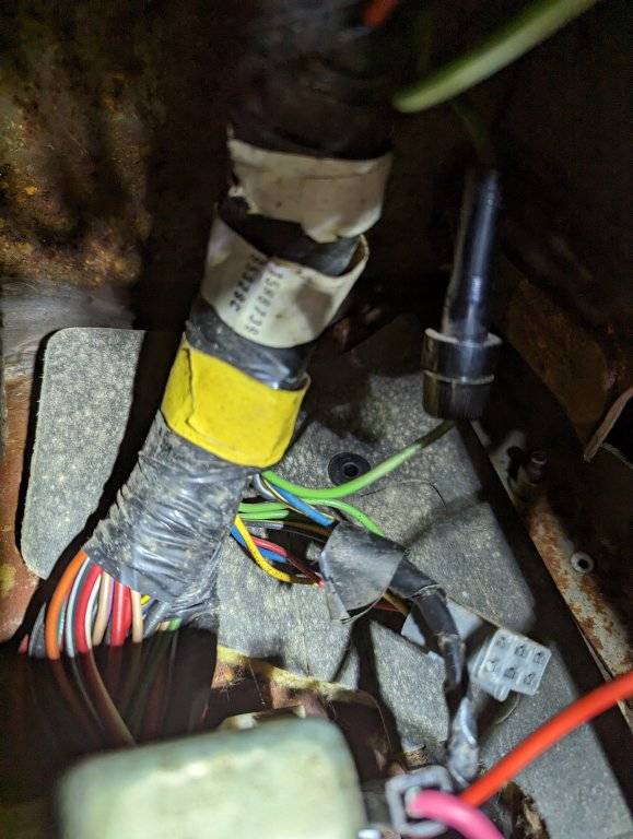

@Boydsdodge I have the same issue with the door buzzer like you. It buzzes as soon as I open the door, no matter whether the key is in or out. Really annoying. Did you find a solution to that issue yet? I crawled under the dash today and found the exact same socket hanging disconnected like yours... Since it's coming out of the thick harness off the dash, might that be the light wiring for the trailer? Since our cars don't have the towing option it's not connected to anything. That's my best guess..

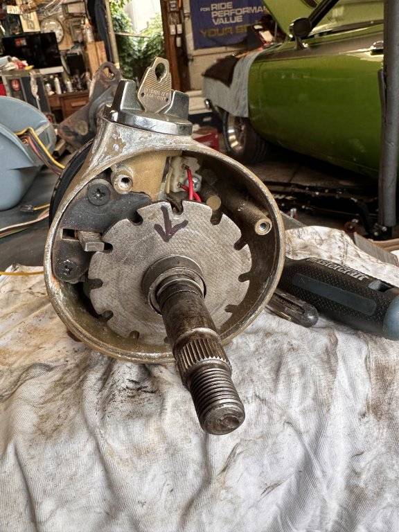

I haven't tried yet, but when repairing a clients steering column I could see how easy it is for the key inserted arm to stick in the key in position. The car thinks key is inserted and alerts. I will try some Deep Creep and see if that helps.
Very interesting picture. Is it enough to remove the steering wheel to get to that mechanism or is more extensive disassembling involved to it? I'm used to work on my low budget Pontiac Tempest and the upside of very few options is the simple design for everything. That's not the case for the high end Imperial obviously
This is a 73 B-body column. I haven't opened an Imperial column. Yet. The small white switch with two red wires is the buzzer switch, if I am remembering correctly.
