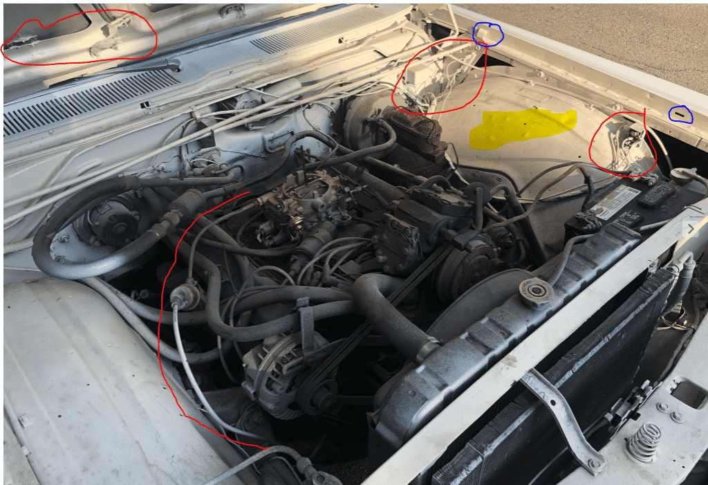

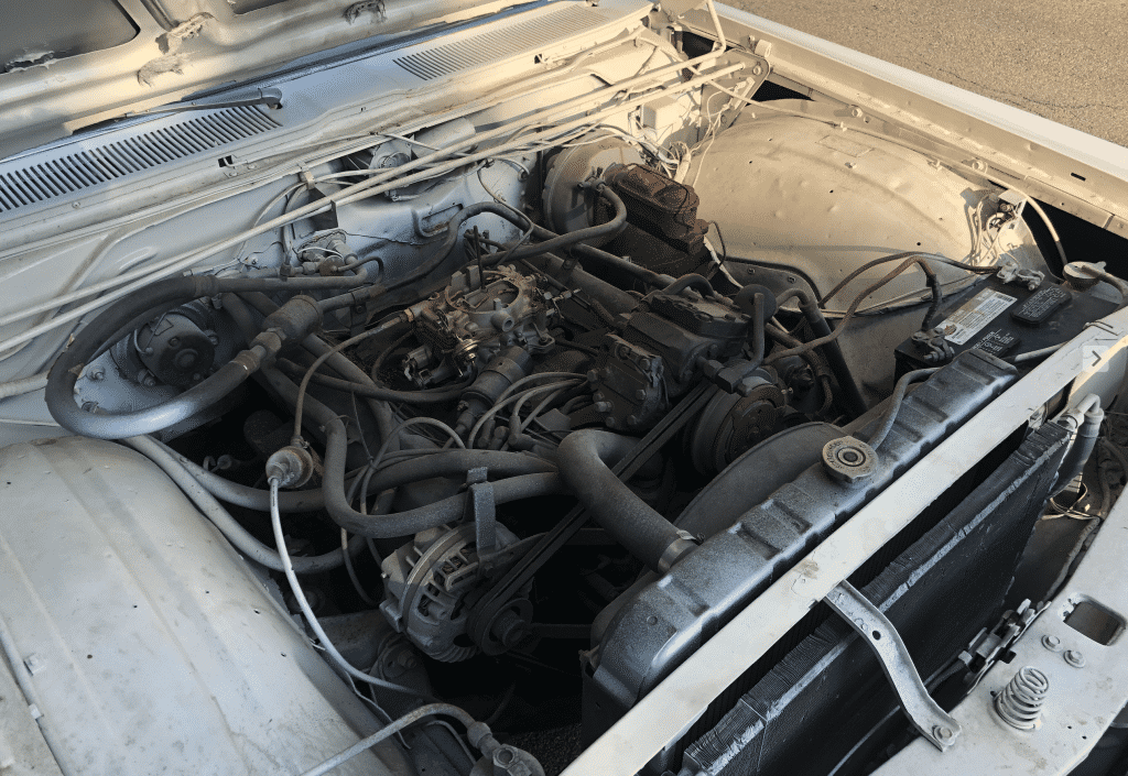

Engine compartment does have a lot of overspray. Windshield wiper motor, brake booster, electrical components on firewall, radiator, hoses, wheel wells...
On a 1970 Fury with white firewall, wheel wells are black. You can remove them and repaint them easily.
For the hoses, a little brush cleaner and silver paint might do the trick. Otherwise, you can replace. Overall, you may need a few days work to make the engine compartment look nice.
Overspray would lower my bid, but not cancel my offer. I was thinking $7000-$8000
Agreed that the overspray won't make me pass it up

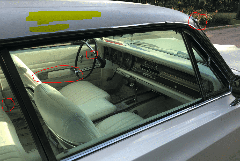

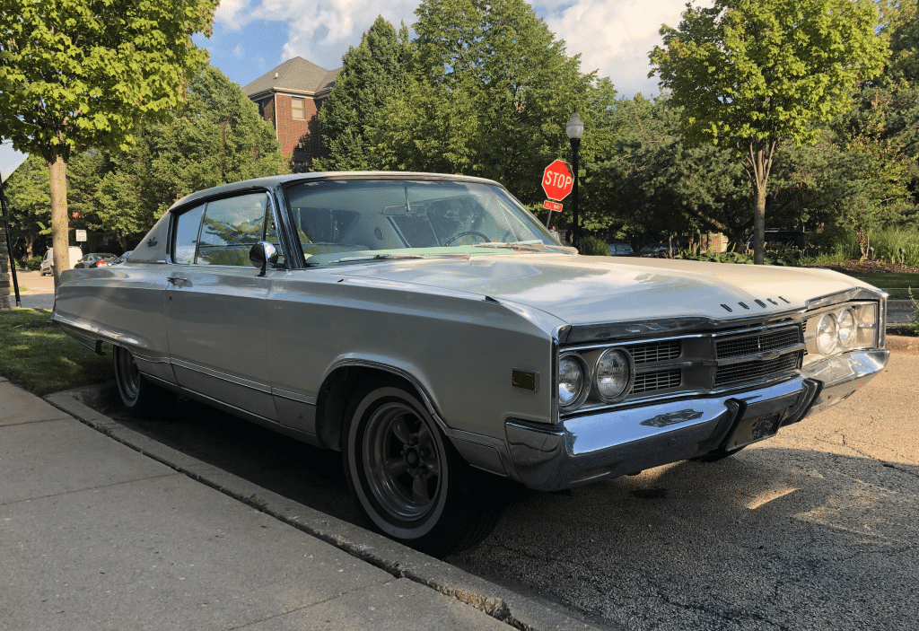

I'm generally pretty tolerant of flaws and 'incorrect' restoration on a car I might buy -- but I'd run hard and fast from this one.
Maybe I'd feel differently if I saw it in person, but what I see in these pictures is a perfumed pig.
It has so many signs of shoddy workmanship that I think the disappointments/bad surprises in this car would never end.
Unless there's a truly rust-free virgin body here, but I wouldn't bet that long-shot.
VT is wrong grain (not a big deal) - but what is hiding underneath? The top corner of the windshield trim is not installed correctly, which makes me question the workmanship.
The doorpanels don't look factory, those are trim shop cut-and-sew-some-generic-pattern things. Attached with screws most likely - one is circled. They didn't even get the bezel for the remote mirror on there, nor the one at the door lock pin.
As someone mentioned - the short armrest, and all the white on the dash.
I don't recall ever seeing a white console - so likely it was spray-painted with the dash. (that wouldn't be a big deal if it was the only oddity)
The seat stitching on the top shoulder-corner of the passenger seat looks funny, how all the seams meet - I suspect these seats have generic trim-shop-sewn covers that tried to emulate the originals.
Underhood is more of a mess than just the overspray on some hoses - all the wiring is painted.
Hood bumper is missing (no big deal) but the other one is painted over.
Top skin of hood seems no longer attached at the deadening-goo - I don't know if that's typical at this age.
But the insulation pad clips, and some of the insulation, were painted right over.
There's a cluster of upward-dimples on the fenderwell - I've never seen that before. ???
And in spite of all of that, there's not even any shine to the fenderwells or anything - so why do it???. So... I suspect a color change on this car, and a half-assed coverup.
Has a disc-drum master cylinder, does the car have discs brakes? Regardless, it's wearing a drumbrake booster, and that's a no-no if it has discs.
Fuel line routing is horrible.
What other safety/drivability shortcuts were taken?

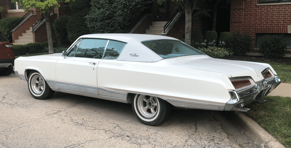

And it looks like someone installed JC Whitney side marker lights, but the only one left is on the right front. What happened to the others?
Right front wheel trim is wonky, and door gaps look odd.
At first glance, the car was very appealing, but upon closer look, it is scary.
And if it is in park, shouldn't the shifter button be popped up?
I hope the air cleaner was just removed for the photo.
Good eye on the door gaps, they are definitely too tight at the front.
Good eye on the shifter button, too.
I think that many of the things done on this car were performed without worrying about originality. The paint job looks like a typical body shop job that over sprays everything including under the hood, wheel wells, etc. The under hood can be made to look nice with some work and many things can be corrected with a little work as well. It depends on what you are looking for. This can be a nice driver, but I would want to do a thorough inspection. In the end it comes down to the price and to me it would have to be a good deal.
NOT to sound flakey, but after seeing what others have indicated, I can see about $6K of "corrections" that would need to be made for the car to be the gem it needs to be. Although the current seller might not be aware of all of them, possibly. And somebody did a lot of things that a little searching in the restoration/repro vendors could have prevented, IF they might have cared.
But as a possibly nice driver that looks good at a distance, it might do well, but NOT "top dollar" well.

I was a bit harsh on the car earlier, I think because the quality of work suggested people who did not take pride in their work.
I worked in 2 body shops when I was younger and that underhood would never have been permitted in either one, regardless of what the customer was paying for - the shop's name is on the work, a cheap price justification always gets forgotten.

Looks like the radio antenna is missing too. Maybe the car took a hit to the right front and the fender was replaced with a junkyard one that had the cheapo side marker light on it, and it was never removed.
If the body is not full of bondo, and the mechanicals are good, it could be a fun driver. Just pay accordingly.
I don't see a battery hold-down bracket, nor a windshield washer reservoir. It does look like a rad overflow reservoir is on the far side of the battery, I don't have one so I don't know if that's where it should be. None of the wiring that should run (and be clipped down) on the wheel cowls are there.

Good eye. I also saw the dimples on the fender well, but missed the other flaws you discovered. Yeah. It's gonna take a lot of time and money to straighten out this car.

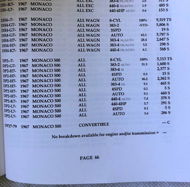

I just bought a Canadian 67 Monaco 500
L code 440 car.
In perfect show car condition they fetch 20k. My insurance has an agreed upon replacement value of 32,000.
I paid nowhere near that.
The car in question get the VIN tag and fender tag to verify the engine and which assembly plant she was born.
Both the H code 383hp and L code 440 Magnum cars are rare beasts and worth buying.
