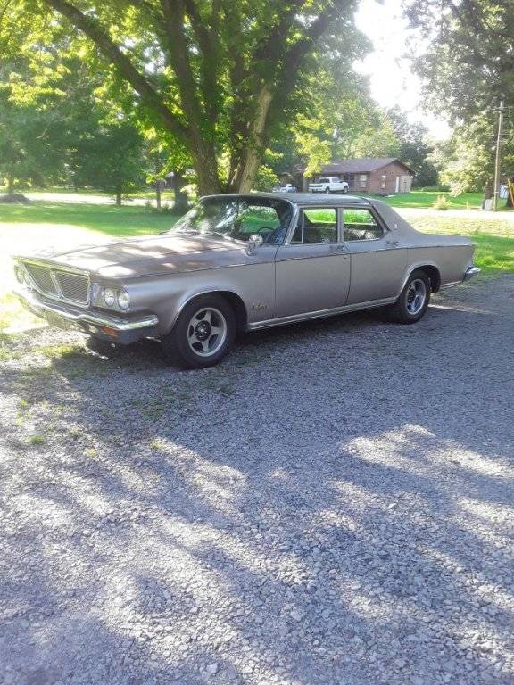

The paint on my 64 is, well thin.
It was Rosewood. Now it's a thin faded Rosewood giving way to a very nice red/brown primer under that, as seen on top of the fender and hood.
So. The answer is, thin.
