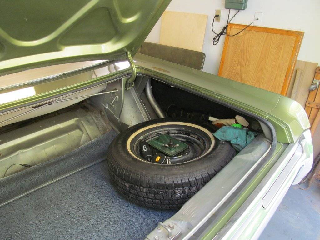

Ah-ha! Look what's to the right of my spare tire! Uh, I have one too. Ha! I knew I had these pictures at my home.
