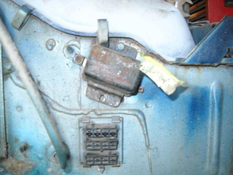

quick question what is this part is it the alt regulator? or the starter solenoid? DSCN1254.jpg
Wow, I forget how much I take for granted about this stuff. Even when I was 15 and just started looking under the hood of these things I knew what that was, I guess it helps starting under the hood of a 1955 Chevy.
Alan
All chrysler starter motors from about 1962 on have their starter solenoid built in, the solenoid part is the half dome lump that the two wires go to. Hope this helps, cheers.

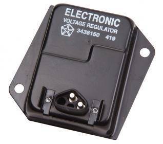

sorry if I sounded a bit dumb but these are what I thought voltage regulators look like 77r06286.jpg
Thats the later model regulator that replaced the unit you see in your car from about 1970 on, the box type is a mechanical regulator.
yea that's what I have on my dart and have a bunch of those laying around I never saw the old type before
