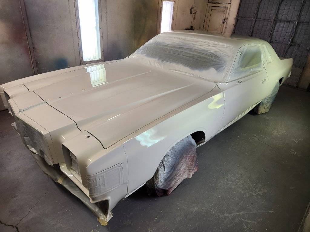

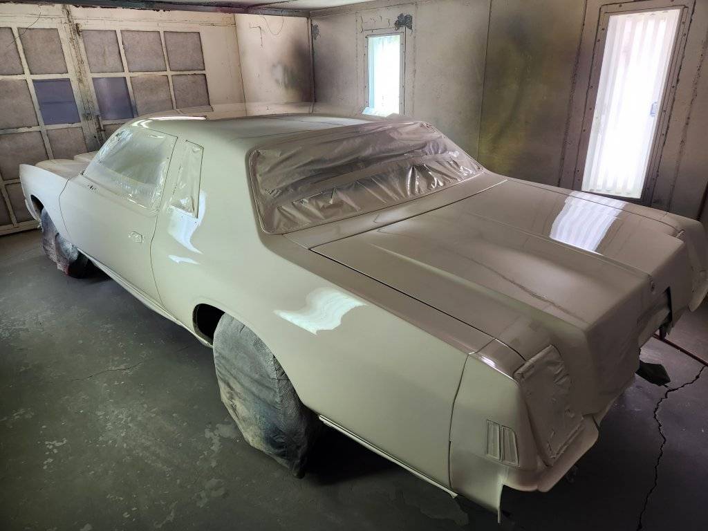

Well don't know if I can help but I can sure give you my opinion. On a solid color there's nothing wrong with using single stage. It may not quite have the depth of BC/CC but pretty close. If I'm spraying a metallic color I will only use BC/CC. I painted my 79 300 with a lower level single stage white acrylic urethane and most people are surprised when I tell them it's single stage.
