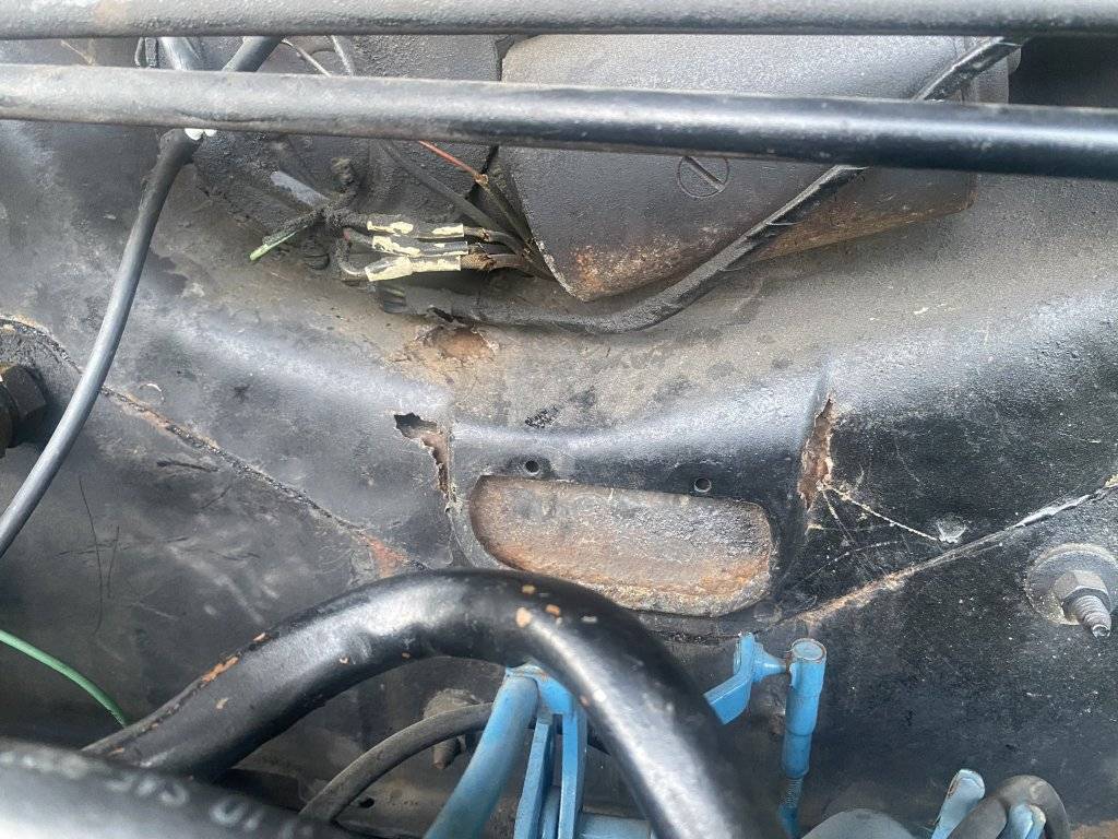

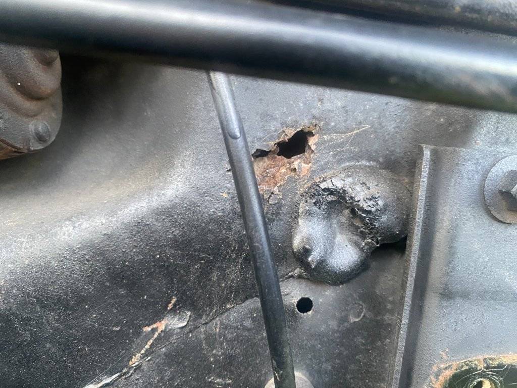

Somewhere between “replace the entire firewall with a new panel” and “do nothing” exists the solution I will employ. This car is only driven in fair weather, so honestly, there won’t be water getting near these areas except when I wash the car. My current thought is either plug those holes with the black roofing tar that goes in a caulking gun or use some HVAC tape to cover over the holes and spritz with flat black paint. I’m NOT replacing the firewall and I’m not doing “nothing.” What would you do? It’s bad around the wiper motor but worst along the passenger side inner fenderwell.
That large oval hole in first pic is a cowl drain. Do not plug that. A rubber flap covers it, mount ps in thos 2 small holes above. The rust hole next to it goes insode the cowl drain area, can leave it there.
The other holes are going inside the cowl drain area. No need to plug, the drilled hole goes to the interior.

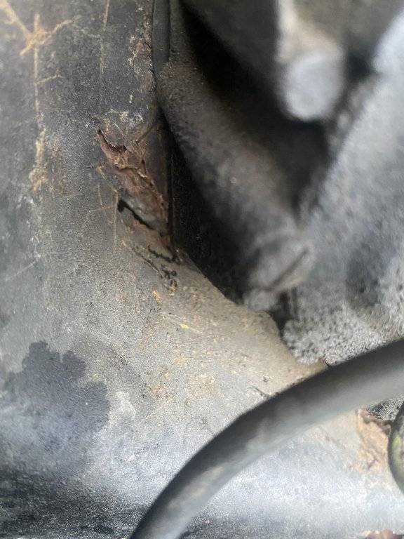

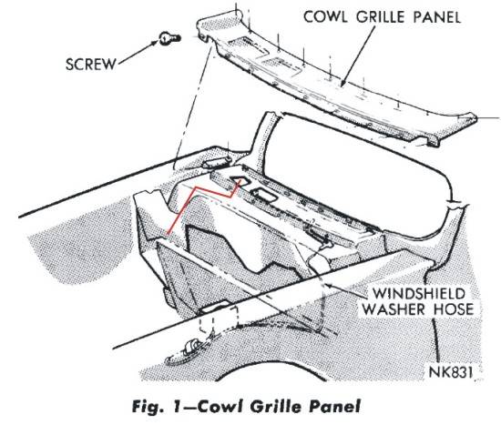

Can someone answer this - is there a path that water can take (along the red line) to get to the seam that is rusting out behind the inner wheel fender?
Yes, that whole area is open behind the upper firewall panel.
That rust is quite common from leaves, or worse, pine needles, collecting in the cowl.
The good news is those rust holes don't cause water to get in the interior, unlike the B and E cars where the rot is usually on the inside panel.
I would clean off as much of the rust as practical. Back up the larger holes with some fine metal screen, then fill over the holes with long strand Tiger Hair. That repair will last a long time on a car that doesn't see much wet weather.

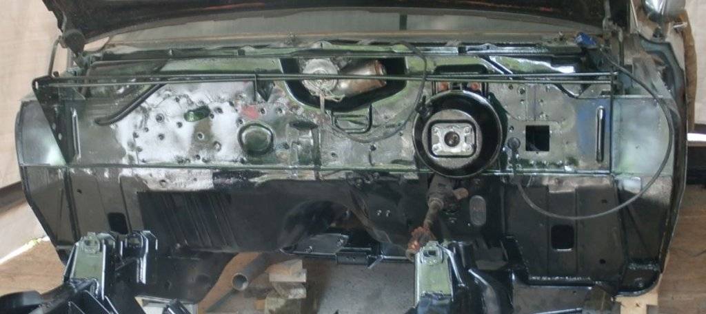

That's a real head-scratcher why some cars would rust there. Mine apparently didn't, the entire firewall was in great shape. This photo taken last July after going at it with wire wheels taken down to bare metal then painting the lower area with black DOM-16 (POR) and the top half with epoxy primer then 2K out of a can).
I did have one or two very small rust-through areas under the wiper motor area, about the size of a dime, filled them with body filler.

Does the COWL GRILLE PANEL come off without removing the hood?
Thanks for all of the great suggestions.
Yes.
Remove the wiper arms first (that's a bit of a trick). Then there's the trim that runs right at the base of the windshield, it's held in place with about 4 - 5 clips on each side, just need a tool that goes under it and pry it up. There might be 2 screws - one on each end that you'll have to see and remove when you open the front doors. Probably also remove the windshield-washer-squirter nozzels. Then it's either philips-head screws or small 5/16 hex screws and the cowl comes off, you'll have to maneuver it past the wiper arm shafts. I took mine off without taking off the hood.
