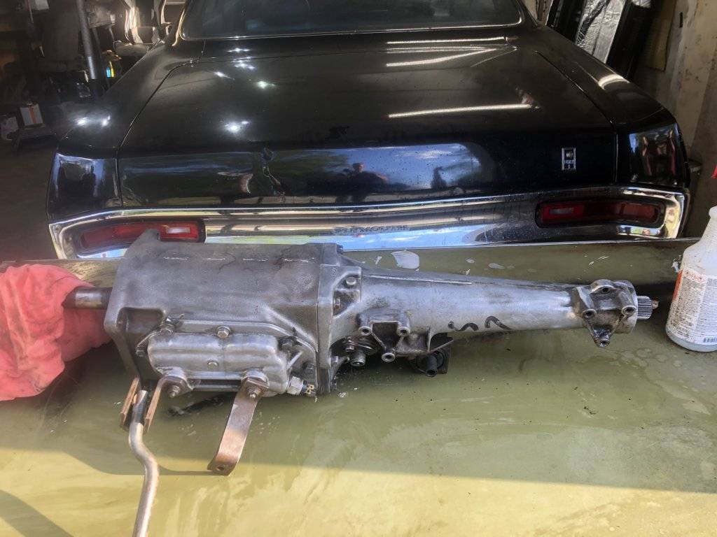

I have a 1971 Fury I with a 3 speed manual transmission. What type of ATF that is available these days is the best?

Probably ATF...What does Passon lube consist of that makes it so good?
Seriously, I think a lot of stuff is just rebranded generic fluids and sold as "special sauce". Same with generic store brands. Walmart doesn't make its own oil.so thats why Redline MTL is red....
Tremec trannys use Dextron ATF, like the T5.... for context.

I had a trans builder tell me years ago that a manual trans that takes ATF can be filled with engine oil. I have used 10w30 in GM T5 manuals, later GM manuals take synchromesh like Mike posted. I used to service a customers Honda Accord with a manual trans and it used 10w30. He wanted it changed with every engine oil change.
My owners manual says Dexron but what do they know!I would not use ATF, I would use gear oil, and that which is called for by the FSM.

Then use it and be blessed. If it says to do so there is no problem is there?My owners manual says Dexron but what do they know!
