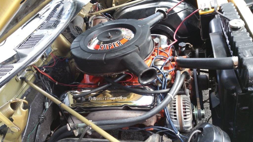

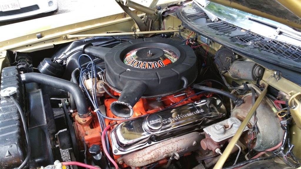

Here is a pic from the other side. I don't know if it will confirm anything. Looking at how high the manifolds rise on the valve covers ,,maybe they are . Never occurred to me. From this pic it looks like the manifold could really cook the oil inside the valve cover.

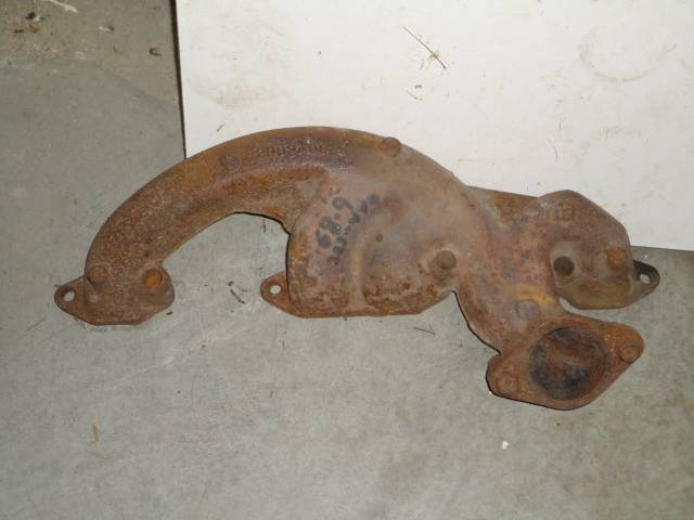

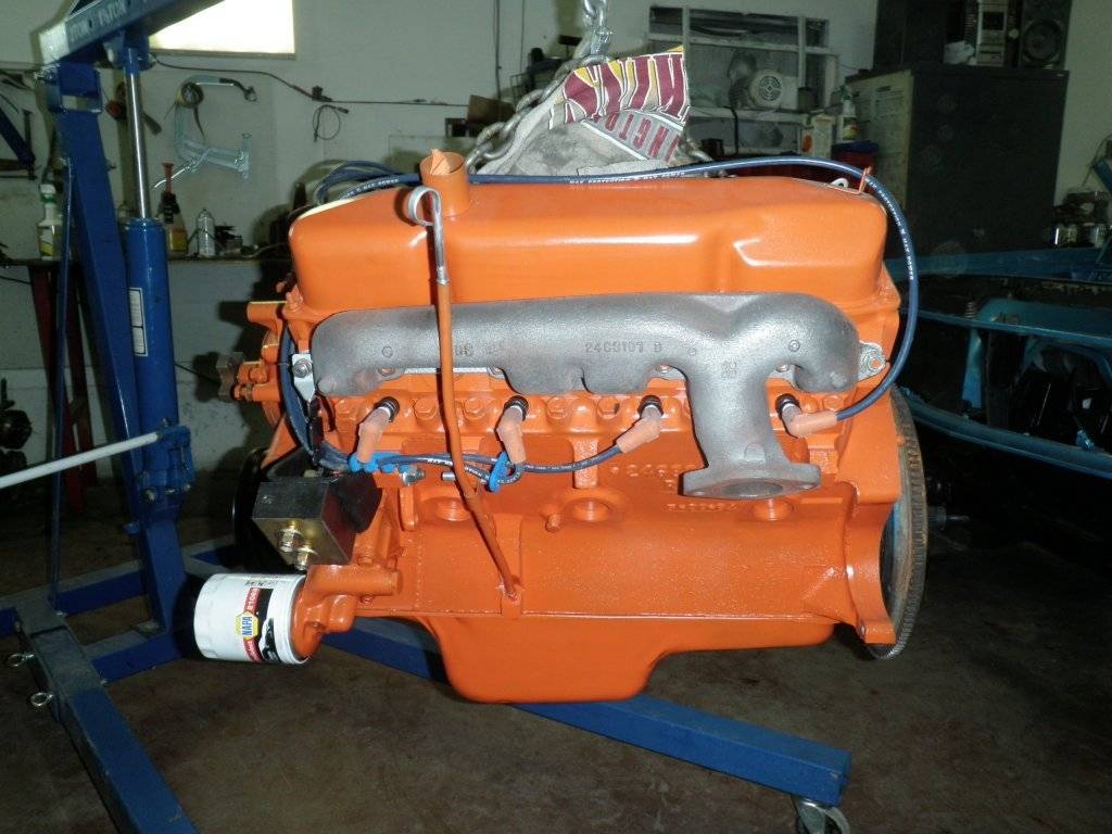

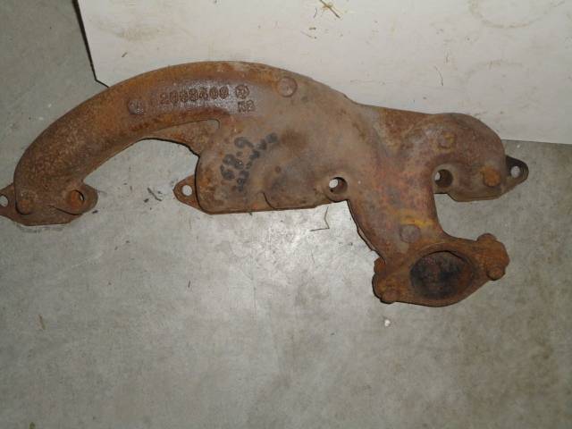

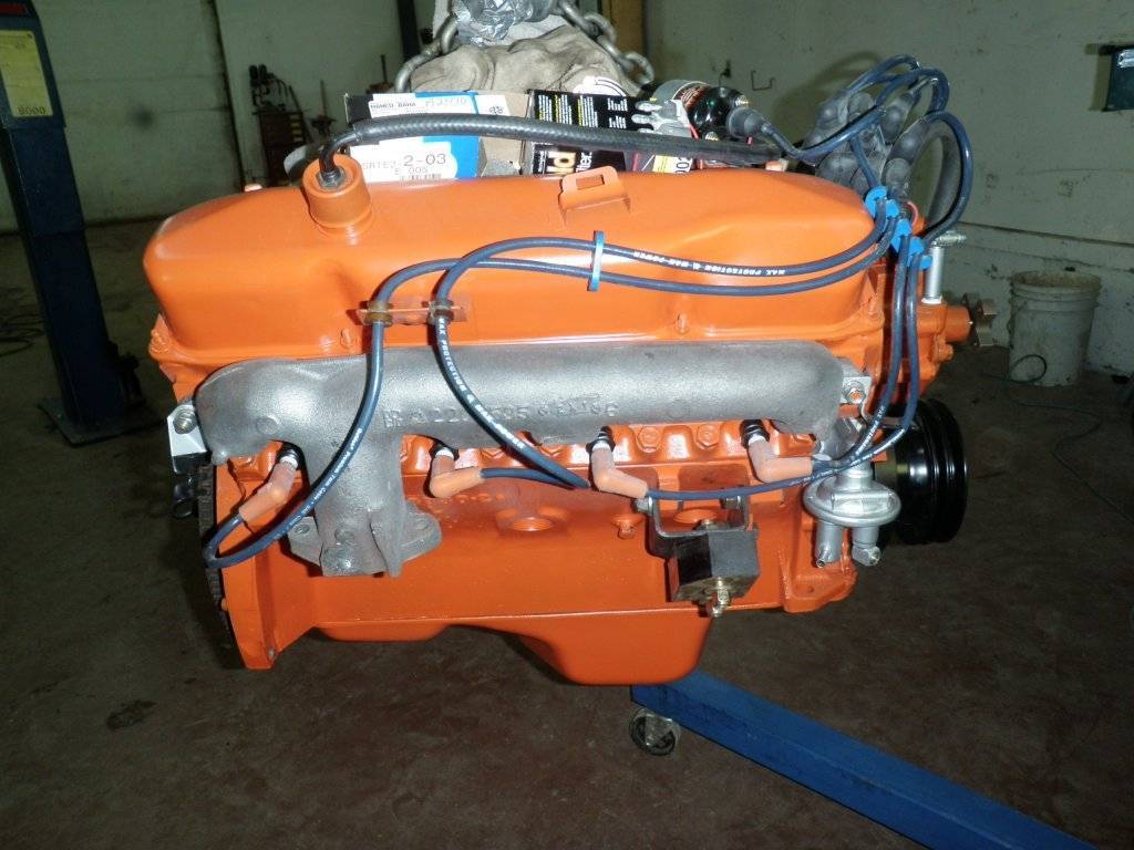

look at the number in the picture. The HP is 2863409. The log is 2463107( 66-69 383-440 LP driver side)

Dual snorkel, Super Commando, hi-rise exhaust manifolds....
It should be fairly obvious.
318 big block Max Wedge Hemi. :p
