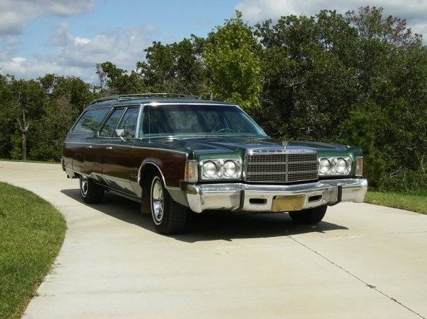

1977 Chrysler Town & Country always kept in good tune. Specs:
T code 440 thermoquad dual exhaust, 727, 2.76 open diff. De lean burned using ECM dist and wiring from 74 Imperial (done before the Mopar kit was out there...or at least before I knew about it).
Weight 5050 lbs (3 seat wagon).
Mileage Hwy: best recorded-19.1 mpg routinely get in the 18s.
City: best recorded-13 mpg routinely get in the 11s.
This is the best mpg C body I've ever owned. I honestly don't know why it does so well.

Thermoquad and a sensible right foot.
