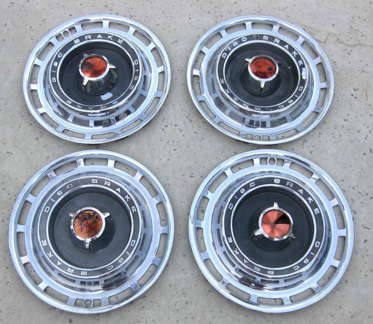

I was looking at a sales brochure that I have and it seems like they had hubcaps for 15" wheels. Other than the brochure I don't think I've ever seen them. I've seen you guys talk about "disc brake" hub caps, is that what I'm seeing?

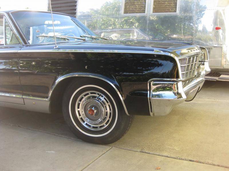

These are the 15" wheel covers I think you are referring to. I just did this swap. I got the later 15" wheels from a LeBaron or similar for about $35 each at junkyards, then used these wheel covers.
I actually have an extra set of these wheel covers (driver quality) over on the for sale board.

I found some that were 7" wide. As Wolfen said, you can find them on Dodge vans, but I got mine from a LeBaron M-body.
I am using Hankook Optimo H724 Tires in the P235/75R15 size. They have a 3/4" whitewall and are $67.50 at Walmart (I had them shipped to a local store and installed by my independent tire shop).
