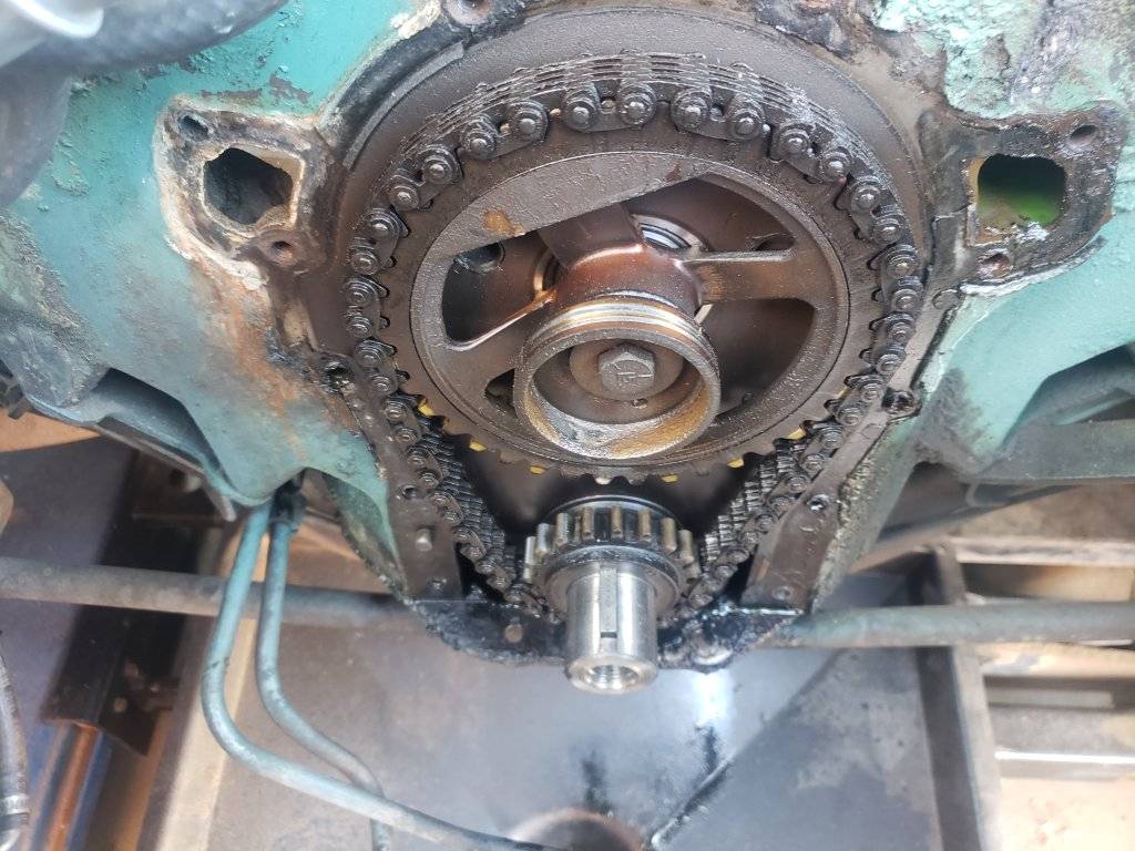

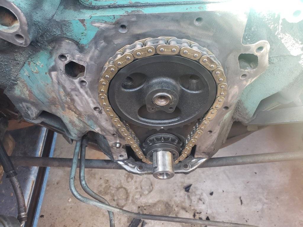

64 Buick 401 75,000 but almost 50 years old. New chain tighter than a hookers hold on a 100 bill.

I did replace it with a Cloyes double roller, because that's how I roll, but it wasn't causing a problem after 30 some years on the job.
