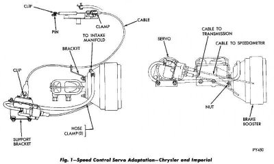

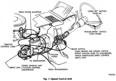

Feb 12, 2015 #2 vdk2010 Senior Member FCBO Gold Member Joined Sep 26, 2012 Messages 3,747 Reaction score 5,862 Location Frankfurt, Germany You will need more than just the servo, of course. The FSM show you all the parts needed! The 1969 assembly is similar, but the FSM picture shows a better overall view of the installed parts. Try Murray for the parts. (www.cbodies.com) I have photos of all the similar 1969 parts I restored if needed.
