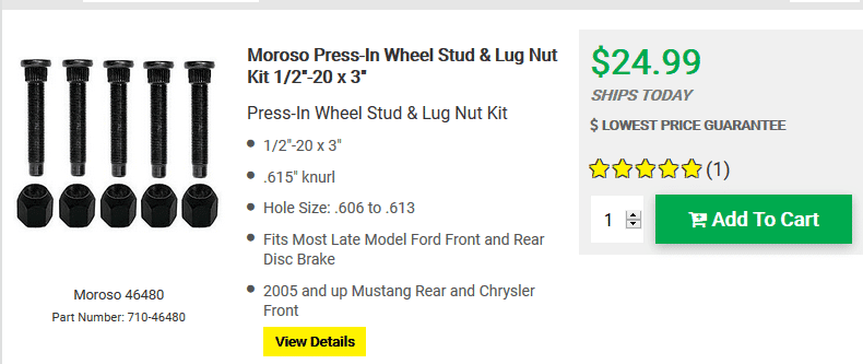

Which ones did you get ?
Moroso product
Total of 10 studs with wheel nuts(not needed for my self)
These were forthe front 73 discs i installed.
I would take vernier calipers and measure the diameter of the existing stud then go for the closest larger diameter.
Also look forthe length but watch out for the open end and how much it appears to be.
I found a number of wheel studs claiming to be 2 1/2" in length but in reality the useful section was much shorter.
To install
I ground the knurling down ever so slightly to make it easier to install.
I then used an impact gun to pull them into place
worked like a charm!
I think my point is that the www.jegs.com has a very good selection at a good price.
I apologize if I misled anyone watching the thread.
I use the Moroso studs with good result. I HAD to for a couple studs on my rear hubs, which had been worn out too much for stock studs. The larger knurl on the Moroso studs made a perfect fit. I also cut the length down nice and careful with a grinder, just to match the stock length. I highly recommend them.
