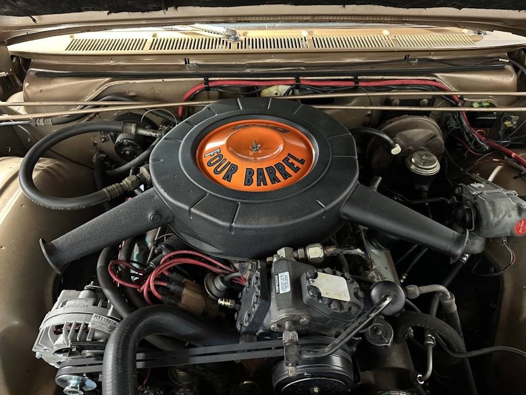

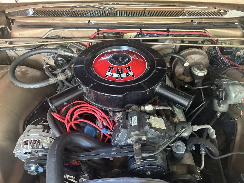

Hi guys... Need some help here. I've owned my New Yorker now for almost a year and since taking ownership, I made a couple of modifications. The addition of the radial tires, dual exhaust and a dual snorkel air cleaner. Yes... I know the air cleaner is not correct and actually located the correct 1966 440 TNT air cleaner on ebay and it is ordered and on its way. In addition to the sight modifications, I have added about 2,500 carefree miles on the car, and it has performed beautifully. That said, my wife and I are about to embark on a longer road trip and as luck would have it, the AC stopped blowing cold. I took it in for a diagnosis today and discovered that the compressor is no longer working.
My big dilemma.... Should I replace the stock compressor with a rebuilt RV2 compressor and convert it to R134 or get the parts together and swap in a modern Sandon style compressor? I know the new style is more efficient and doesn't use has much HP to drive it... But will it cool better? The car has way then enough power and I can't see how I'd notice a 5 HP difference. Your advice will be greatly appreciated.
Classic Auto Air rebuilds the compressors. Find some R12, it's out there, swap meets, garage sales, ask all of your car buddies, older parents might have some on their back shelf. and the RV2.
Well after a lot of thought, help and advice from all of you as well as my classic car buddies, I decided that I'm going to stick with the RV2 set primarily to keep the stock look and nostalgia of the original equipment. I pulled the trigger and ordered a rebuilt compressor from a reputable rebuilder on Ebay. I've sourced the R12 refrigerant and should be good to go in a couple of weeks. I think the stock compressor is going to complement my correct, newly sourced and installed 440 TNT dual snorkel air cleaner.
Good choice.Who did you get the compressor from?
