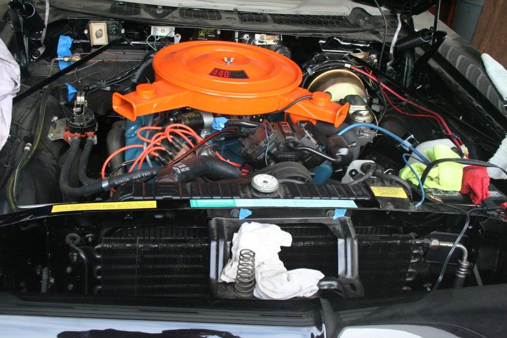

Trying to figure out where my 1972 440HP came from. ID pad is H440 HP which is obvious
Oil pan rail number is 2FXXXXXX - From what I am seeing on the webs = 2 door, F - Newark Plant ?, 2 ( B-pillared hardtop) ?
It also has a C-body oil pan on it. Previous owner said it came out of a C-body before it went in his Cuda....
Thanks in advance for any help.

From what i gather the last 6 digits are the sequence number. 2F would indicate a 1972 dodge polara or Plymouth Fury, as F is Newark Delaware plant. If it has an HP stamp and C body pan I'd say it's a police car plant. It should have a windage tray i believe, that'd be another thing to check for.
My dad use to own a '72 Fury III, for example, it was a motor vehicle scale car and a U code. It's engine would've had the HP stamp and 2F201942 on the oil pan rail.
