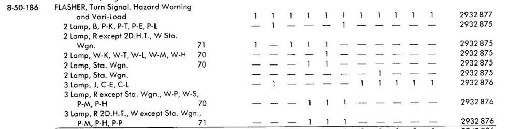

So I'm pretty sure I need a new turn signal flasher. I am unsure what I need for my car. 1970 Sport Fury with turn signals mounted in the hood. Does anyone know? Is it 2932877?
Essentially my turn signal switch still works. But the don't flash well and the great under dash "click" when you turn your signal on no longer clicks. So is this flasher on/near the fuse box or under dash?

Both flashers are identical and have two connections. Pretty generic too.
Go to your local Advance Autozone NAPA store and buy either a regular duty or a heavy duty flasher. The difference being a HD flasher is needed if you had additional lights, like on a trailer. It also will flash with a light out, something a regular flasher won't do.
If you want to know which flasher is which, turn on your emergency flashers. Grab the flasher and if it's clicking, it's the emergency and if it's not, it's your turn signal flasher.

So as an update: received my NOS Mopar flasher. Took the old one off, which ended up actually not being old at all. It looks like a brand new Chinese made one was installed in the not too distant past. Installed the NOS one. Works great.
I guess the moral to the story is, as stated above: skip the Chinese made junk if at all possible. I might actually pick up a spare NOS Mopar flasher so I have one handy when needed.
