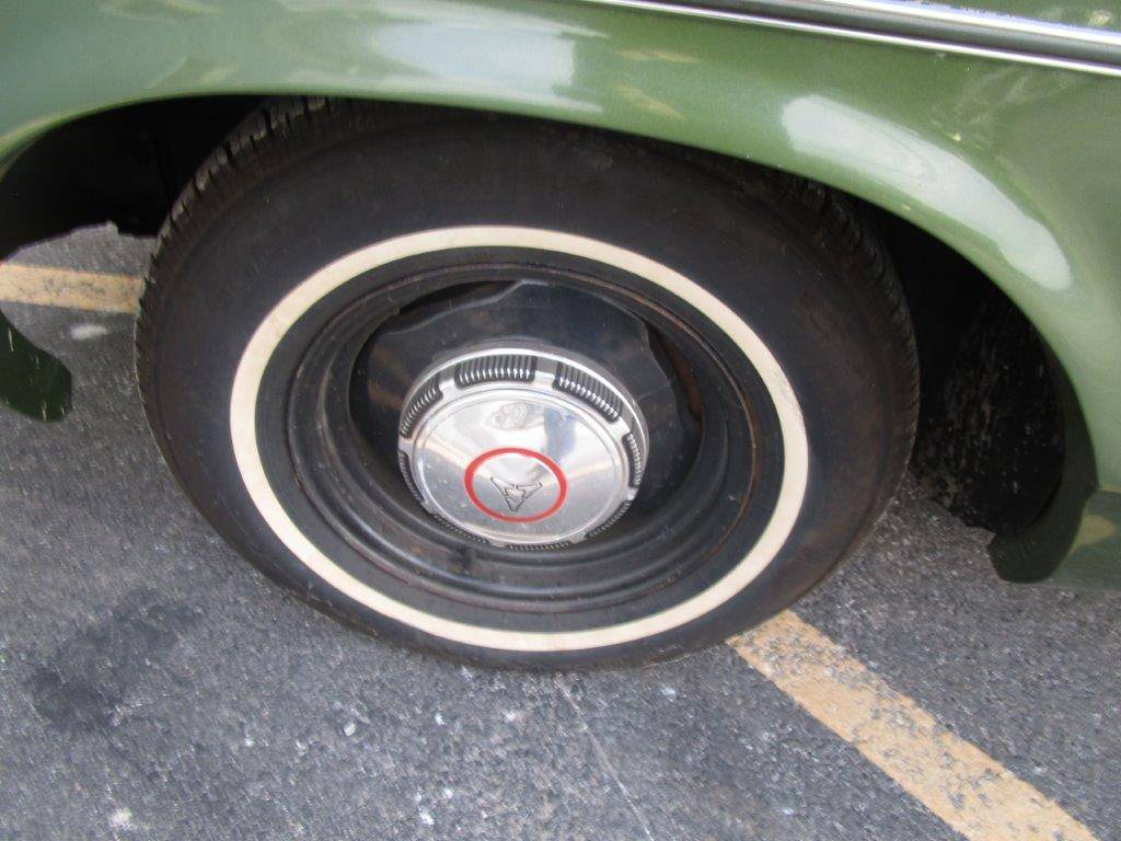

- Currently has 15x5.5" black steel wheels and Dodge "redline" aluminum poverty caps.
