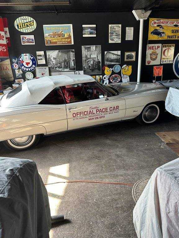

When I purchased my '62 Chrysler 300 Convertible about eight years ago, I tried "Fantastik", 409 etc. and still had some embedded dirt and used a stiff nylon brush. If you cannot get it clean, consider white liquid shoe polish. Dump it in a plastic bowl and use a 1" foam brush. After going one direction, go the opposite direction after the first coat dries. It has never come off and still looks great.
With age and exposure, the "white" can become a bit dingy that probably no cleaner will remove or bleach out. Hence, the white shoe polish can be a great alternative.
