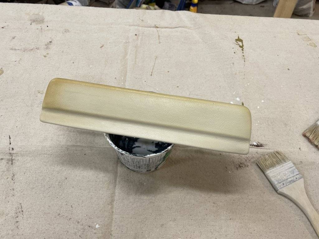

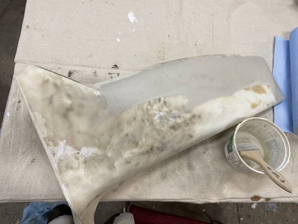

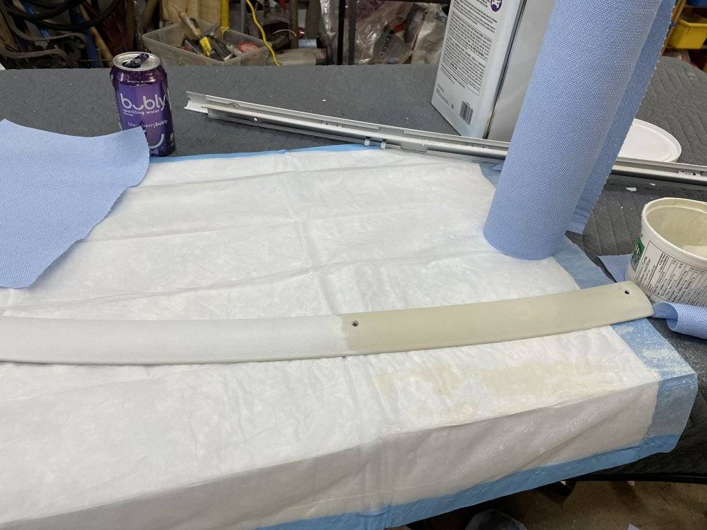

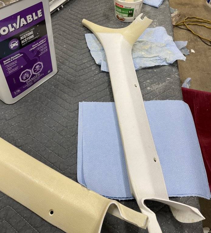

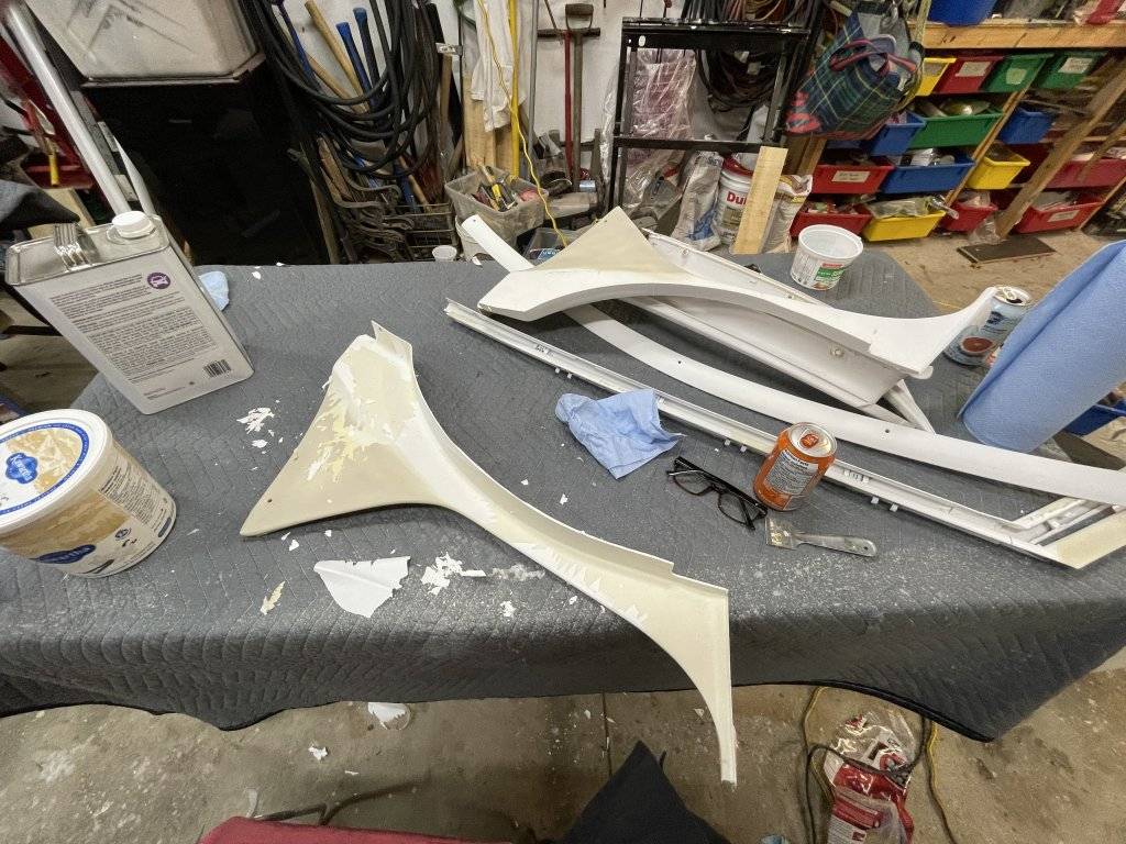

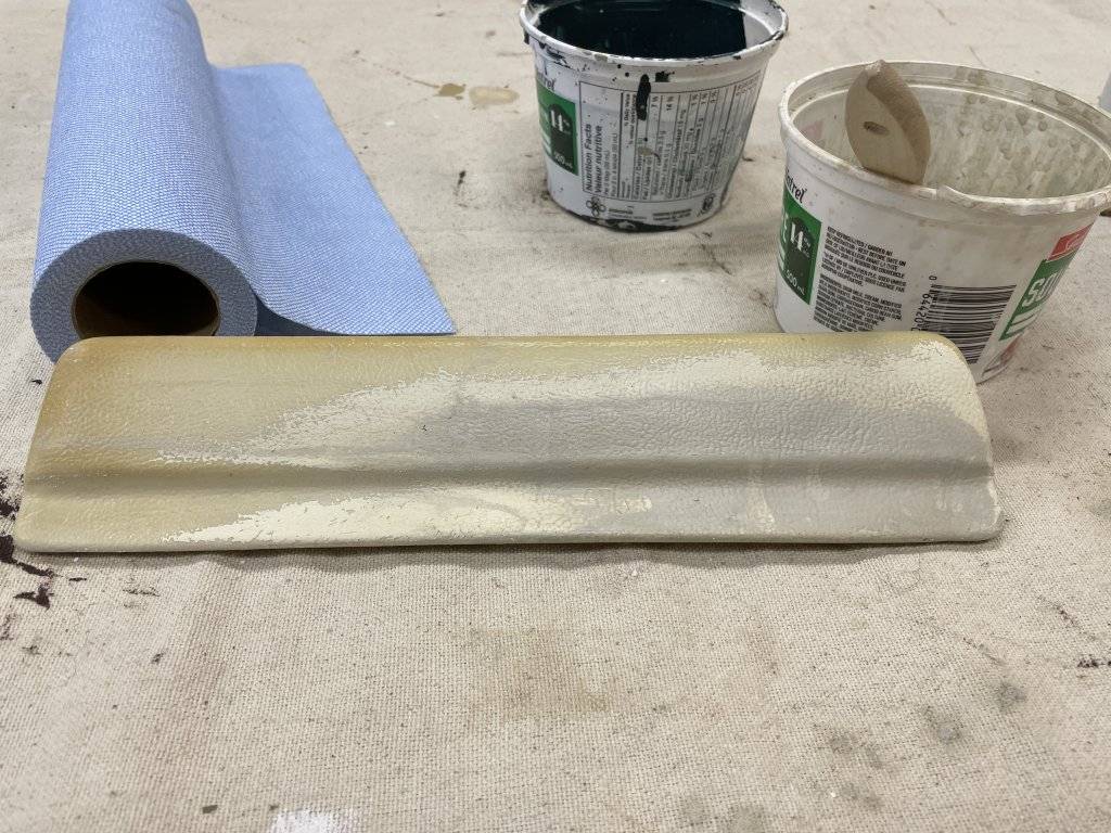

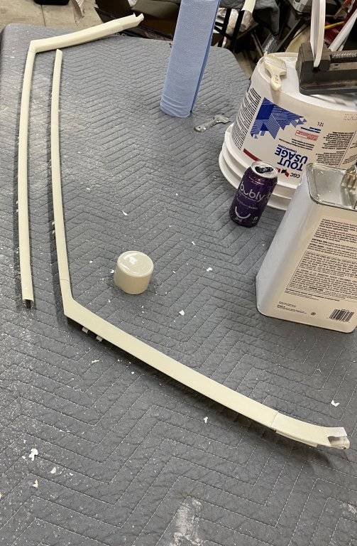

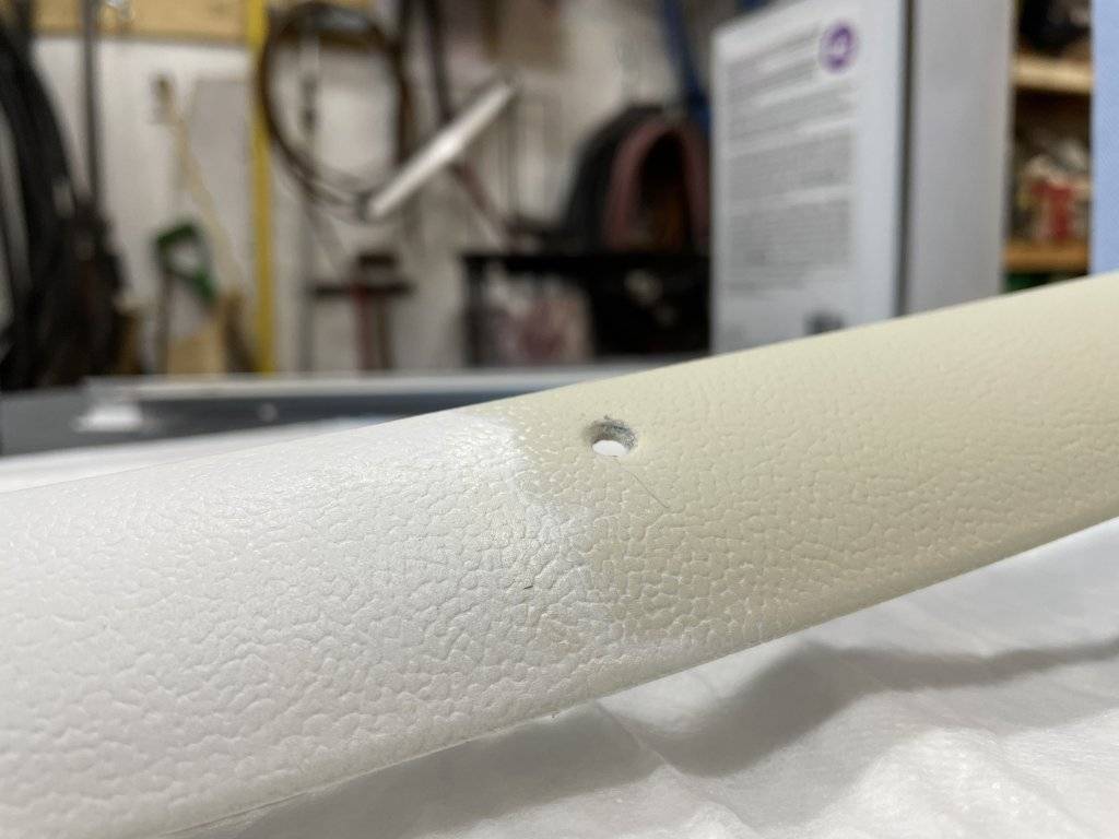

Thanks on the tips. I tried the brake fluid and other items being very careful not to damage any trim parts. It is hard enough getting parts for an Imperial, no need to add more parts to the list. I was very fearful of the Acetone, tested on the back side of trim, worked well and quick. But if not careful it will ruin your plastic trim, like I said earlier the C pillar trim is very different then the A pillar trim. The upper sides and windshield are metal, the Acetone did not upset original factory paint at all.Try denatured alcohol. I've used it to remove old paint from interiors.
Or you could soak the plastic pieces in brake fluid. Undiluted Purple Power or Castrol Superclean also works.
Acetone will destroy most plastic.

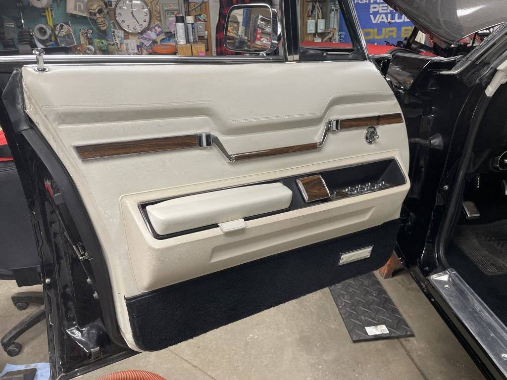

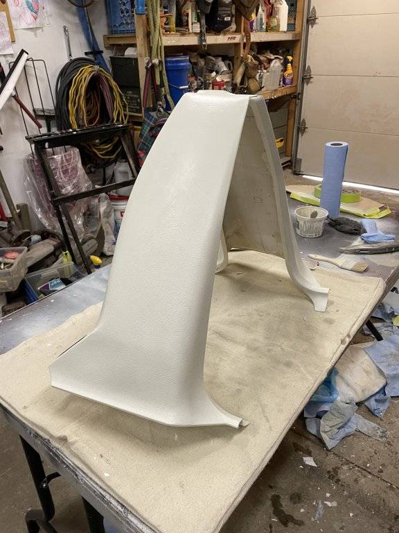

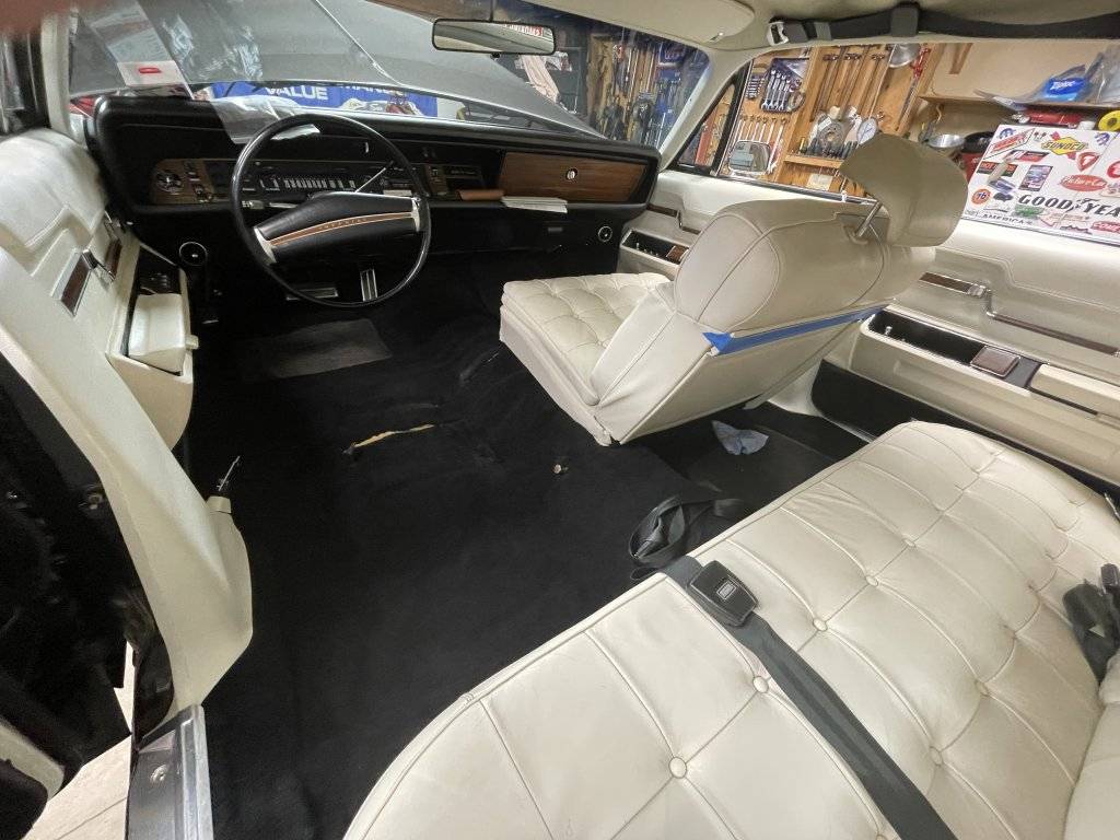

All Right. Coming together on the interior front.
Much disassembly, stripping and prep, I think the interior is looking pretty pretty good.
Hi Boyd,The motor assembly is original, that is the overall condition of car.

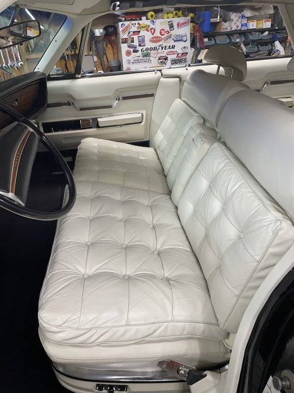

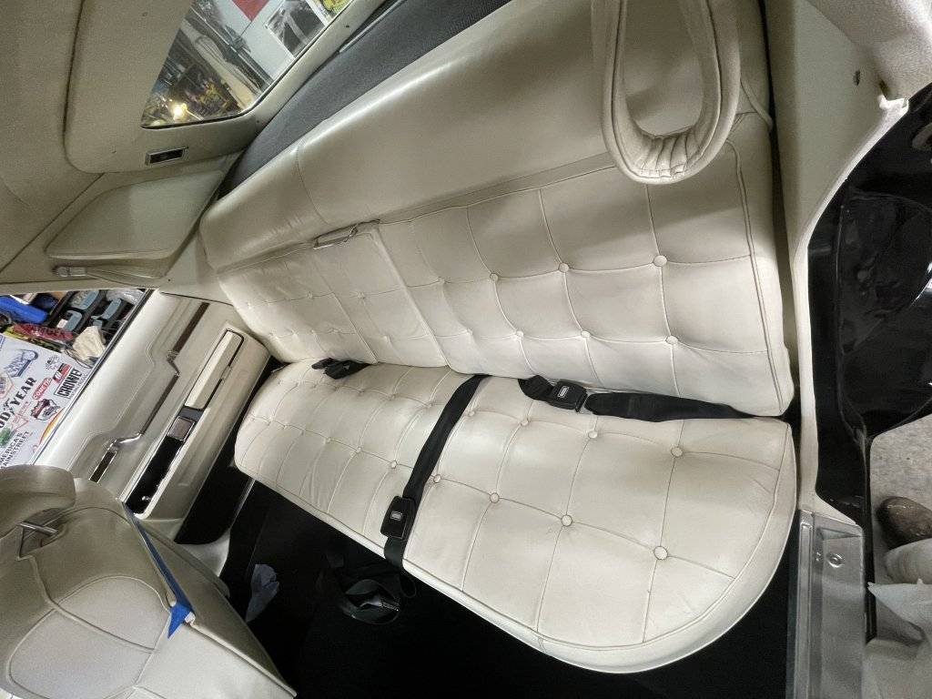

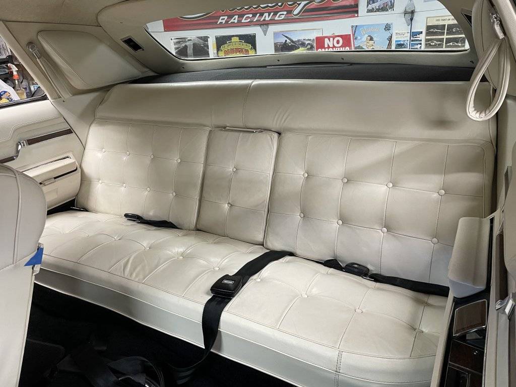

I went with the SEM super white Color Coat. I only sprayed the drivers seat. As I figured I can re strip that seat of the SEM if it fails, and when I find a supplier of the correct colour leather dye.
The feel not much firmer then the unpainted seats, and is flexible.
I only spray the pillow top, shoulder top and head rest. I masked the sides. My hopes were to find a company that had a match to Super white and just order, but I get requests for a swatch of material for matching. With two week turn around for a sample the the shipping of actual product, I decided to give the SEM a shot.
