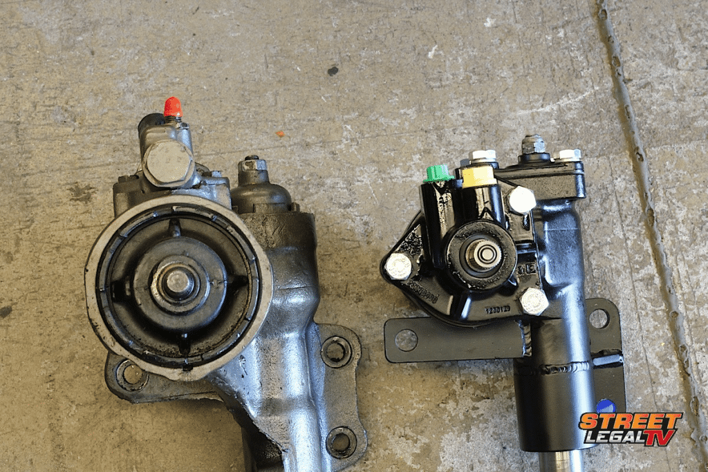

Is that what commonly called the "Saginaw" box?
The same one that is custom modified and supplied by Borgsen?
The same one that you might have to cut your column shaft and use an adapter because the wormgear shaft on the box is too long?
No. the Borgesen is a different steering box.
The box in your picture (on the left) is the original-style box (not sure if that has a name, is it known as just the "Chrysler" box?
Neither one (in your picture) is what is offered for sale on rock (for $90 CAD, no core charge) but ok so it's not the Borgsen unit.

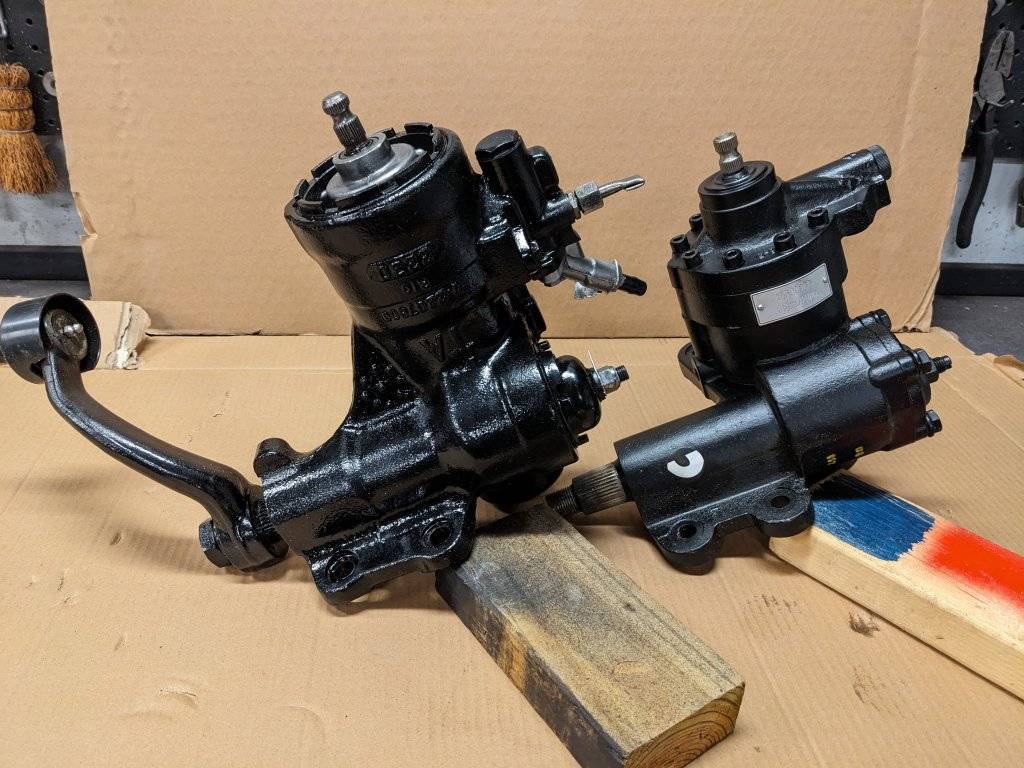

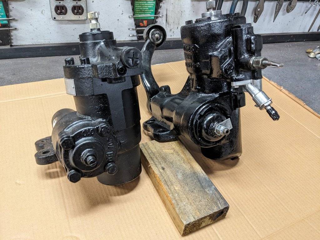

Following are two images showing the unit next to my original T/A steering gear with its fast ratio pitman arm from one of my T/A Challengers.

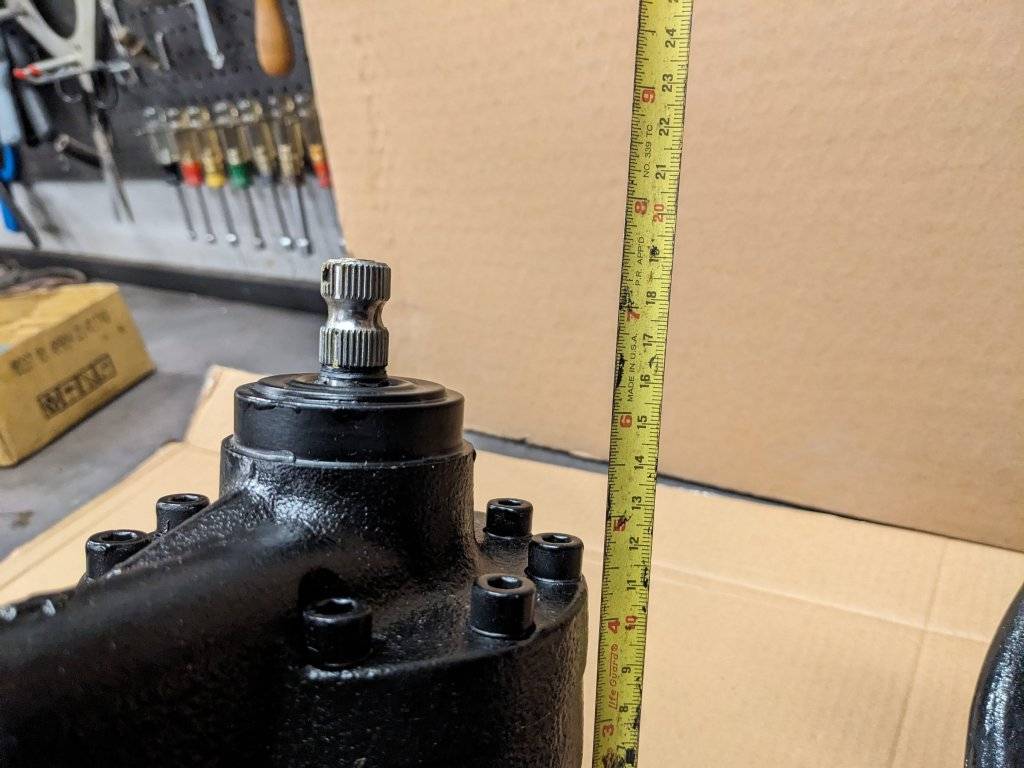

The output shaft is 1.25" and shows signs of heat treating. The input shaft does have a master spline. The unit is filled with power steering fluid. It is physically smaller overall. Roughly measured, the mounting holes placement appears correct. However, the height of the input shaft placement it lower than the original steering gear. A quick tape measurement from a mounting hole to level of the input shaft is about 1" difference in the column to shaft mounting to insert the roll pin. There is not enough play in the factory coupler to accommodate one inch, although some are longer than others. Extending the collapsible inner shaft on 1970-later applications might make up the difference. A swapped longer inner shaft or extending the original shaft with a welded sleeve would work. For cars with the additional rubber coupler, an extension could be made there. A direct input shaft splined extension might be available. Note that it would be different from the Chrysler power steering to manual steering adapter/extension. The Bergman Auto Craft Direct-Fit Steering Box Coupler might work.

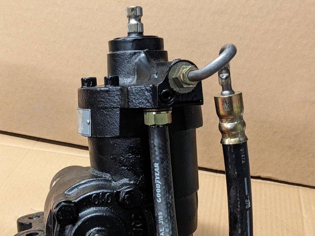

The return fitting extends straight, like some late model steering gears, instead of angled, and is for a 3/8" hose as used with 1968 and later. The pressure hose fitting is intended for the 1975 and later style, but the earlier style fitting can be swapped. However, the threads from mine were too long and bottomed out. A thicker or an added copper sealing ring could correct it. The included fitting did not have a sealing ring for it, but should have a copper sealing ring or similar.
